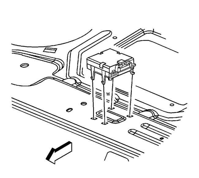

Where is the RKE receiver (part number 15042969) located at on this car?
Nov 13, 2020 at 5:41 AM
  • 110,240 POSTS
See pic 1 for the location.

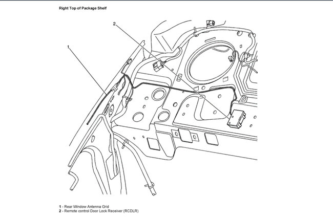

Here are the directions for removal and replacement. The attached pics correlate with the directions.
_____________________________________
2005 Pontiac Grand Prix V6-3.8L VIN 2
Removal and Replacement
Vehicle Accessories and Optional Equipment Antitheft and Alarm Systems Keyless Entry Keyless Entry Receiver Service and Repair Removal and Replacement
REMOVAL AND REPLACEMENT
REMOTE CONTROL DOOR LOCK RECEIVER REPLACEMENT
REMOVAL PROCEDURE
pic 2
1. Remove the rear shelf trim panel.
2. Reposition the sound barrier for access.
3. Disengage the receiver retainers.
4. Disconnect the electrical connector.
5. Remove the receiver.

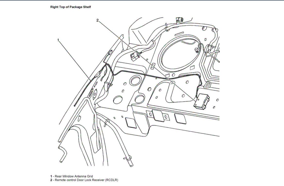

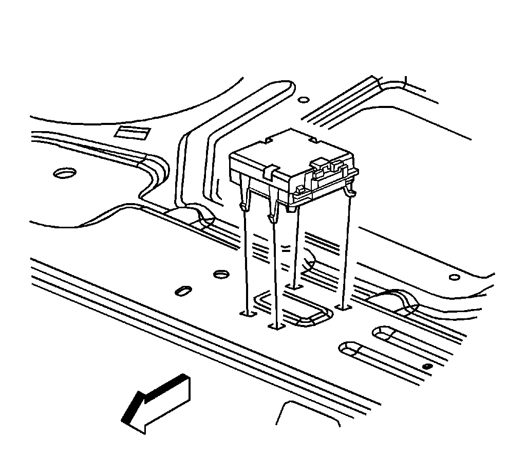

INSTALLATION PROCEDURE
pic 3
1. Connect the electrical connector.
2. Align the receiver retainer to the openings in the rear shelf. Install the receiver.
3. Install the sound barrier.
4. Install the rear shelf trim panel.
5. After replacement of the remote control door lock receiver, the transmitters will have to be programmed to the receiver. Refer to Transmitter Programming. See: Vehicle > Programming and Relearning
