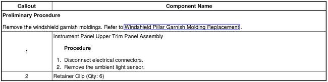

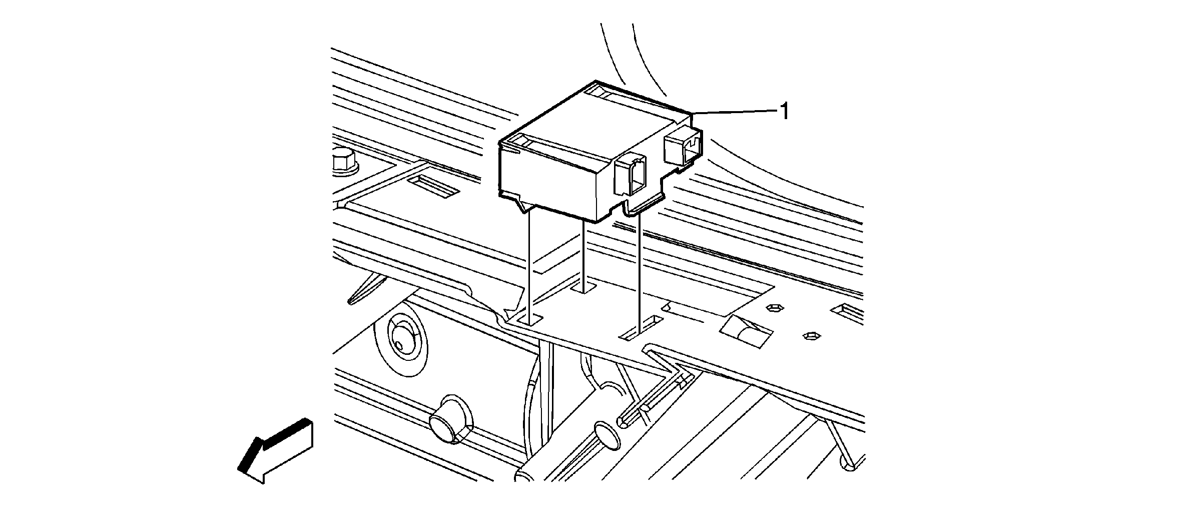

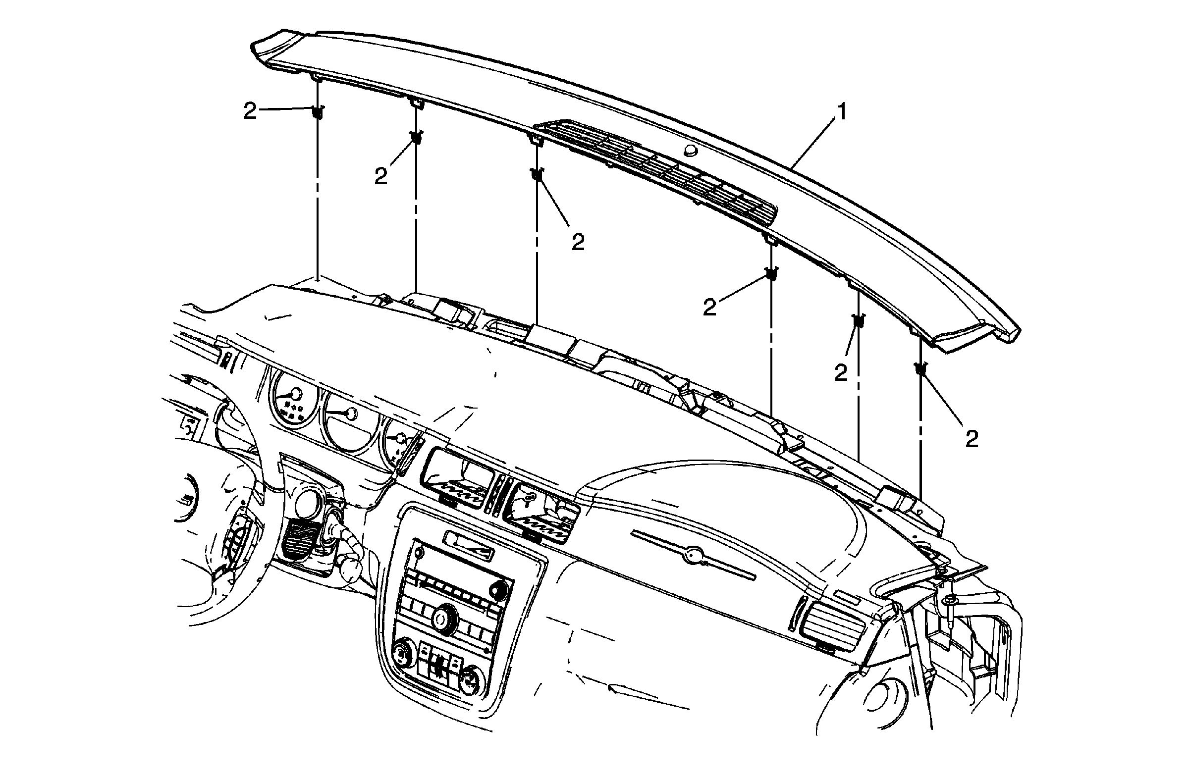

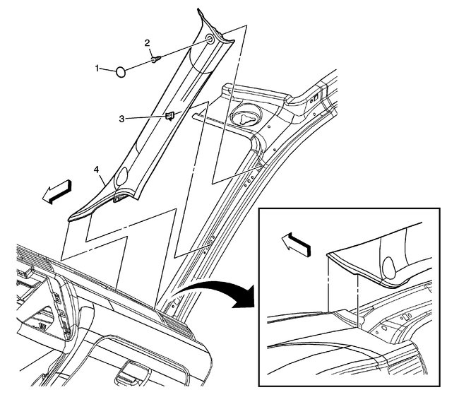

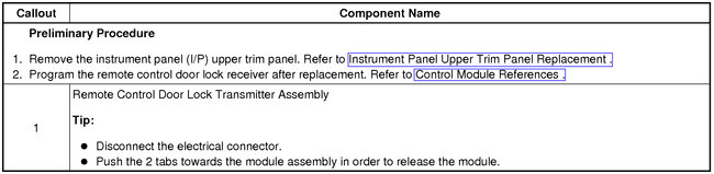

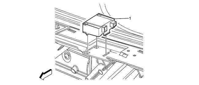

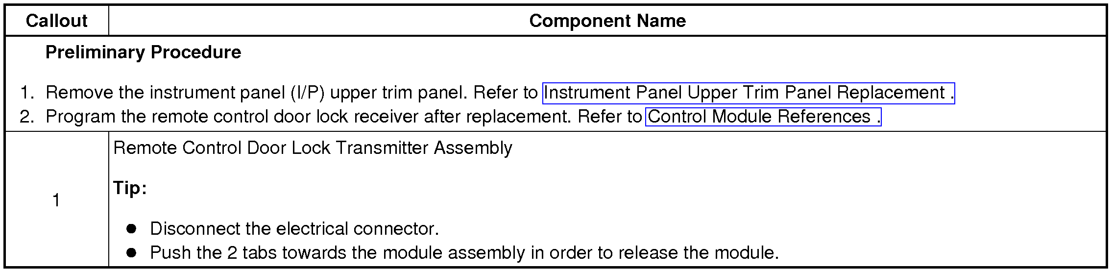

where is it located on my car listed above LT model?
Jul 31, 2019 at 7:46 AM
  • 110,244 POSTS
Welcome to 2CarPros.

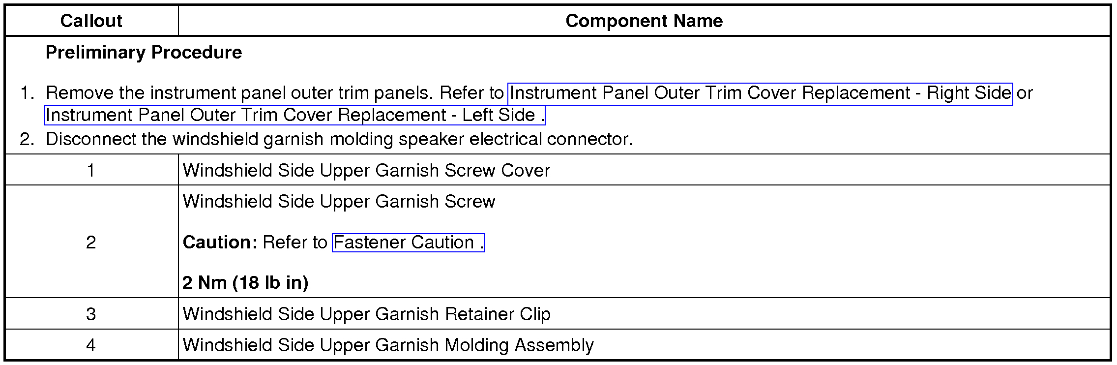

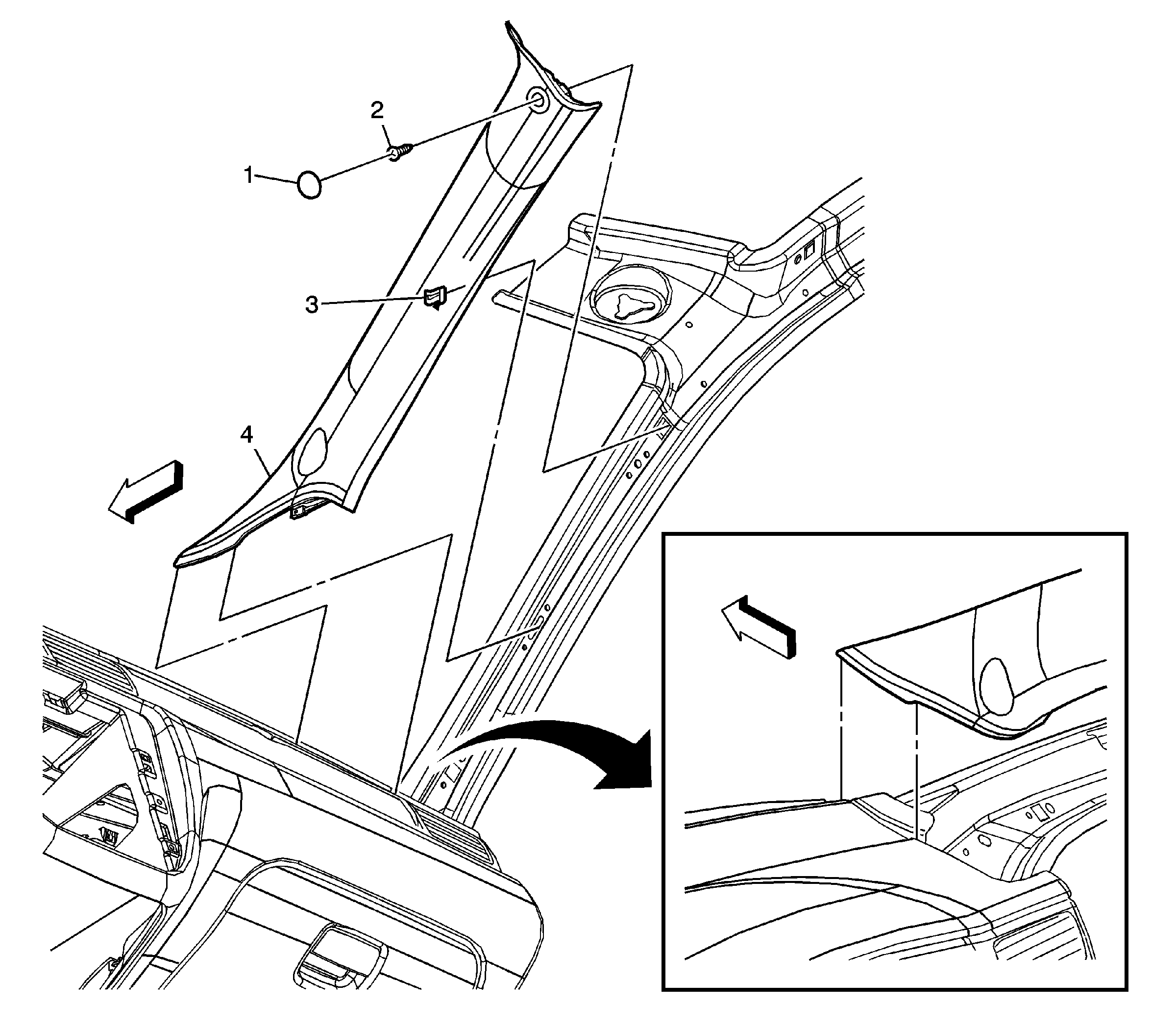

It is under the upper trim panel of the instrument panel. Here are the directions for panel removal. First you need to remove the pillar trim. See pictures 1 and 2. Next, you can remove the upper trim panel. See pics 3 and 4. Next you can access the module. See pics 5 and 6.
Let me know if this is what you needed.
