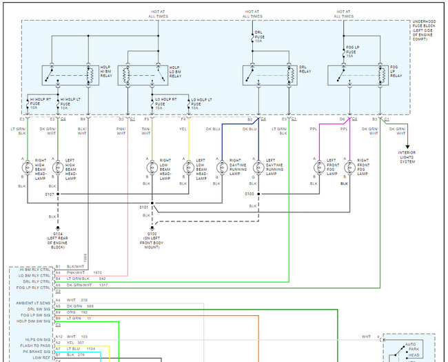

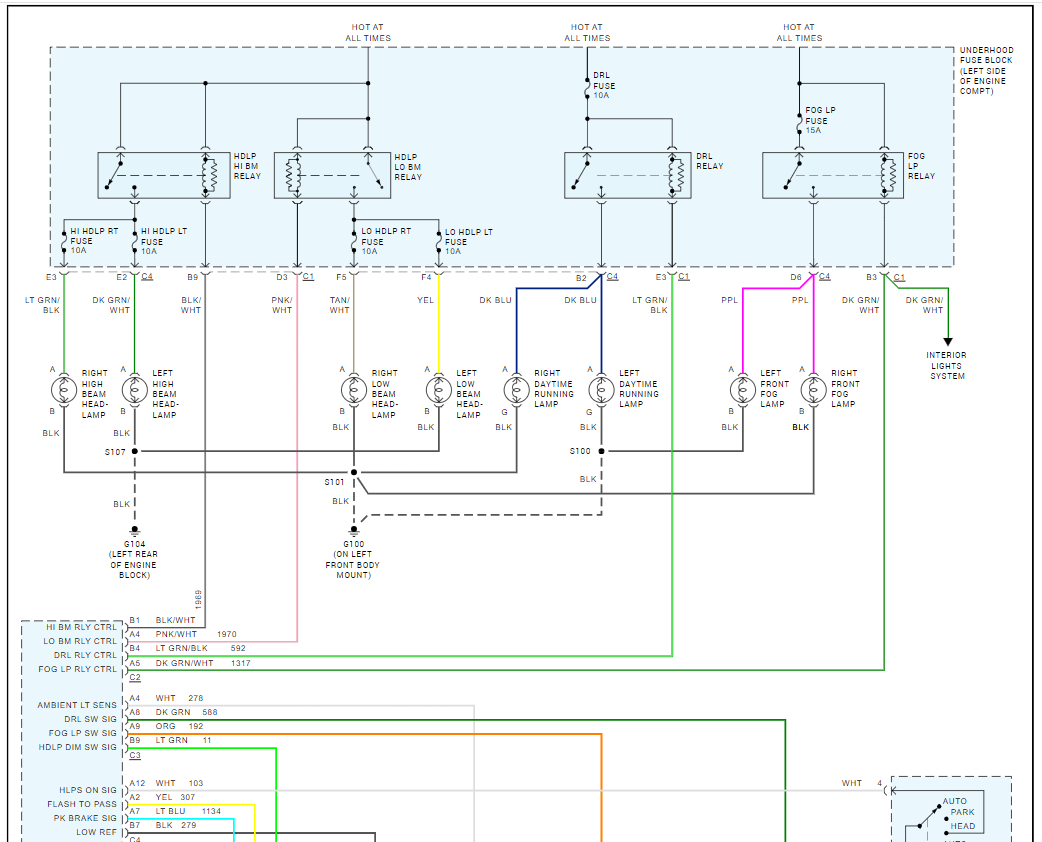

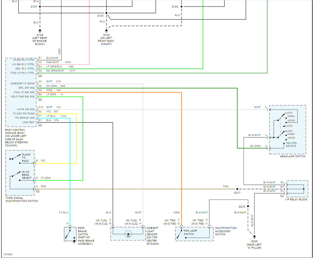

This must be a wiring issue because the blinkers do not intersect with headlights in the wiring diagrams. I would start at the front right headlight and blinker wiring to look for damage or wiring repairs that were not done correctly. Here is the headlight wiring so you can see what's going on.

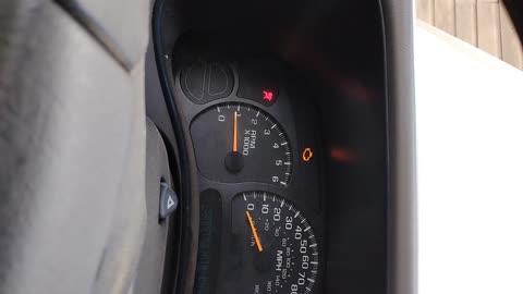

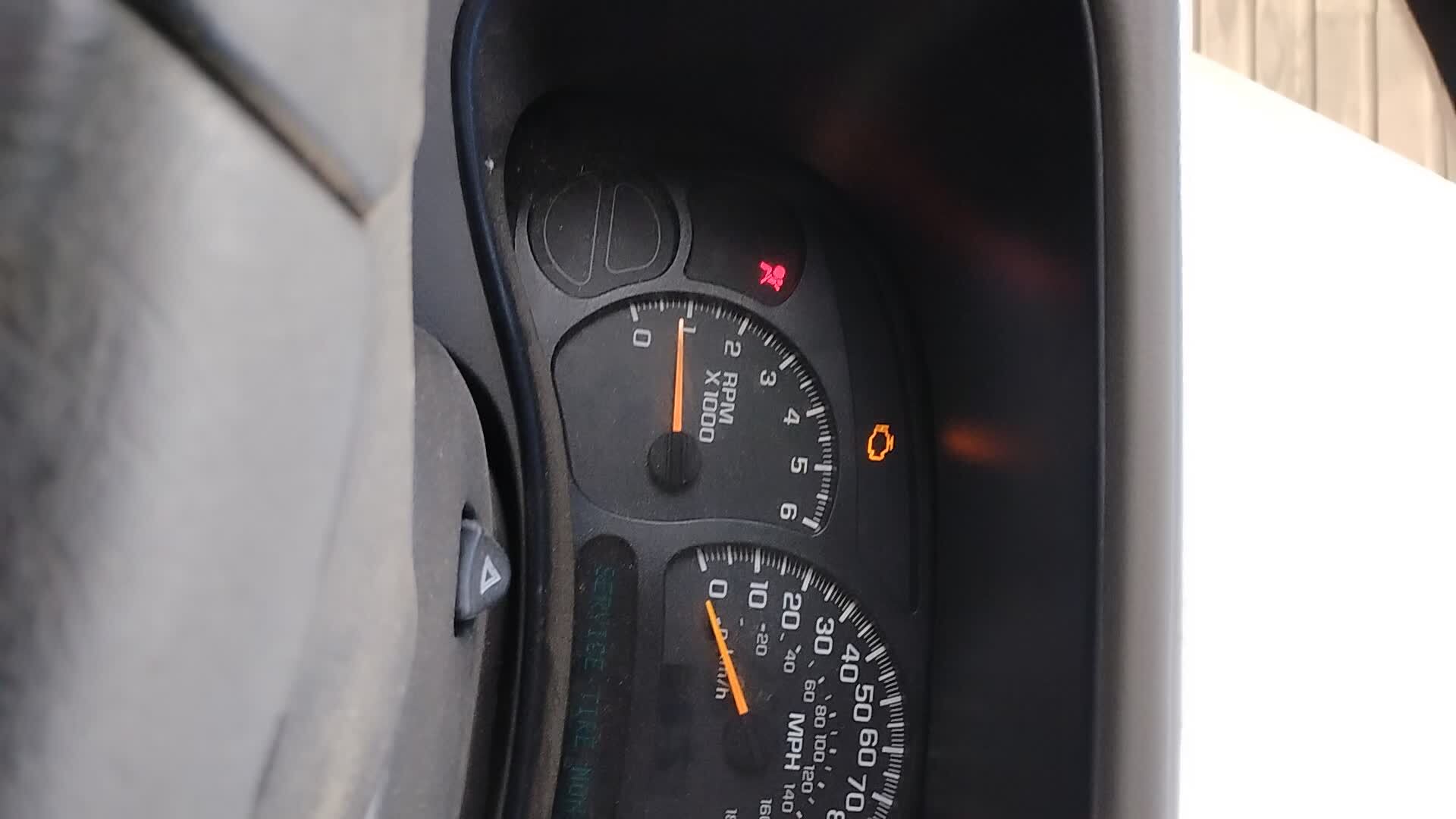

Hello Ken, well I attached a video to show you what is going on. I checked the headlights and the blinkers and there doesn't seem to be a short anywhere in there that I can find. So maybe with the video this will help out.
Oct 30, 2024 at 7:26 AM
  • 55,421 POSTS

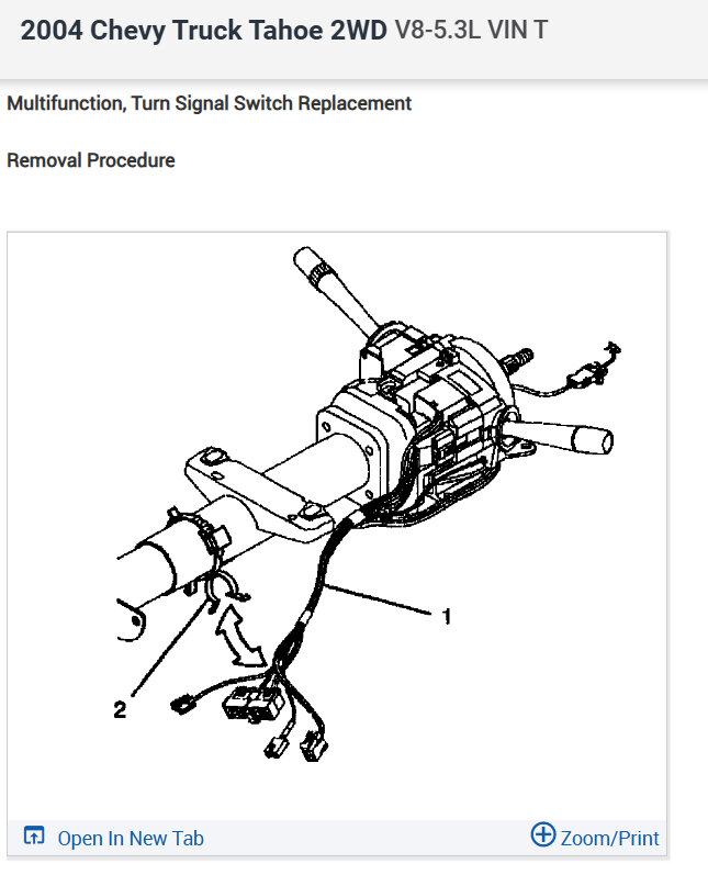

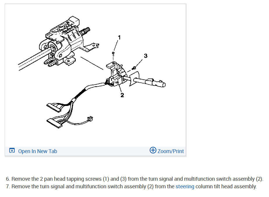

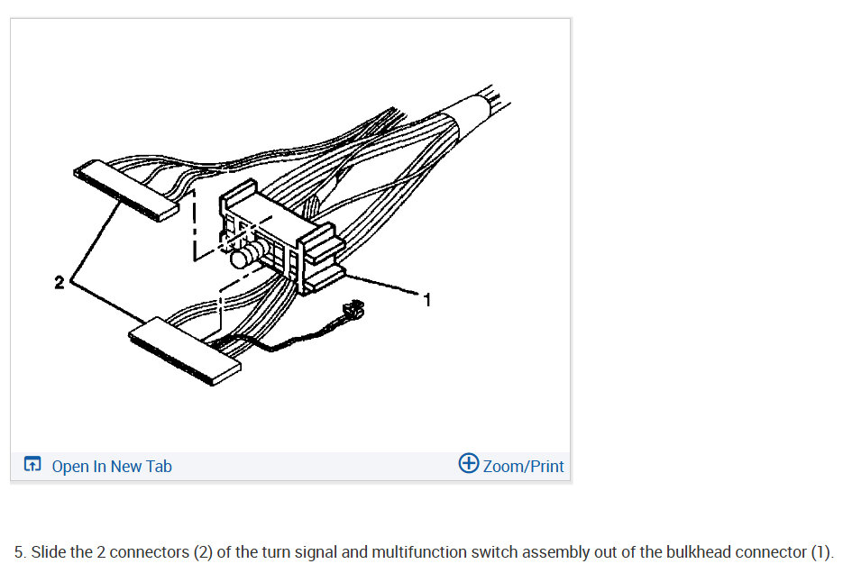

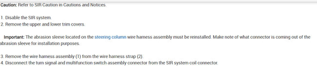

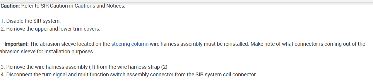

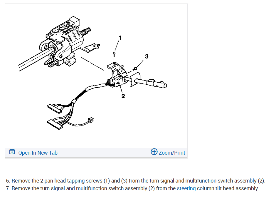

Perfect, thanks for the video, it looks like the shared connection is in the multi-function switch, here is how to change it out which should fix the problem. Check out the images (below). Please let us know what happens.
Oct 31, 2024 at 6:01 AM
RAGINGSOUL
  • 54 POSTS
Hey Ken, I just wanted to let you know that I purchased a new blinker switch and replaced it and that solved the problem. thank you very much as always you guys are awesome have a great day.
