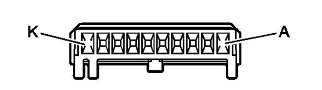

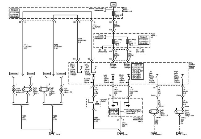

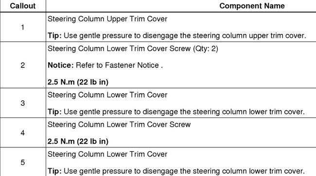

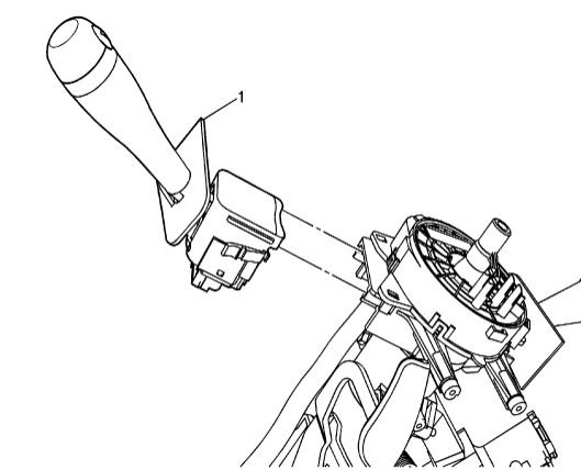

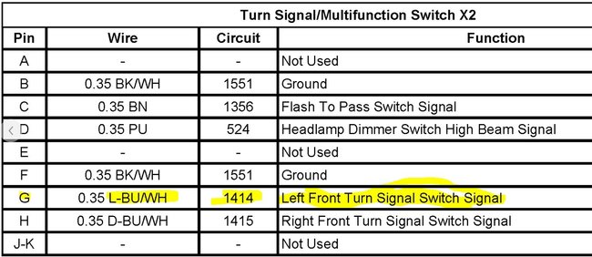

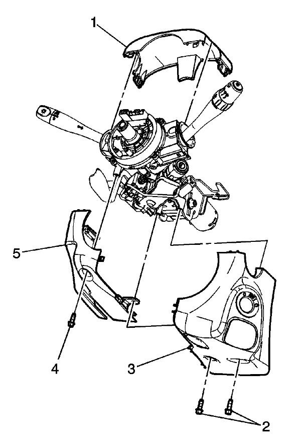

Okay, that points to either the switch or the body control module having a bad input from the switch. The easiest way to test it would be to remove the steering column covers and get to the wiring connector for the switch. The switch simply grounds either the left or right input to the body module. If you were to ground the input to the left turn signal (the light blue wire with white stripe) and they start working the issue is in the switch. If they don't work then the body module is the suspect part. The switch is a plug and play item, the body module isn't. It requires programming to work.
