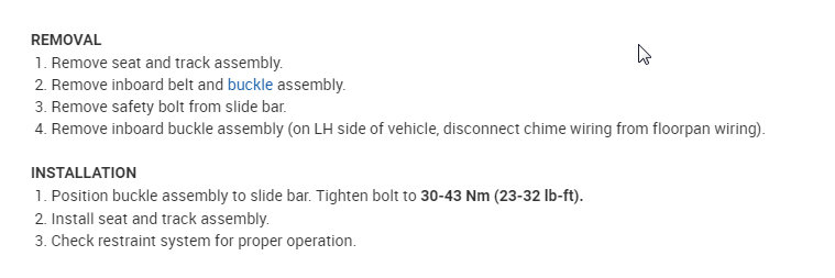

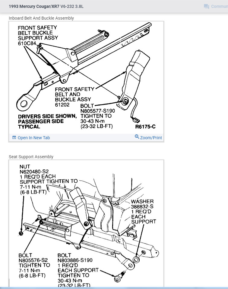

right side retractable shoulder belt receiver broken. I want to know if I can replace the receiver without replacing the whole track.
Apr 1, 2020 at 1:05 AM
Experienced Mechanic
18,907 POSTS
I attached the process for replacing the buckle only. You do need to remove the seat and track but the buckle does come off.
Let me know if you have questions with this process. Thanks
