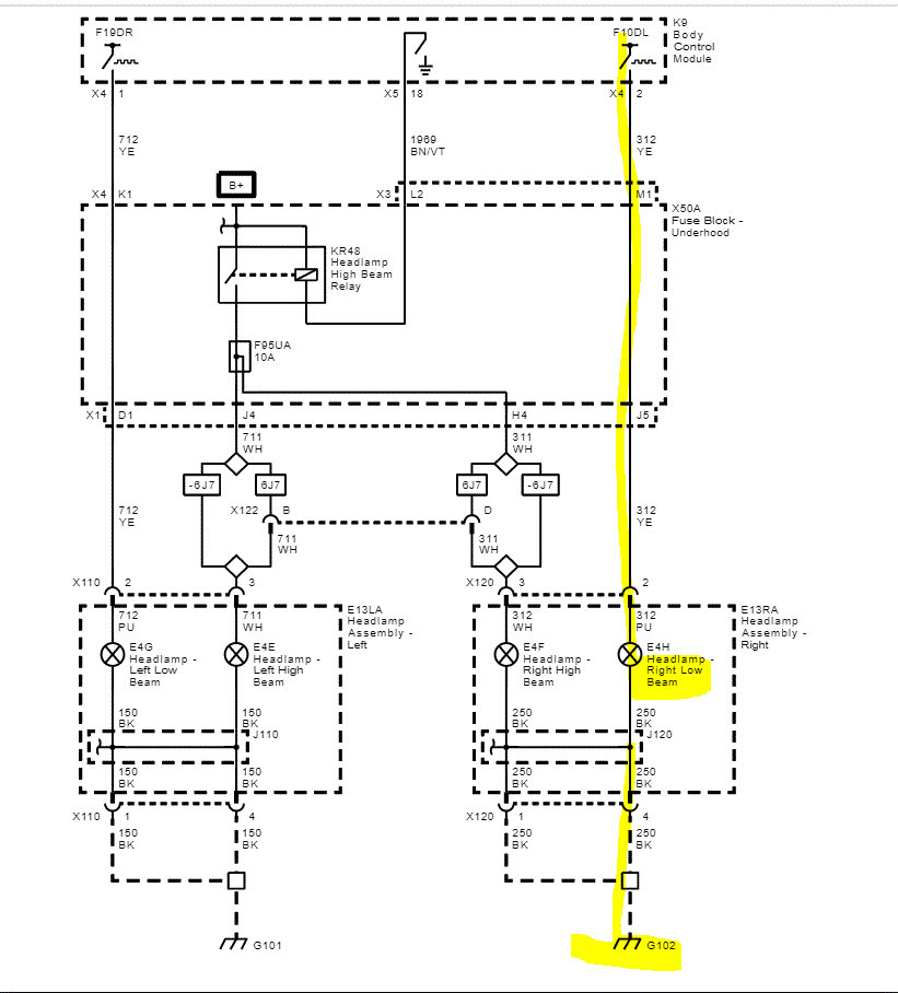

Right side low beam headlamp not working
2015 CHEVROLET TAHOE
60,000 MILES
BETAETA104
I've been reading the forum. Like others, my right side low beam lamp doesn't work. I purchased a new HID lamp first, assuming that was the issue. Nope. So, I checked the fuses. never realized that the headlamps had separate fuses - 20a. I swapped the left and right lamp fuse. Both fuses work the left lamp. So, new lamp and fuse works.. what's the next step? A BCM ? Thanks, Dan

On this new of a vehicle, I would like to think the BCM is still good. Have you tried scanning the CAN BUS system to see if there are any codes related? CAN stands for computer area network. All modules are tied together via a few wires.
Here is a video showing what I'm referring to:
https://youtu.be/InIlnsjOVFA
Also, have you checked to see if there is power to the light itself? There could be an issue with the socket. Also, conform there is continuity to ground from that light socket.
I attached a pic below showing what I am referring to. Check those things and let me know what you find.
