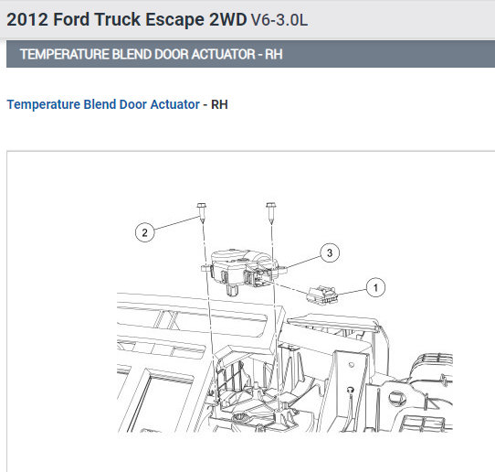

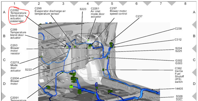

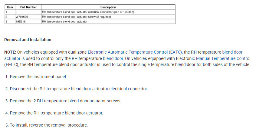

My vehicle (listed above) is blowing hot air out of the passenger side vents when running air conditioner. It is a dual control system and from my investigation it points to the right side door blend actuator, but I am having some trouble finding it. Some info says it is behind the glove box, but when i release glove box I do not see it anywhere. Can you help? Any photos or diagrams? Thank you.
Jun 2, 2021 at 3:39 AM
DANNY L
  • 5,648 POSTS
Hello, I'm Danny.
Here is the information you requested. Here is a tutorial showing how to replace a blend door actuator which is similar:
I've attached picture steps below showing the location and how to replace the right hand temperature blend door actuator on your vehicle. Hope this helps and thanks for using 2CarPros.
