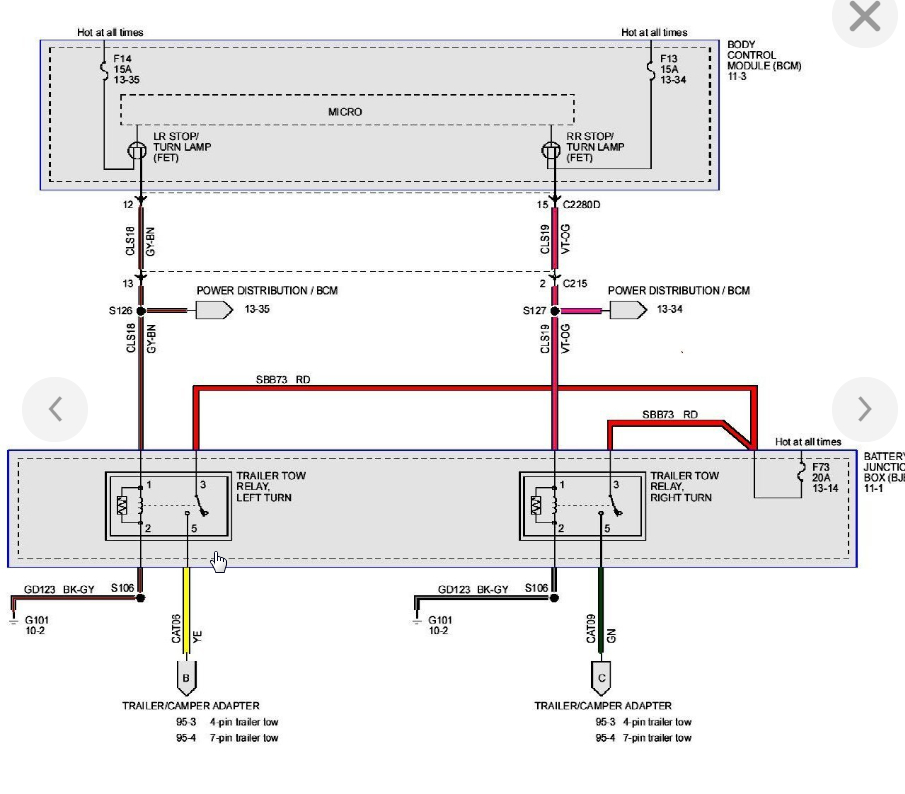

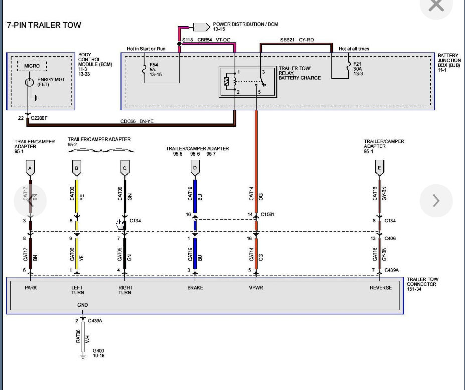

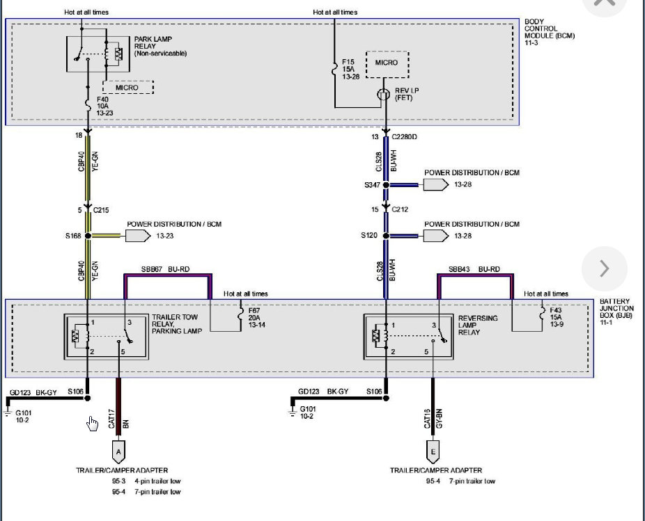

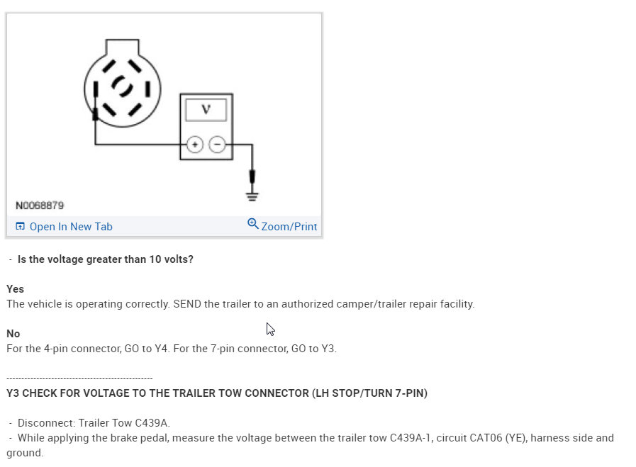

I have the truck listed above with the towing package.
The truck turn lights all work. There's no power for the right turn at 7 pin receptacle. The tail, and left turn lights are okay. I have the checked the TT right turn relay and is okay.
Wiring diagrams for TT lights would be very helpful.
thanks for help,
Gayle
Jun 28, 2019 at 10:37 AM

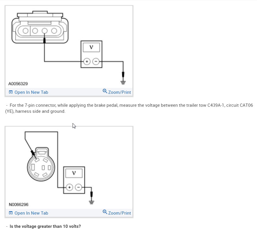

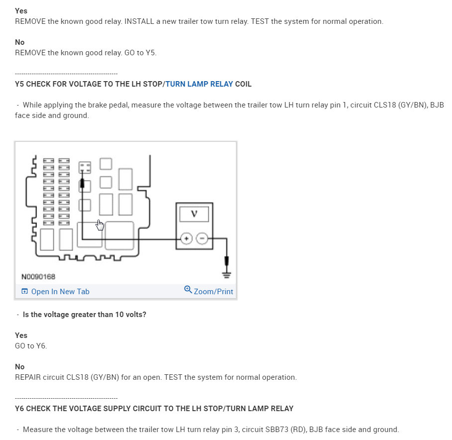

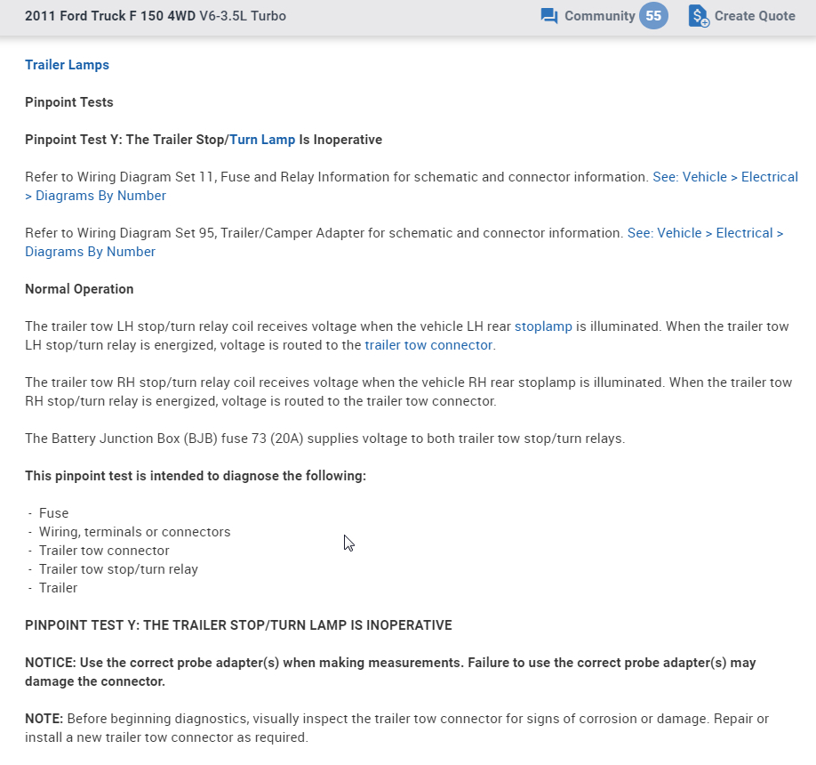

Hi Gayle,

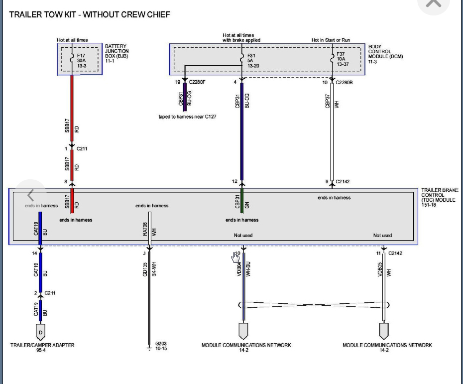

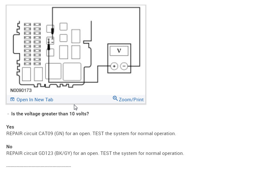

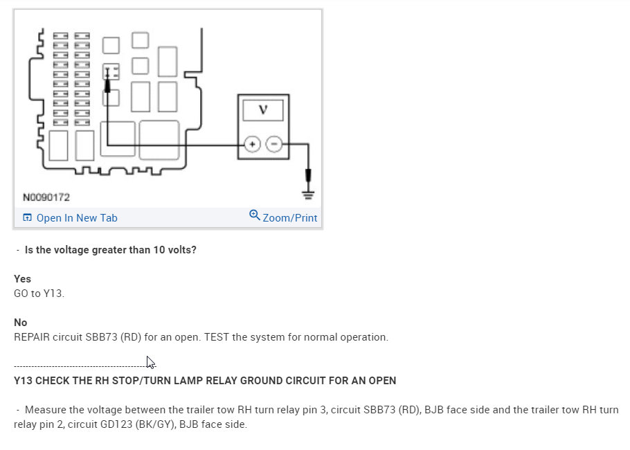

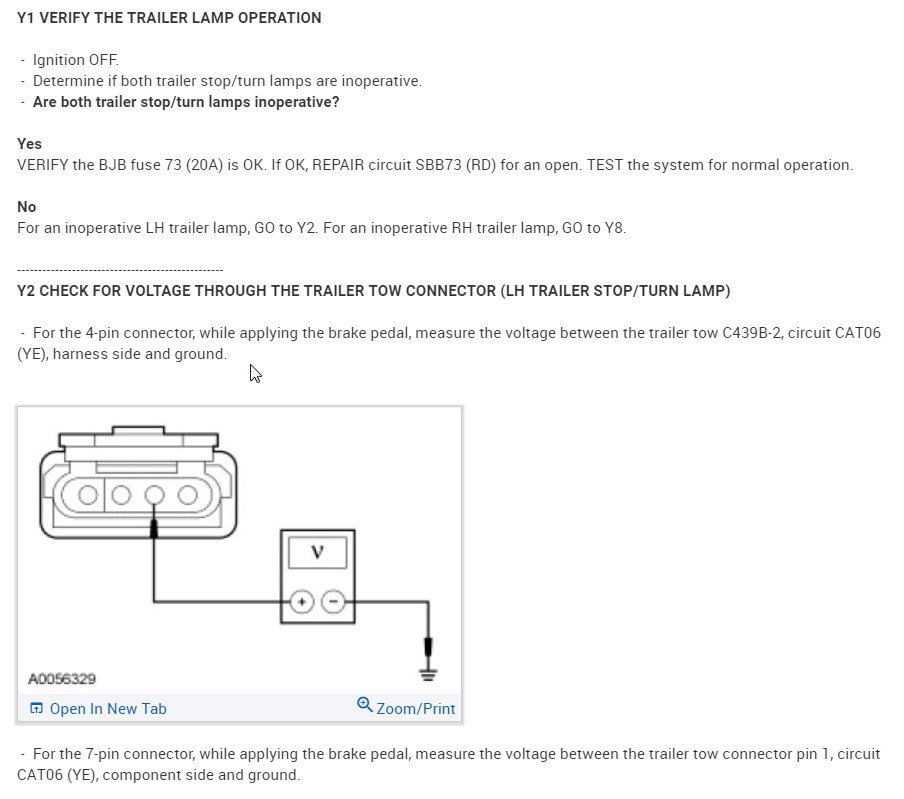

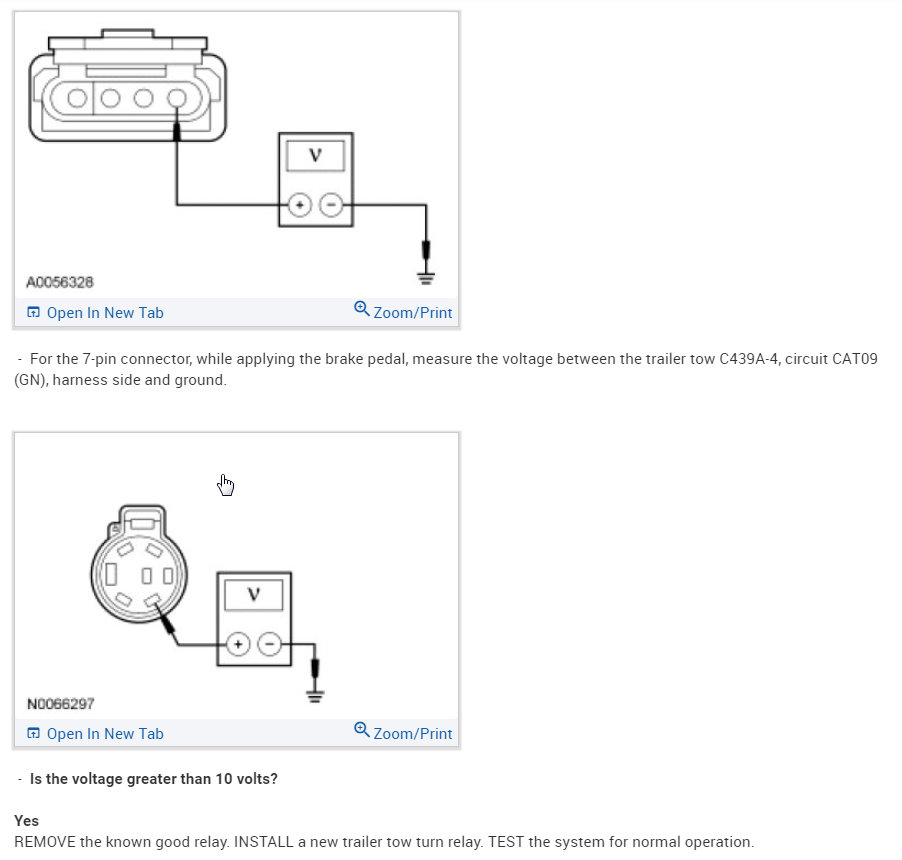

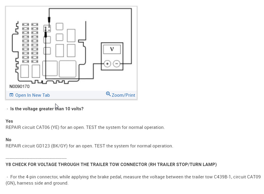

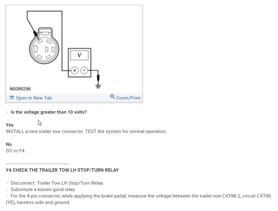

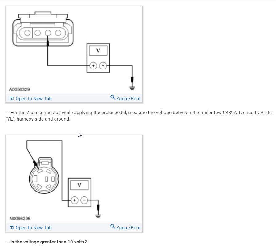

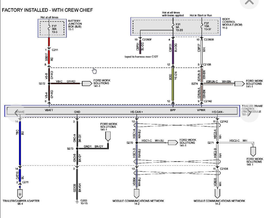

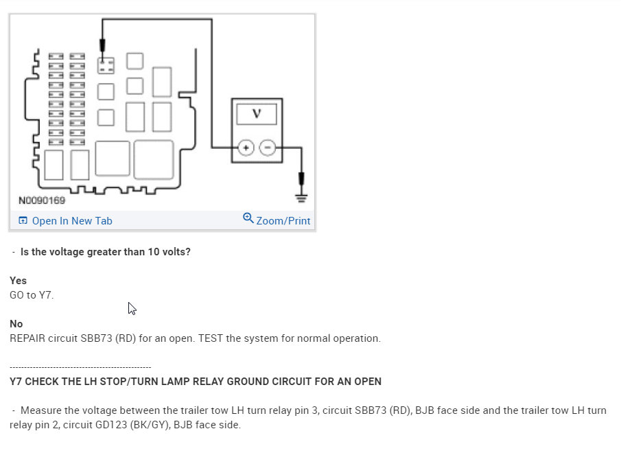

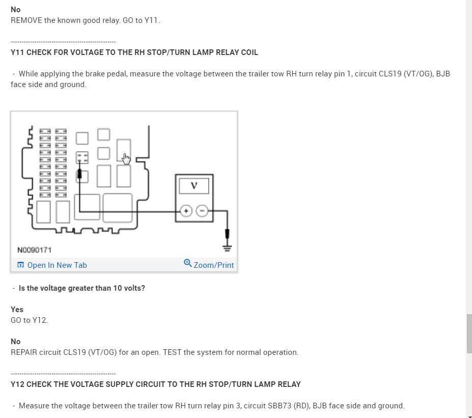

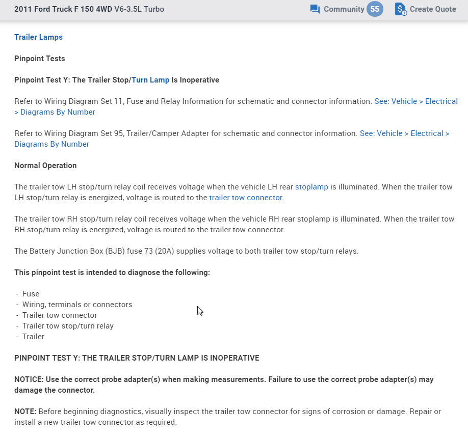

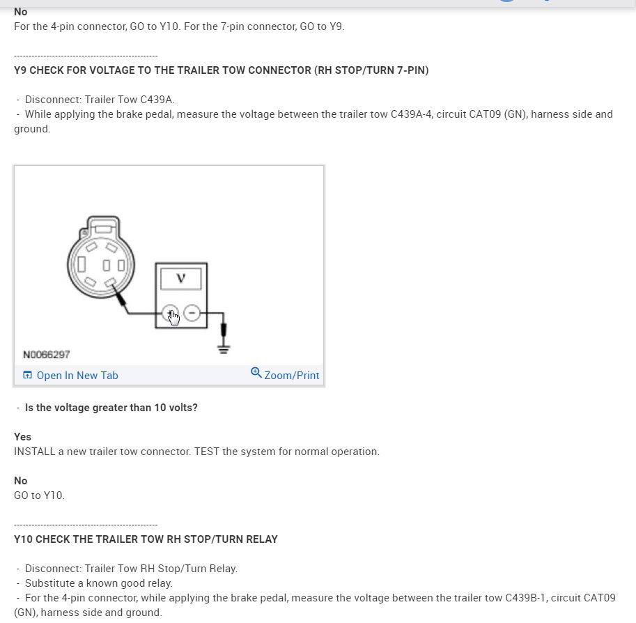

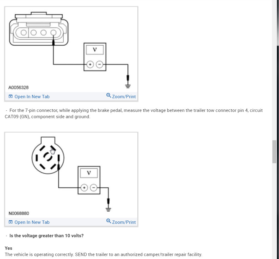

Here is the pinpoint test for figuring out turn/stop lamp issues with a trailer tow. If you don't have power at the 7 pin then I suspect you have a wiring issue but this will take you through all of that.

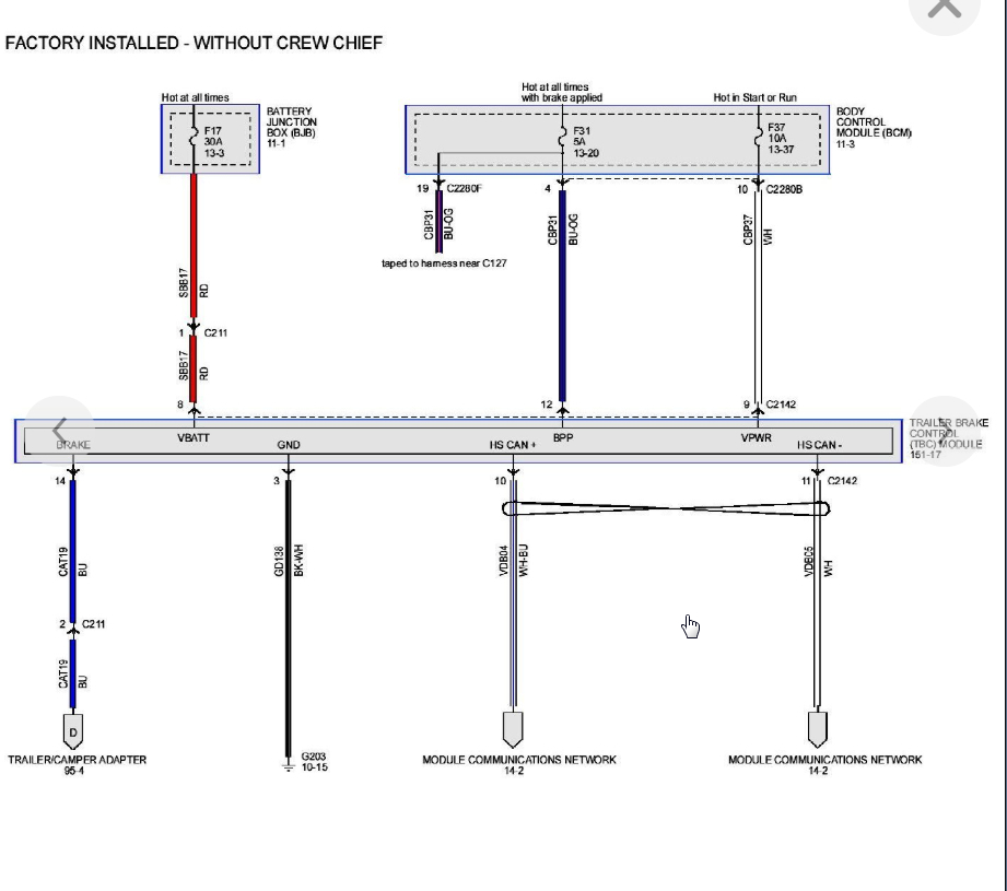

I also included the wiring diagrams. However, please pay attention to the heading to determine if it reflects how your truck is equipped. I suspect you won't need the diagrams because the pinpoint test will walk you through the circuits you need to test.
Let me know if you need more info. Thanks
