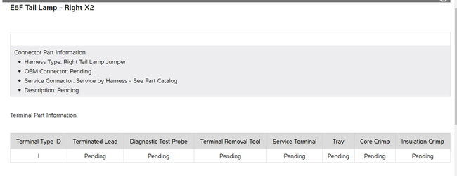

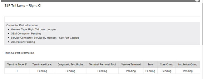

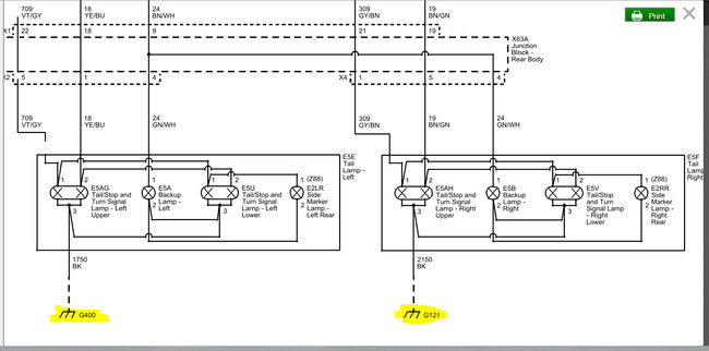

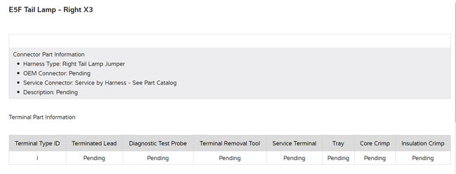

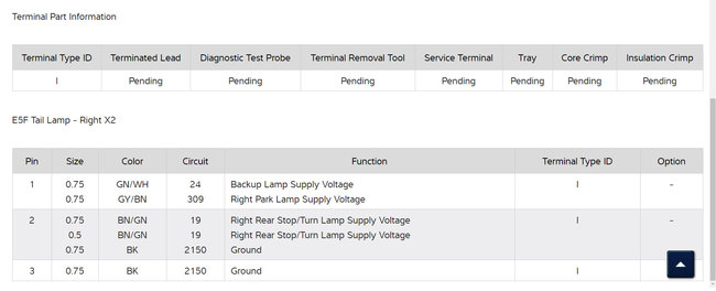

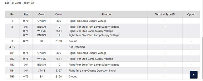

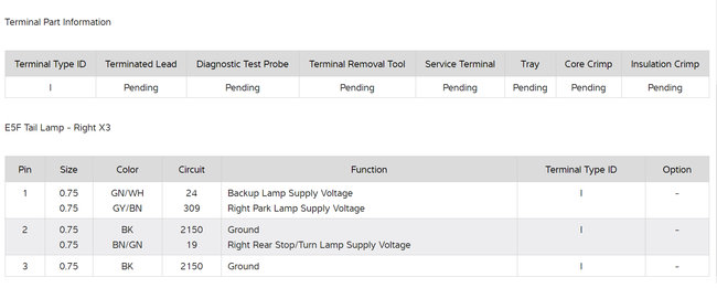

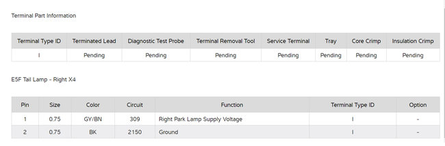

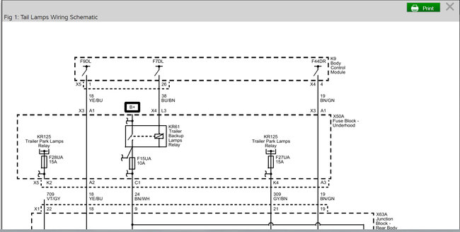

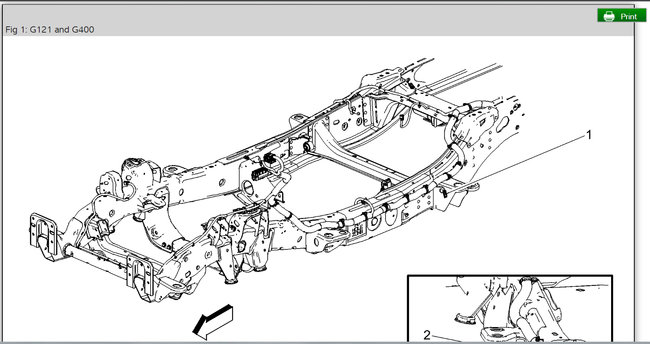

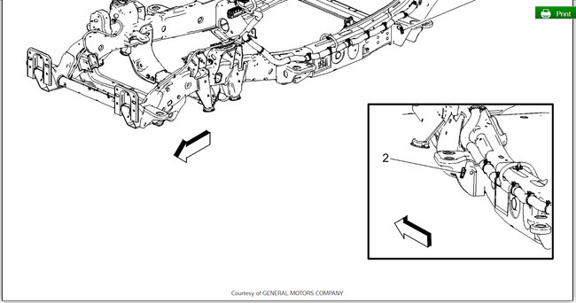

This sounds like you could have a bad connector or a bad ground from the bulb. I have included a couple of links for you to go to down below.
https://www.2carpros.com/articles/turn-signals-not-working-blinker
https://www.2carpros.com/articles/turn-signals-blink-rapidly
I have also included ground and connector information for you in the diagrams down below. Please go through all this information and get back to us with what you find out.
