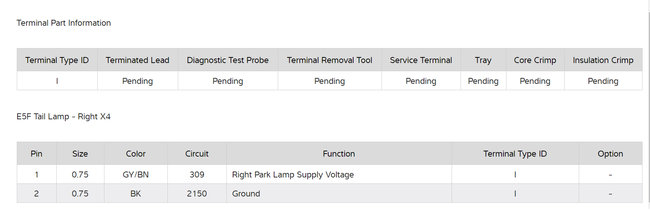

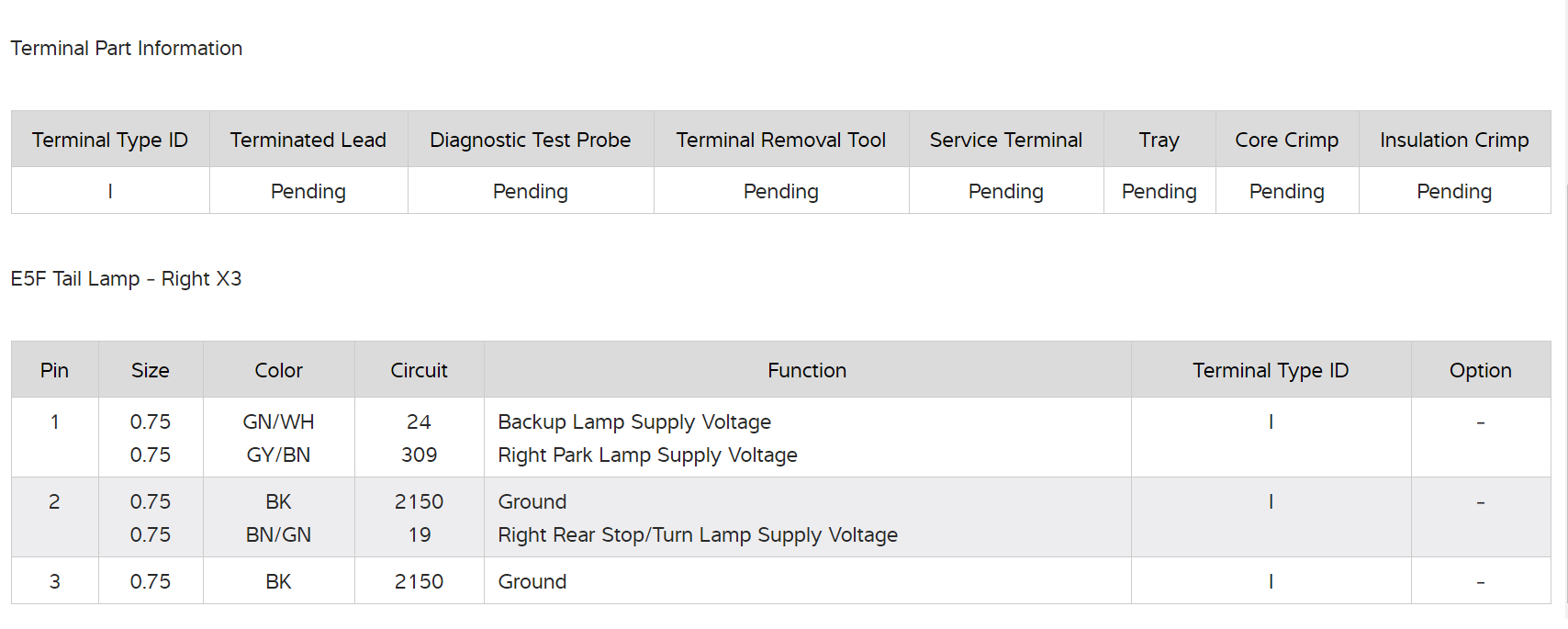

Right turn signal will blink normal three to four times then will begin blinking fast (as if one of the bulbs were out), and a message pops up on my dash display saying that the right rear turn indicator failed. This happens more often than not; meaning there are a few times where the right turn signal will work properly. There have been a few times that I was at a stop when this problem has happened and got out to check if any of the bulbs were not working, but all them were each time. I finally switched out the turn signal bulb in the right rear lens to see if perhaps it was a defective bulb, but the problem still exists. I've had the truck for about two years now and this just started a couple of months ago. Not sure what changed or what my next troubleshooting step would be. Any help would be appreciated.
Mar 21, 2019 at 1:16 AM
SCGRANTURISMO
  • 4,897 POSTS

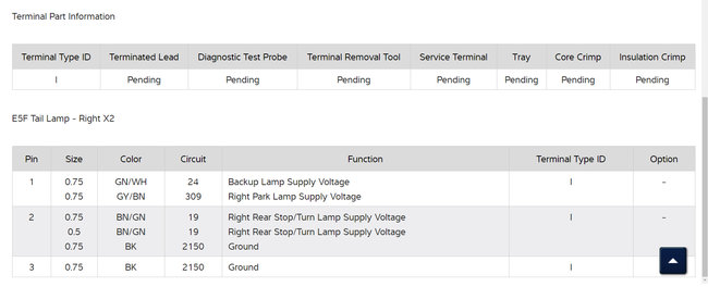

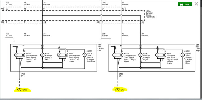

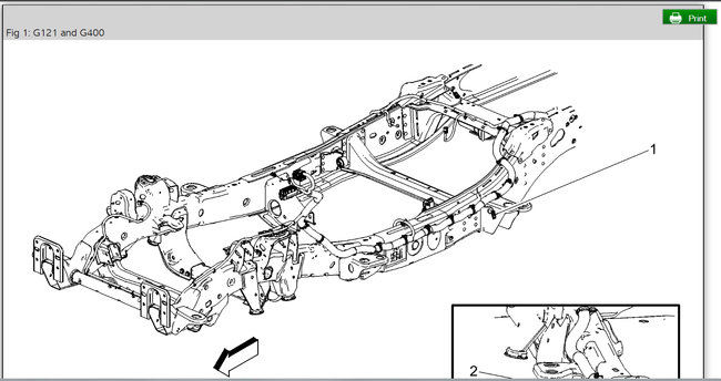

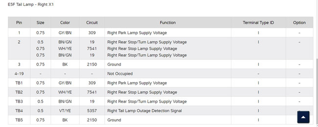

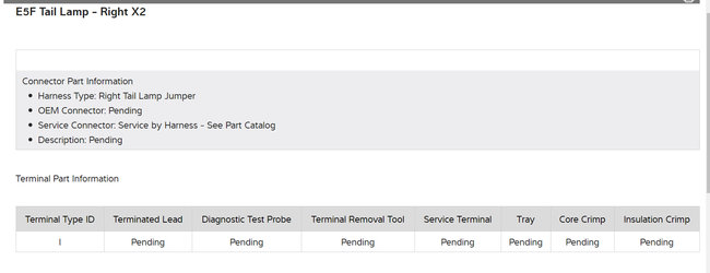

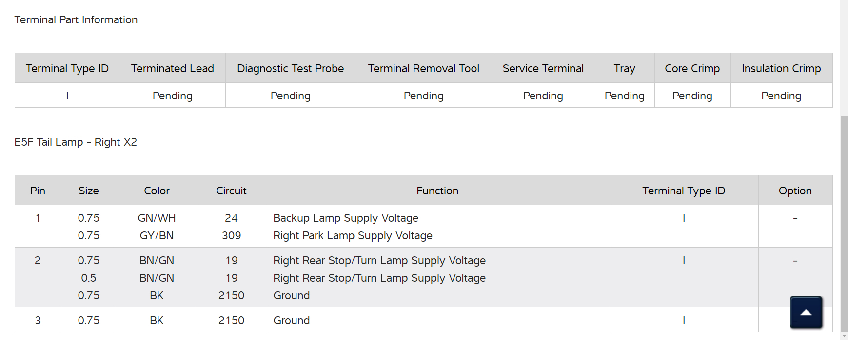

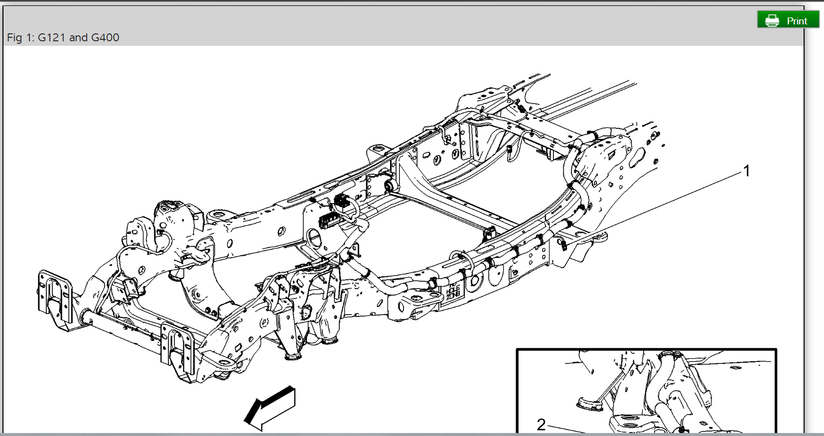

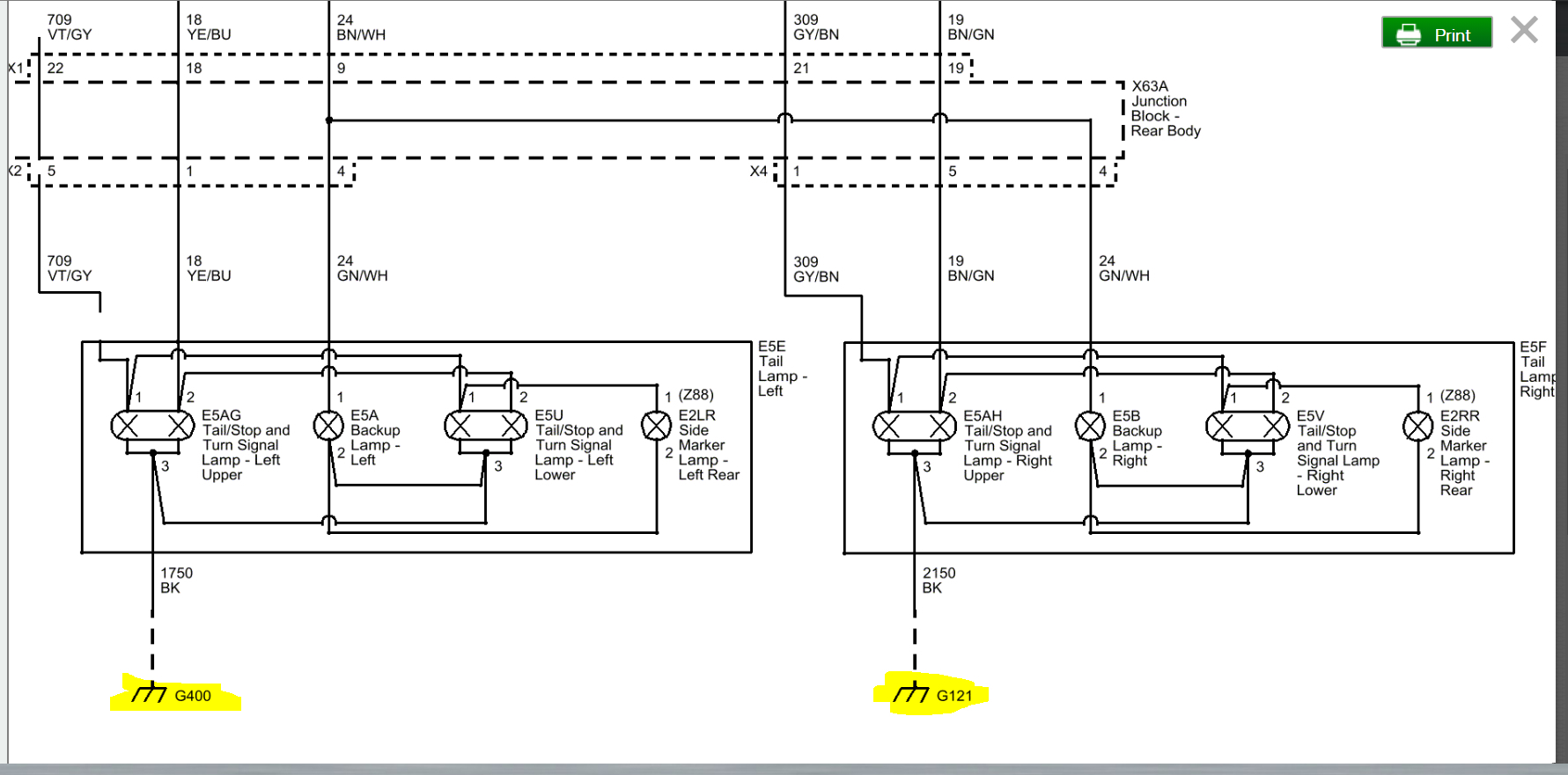

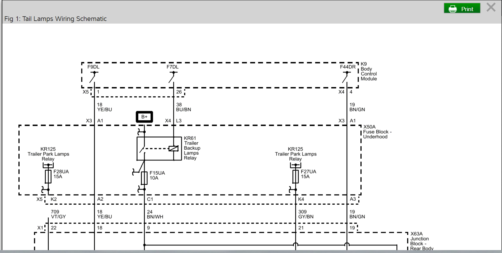

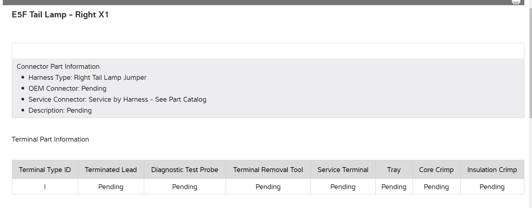

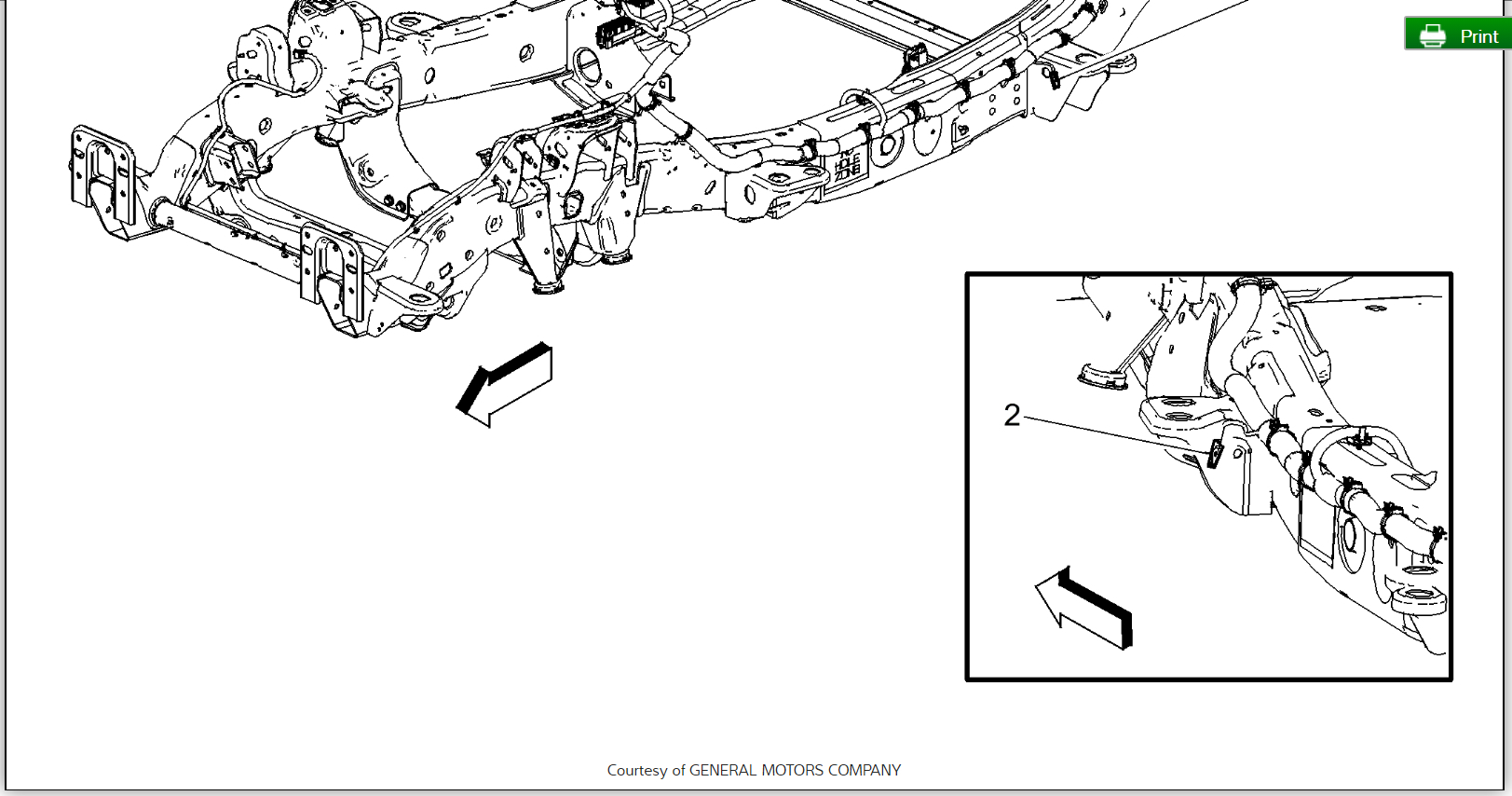

This sounds like you could have a bad connector or a bad ground from the bulb. I have included a couple of links for you to go to down below.
https://www.2carpros.com/articles/turn-signals-not-working-blinker
https://www.2carpros.com/articles/turn-signals-blink-rapidly
I have also included ground and connector information for you in the diagrams down below. Please go through all this information and get back to us with what you find out.
