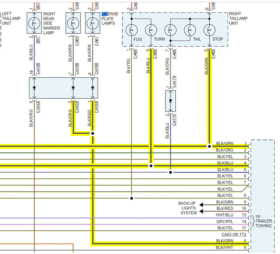

The brake light when stopping goes off , when I turn blinker on right upper turn signal and backup lights and license light and driver side blinked and back up light blinked. when operating drivers side taillight only works perfect.

Based on your description, the first thing I would check is the wiring at the rear electronic control module. That is the one thing that ties the lights you mentioned together.
If you look at the attached pic, I highlighted the wires which go to the module. Check to make sure none are crossed, shorted, or damaged in any way.
Also, I will need to know if you have a factory trailer tow package. There could also be a short in the wiring to the trailer module or the connector itself.
Let me know what you find.

There is no damages to wiring looks like new. I did remove the solenoids in trunk one at a time no change.
