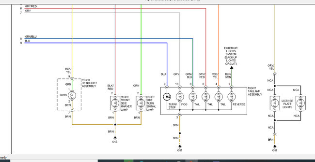

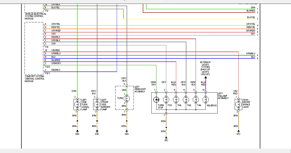

I need to know the colors and where to put them on connector for wiring harness.

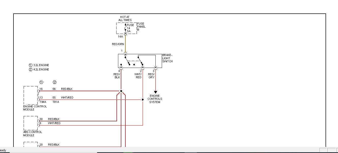

hello,

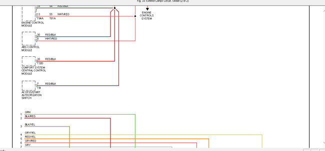

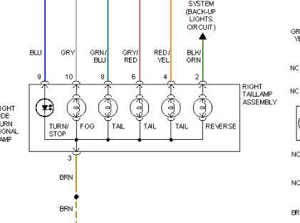

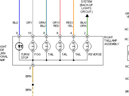

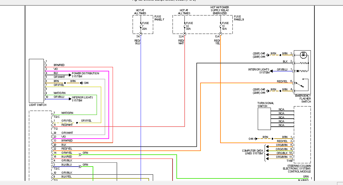

To get a clear view i cut the diagram in 3 sections of the right tail light, check the attached pictures below.
diagrams 1,2,3 for the right side tail light.
diagrams 4,5, for the left side tail light.
let us know if you need more help.
thank you.

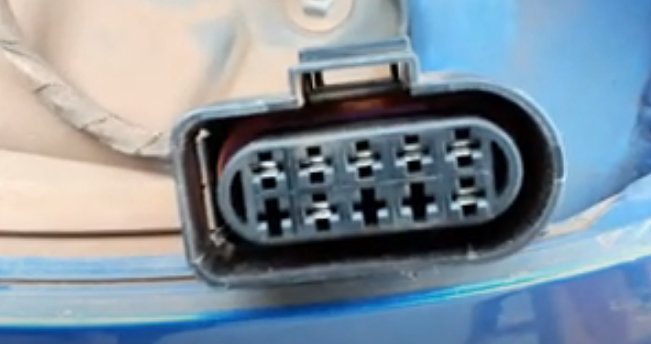

Not this, i need a pinout. i need to know what pins goes to what wire.

hello,
You can use the wiring diagram to get the wires pin out with the colors, tail light connector is numbered at the pins position.
1.empty
2.black/green
3.brown
4.red/yellow.
5.empty.
6.gray/red
7.empty
8.green/blue
9.blue
10.gray
hope these helps, let us know if you need more help.
thank you.
