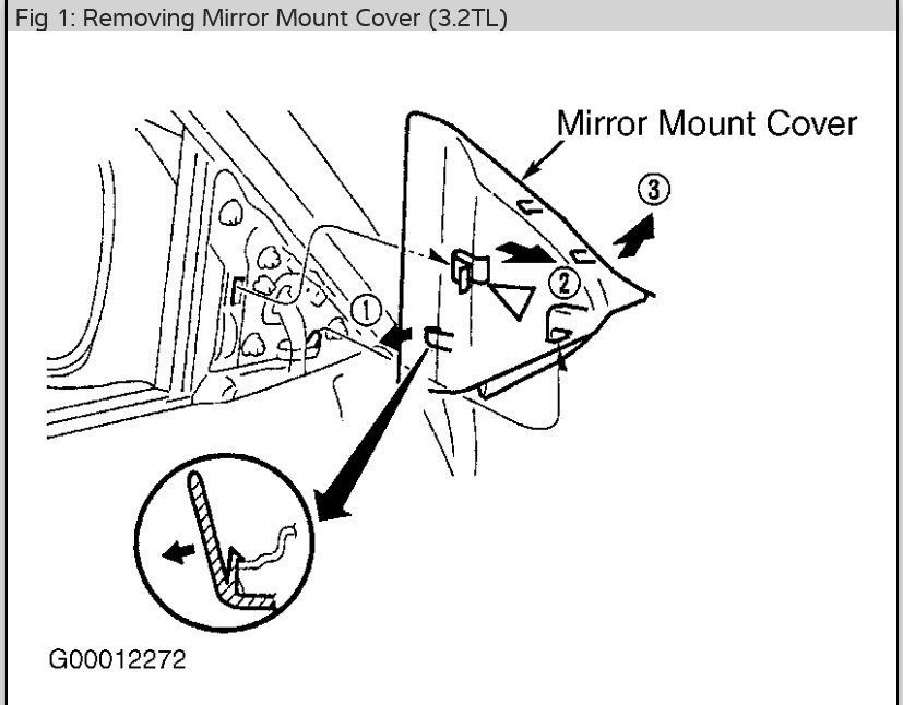

the right side passenger door will not open at all. I do not know if the lock is jammed or the door handle is stuck or the safety lock is messed up. I need to know what can I do to get the door open to find out what is the problem?

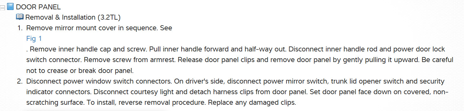

you need to take the door panel off then see if a clip broke which is probably what happened. See pictures, but it will not be easy due to seats etc.
