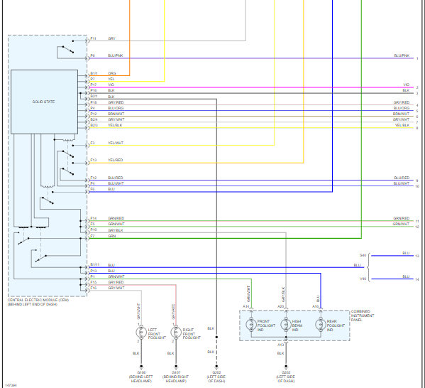

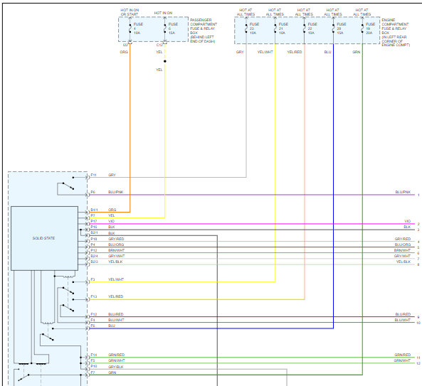

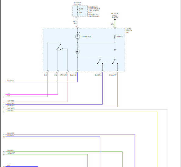

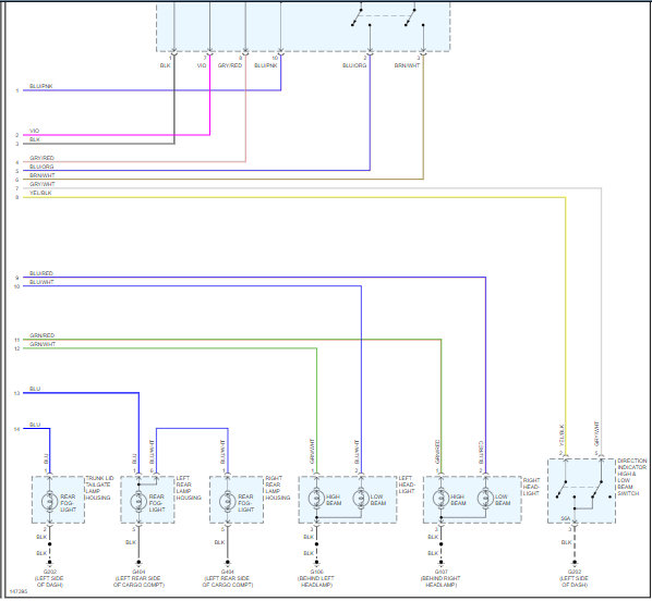

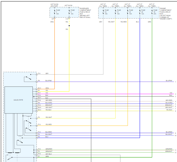

Fuse okay, bulb okay. Getting no power to green wire. Left is okay. Was intermittent now doesn't work at all. need a good wiring diagram with a component locator and any help would be awesome.

Here is the headlight wiring diagram you requested. I've cut the pictures in half so you can view larger and attached them below. Let me know if you have any further questions on this issue. Hope this helps and thanks for using 2CarPros.
