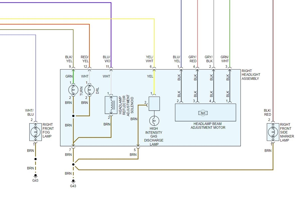

Looking at the schematics for that light, do the turn signal and DRL lights work? If those are out as well then I would test the Brown wire that provides the ground for the entire lamp assembly. If however those lights are working then I suspect you have a failed control module, it's located behind the glove box. If you remove the glove box and look up and behind the opening you can see the control module.

The vehicle electronic control module (ECM) supplies power to the lamps. There is one fuse that powers it and both right and left lamps get power through it. If the left side works and the turn and DRL are on then the module has power. That leaves the yellow with white wire as the power for the light from the control module. You can test that with a test lamp to see if it has power. If it doesn't it could be the wire failed between it and the module or the module itself. You could trace that back and check the connector on the module itself. They don't show much in the service information about testing beyond that.

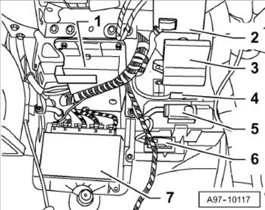

Could you show me exactly what the ECM looks like? There are about 4 different modules under there and I'm not sure which one it is.
Mar 31, 2020 at 4:10 PM

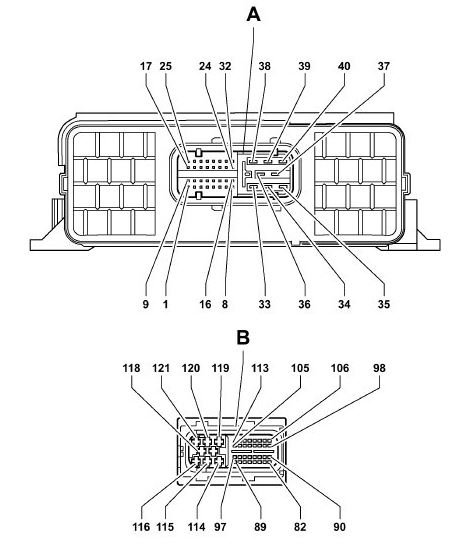

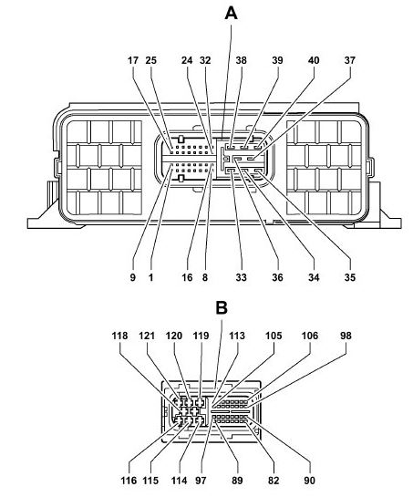

STEVE W.
  • 15,350 POSTS
It is module 5 in that image. It's connector is the second image.
