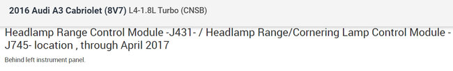

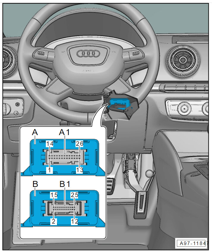

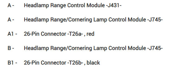

It sounds like you have a problem with the vehicle system electronic module at the left end of the dash. To be sure let's run a CAN scan. You can get a CAN scanner (Controller Area Network) which will work on most cars from Amazon.
https://youtu.be/u-4syLc-ifQ
Here is how to replace the vehicle system electronic module in case a code is stored for it. Check out the images (below). Please let us know what happens.

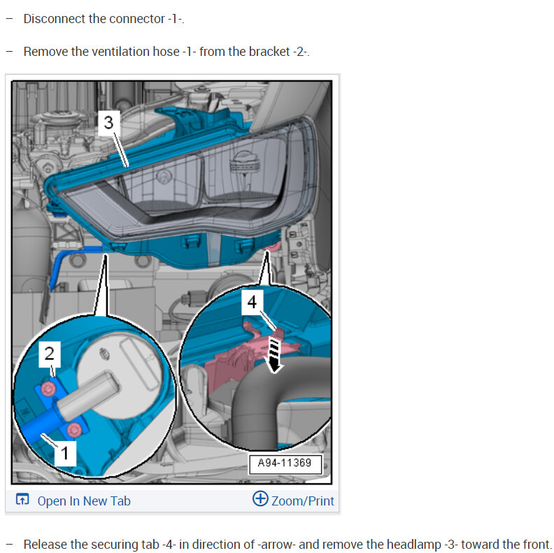

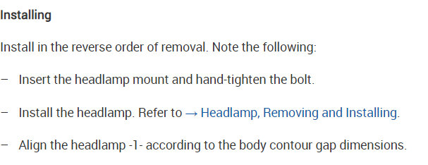

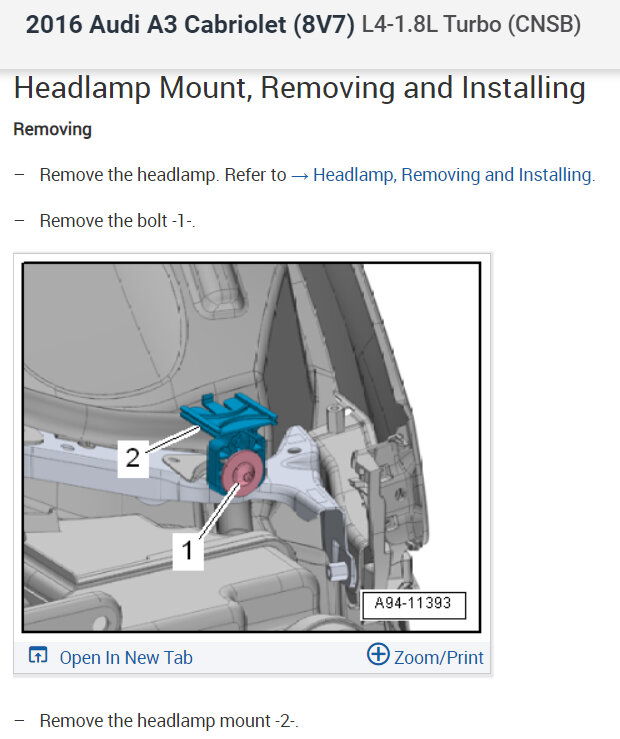

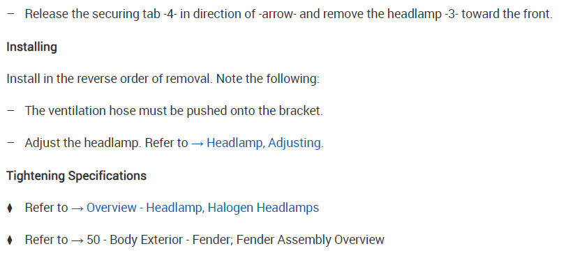

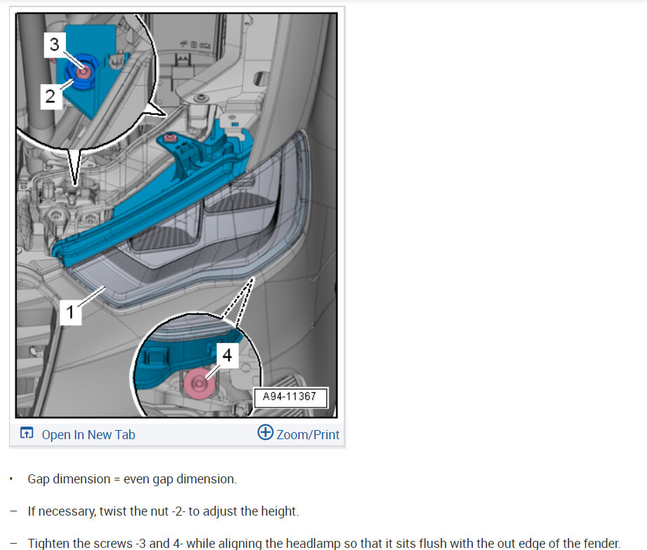

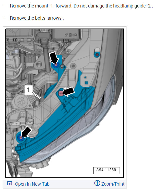

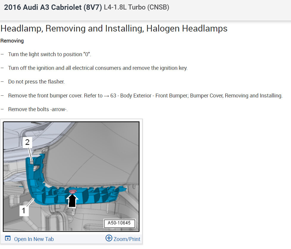

I would do the housing which has the voltage converter and headlight control module. Here is how to do the job correctly. Check out the images (below). Please let us know what happens.
