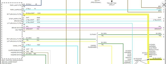

Hello, the right front turn signal does not work. The right rear signal flashes quickly. There is no power going from engine compartment fuse panel to the blue wire with the white stripe that operates that signal. I can find no fuses blown in the engine compartment or the drivers's seat compartment. I do not have the schematics necessary for me to check the BCM. I cannot find the fuses that operate the turn signals. Suggestions?

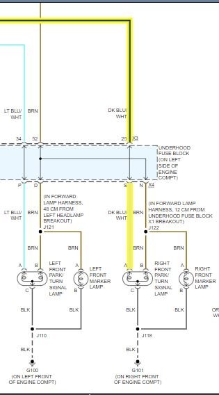

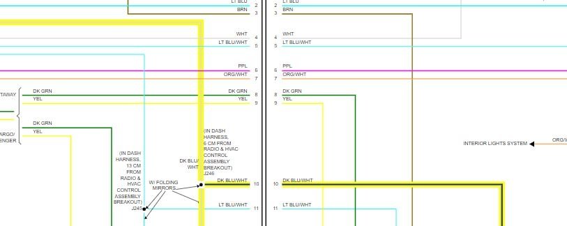

First, I attached pictures from the schematic. I highlighted the power supply from the BCM to the light. If you have power at the BCM (see picture 1) either there is a break in the wire or if there are folding mirrors on the vehicle, there is a splice under the dash in the wiring harness that may be bad. I put the pictures in order and overlapped them so you can follow the schematic.
Take a look through these pictures. The blue and white wire you referred is highlighted in yellow. Also, I circled the splice I am referring to.

Hi Joe, thank you for the schematics. I found the issue within minutes of taking a look at them. The issue was in the power supply to the BCM. There is more than one fuse in the engine compartment fuse panel that supplies BCM with power, and BCM fuse 3 was blown, and it controls only the right front turn signal. Once I had the schematics it was easy to trace. Thank you again for your help. Tim
