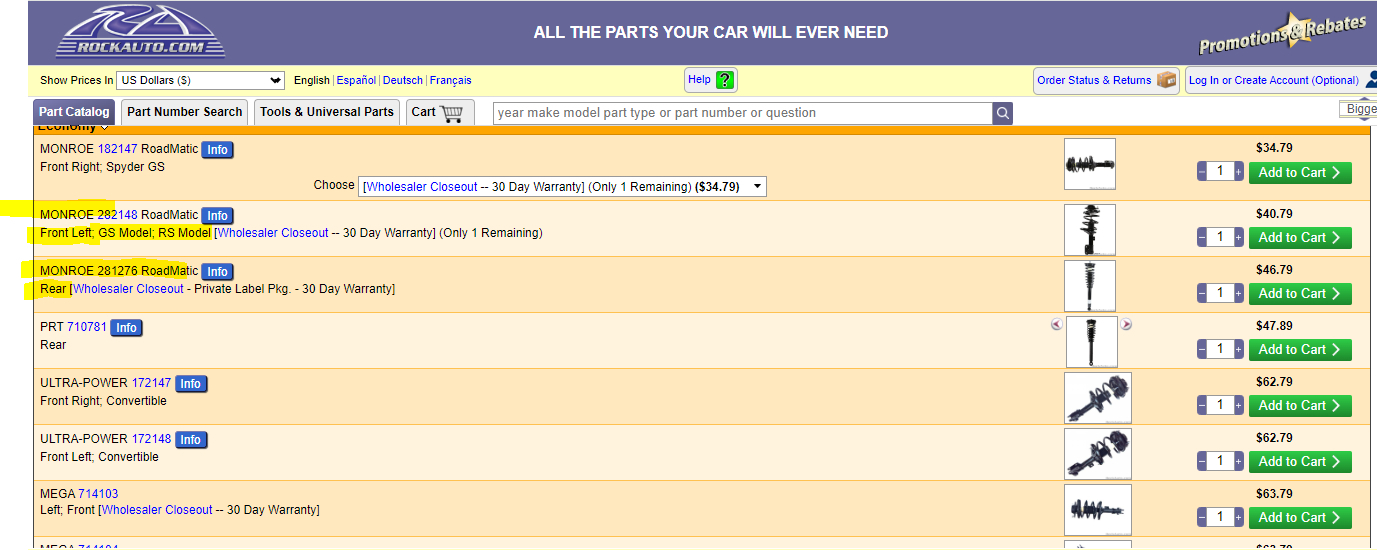

The noise could be from the strut or other things. When checking the strut, see if there is evidence of oil leaking from it. Also, check if the coil spring itself has cracked.
You could also do a bounce test. Aggressively bounce that side of the vehicle. It should stop bouncing within three bounces. If there are more, it needs to be replaced.
As far as brand, I jumped on Rockauto and found Monroe Quick Struts. They are very fairly priced. If you are looking for the best bang for the buck, that would be my first choice.
Additionally, if you order from them, put this code (26569615779875049) in where it asks how you learned about their site. It will get you an additional 5% off the cost.
Let me know if this helps or if you have other questions,
See pic below. Note: 2carpros and Rockauto are not affiliated with each other. I only made the suggestion to find a good part at a good price.
