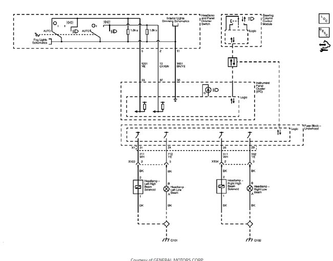

head lights, blinkers etc. stopped working right side.

Hey Peter,
It sounds like you blew a fuse, please locate the fuse box under the hood and test all fuses. Here is a guide that will help you.
Please let us know what you find so it will help others.
Best, Ken

checked out 2009 Saturn astra fuse lay out in the link. And there is no fuse that deals with headlights etc. ?????? Dealer is next stop

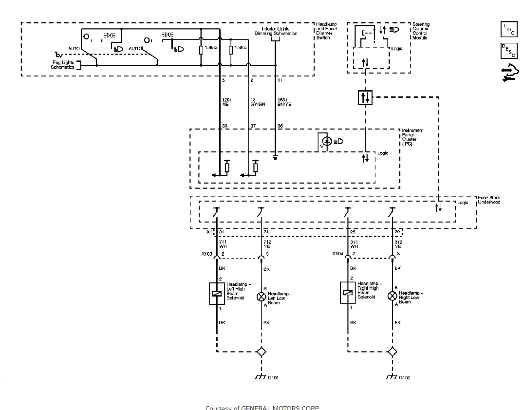

Hey Peter,
Here is a wiring diagram that shows the lighting system. It looks like you might have a logic module that is out.
Did you check all fuses, check fuse # 16 and #3?
Let me know what you find
Best, Ken

squirrel had a feed on my wiring Thanks for the help May need you again some time... have a good year Ken and thanks again Pete
