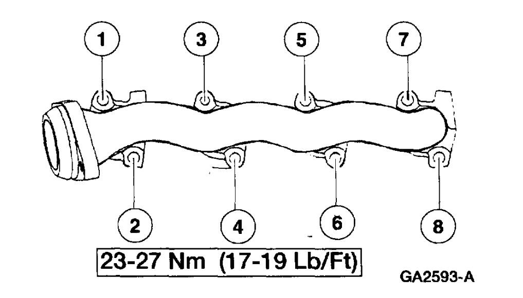

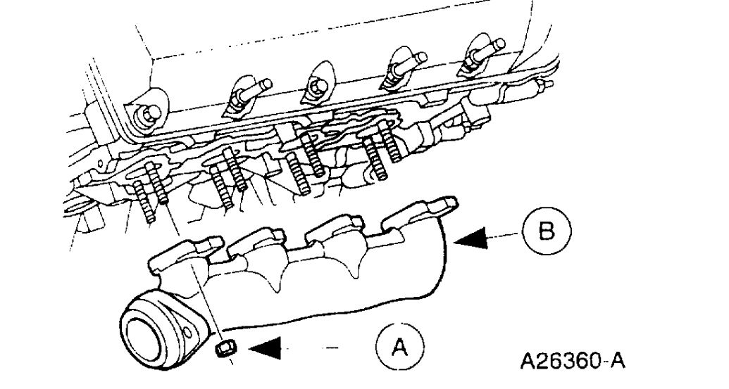

Good afternoon.
I attached the procedure with pictures for you.
I will warn you, it is a tight area you will need to access.
Removal
1. Raise and support the vehicle.
2. On 4x4 vehicles, remove the front wheel opening molding.
3. Remove the front fender splash shield.

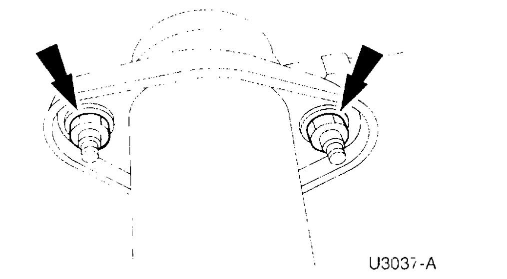

4. Note: 4.6L engine shown; 5.4L engine similar.
Remove the three-way catalytic converter to exhaust manifold nuts.
5. Remove the eight (A) nuts and the (B) exhaust manifold.

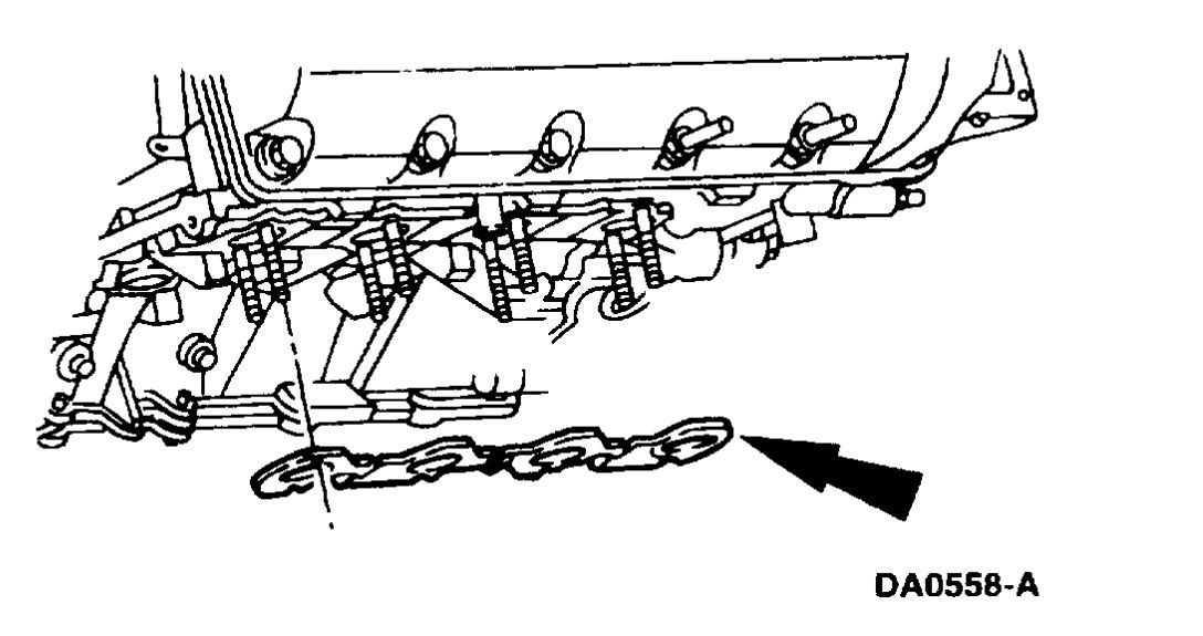

6. Remove and discard the exhaust manifold gasket.
7. Clean and inspect the exhaust manifold.

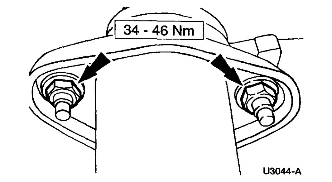

Installation
1. To install, reverse the removal procedure.
