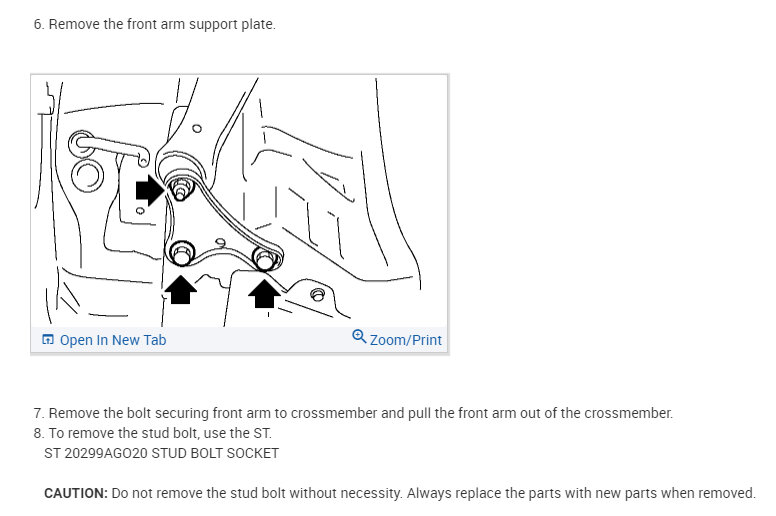

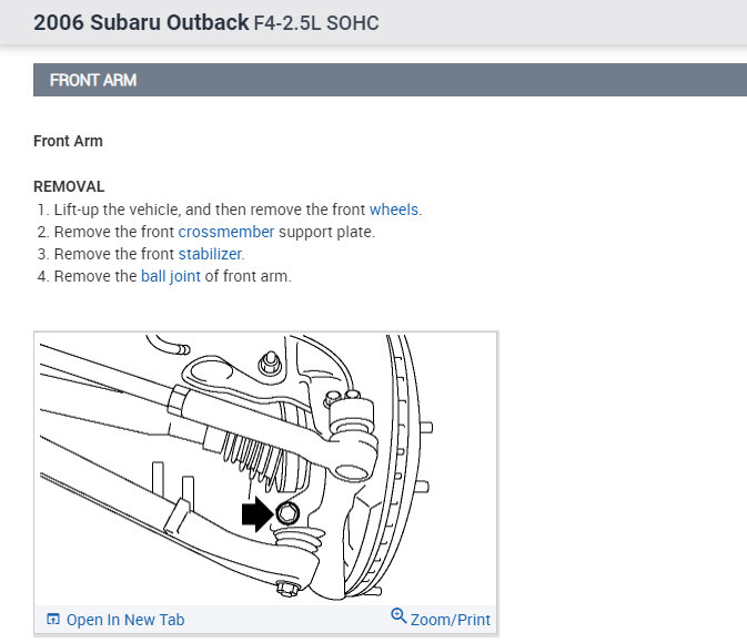

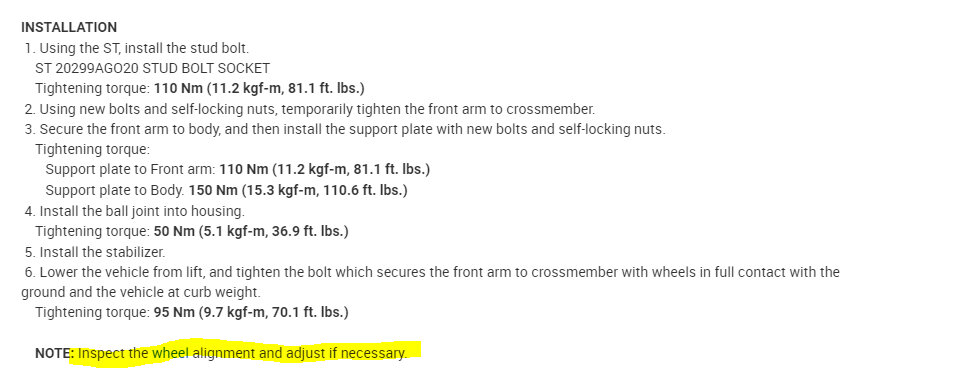

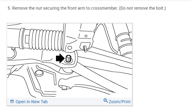

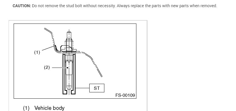

i replaced the right front control arm. i had a real problem aligning up the through boult holt on front bushing. now when i put in gear the wheel clunks and at about 15 to 20 miles an hour the car shakes like a wheel is very out of round. what did i do wrong?

When you did get it back together, did everything appear to be properly aligned? Are you certain that you have the control arm for the needed side?
I attached the direction below that explains how to replace the control arm. Take a look through the directions and see if there is anything you possibly missed.
Also, have you had the alignment checked?
