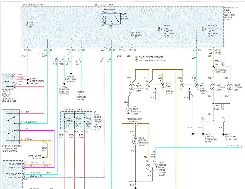

Right side brake light works when it wants. Looks like a short. Need diagram and location of the wiring components. Is this common on this year vehicle?
Mar 1, 2021 at 9:05 PM
  • 110,244 POSTS

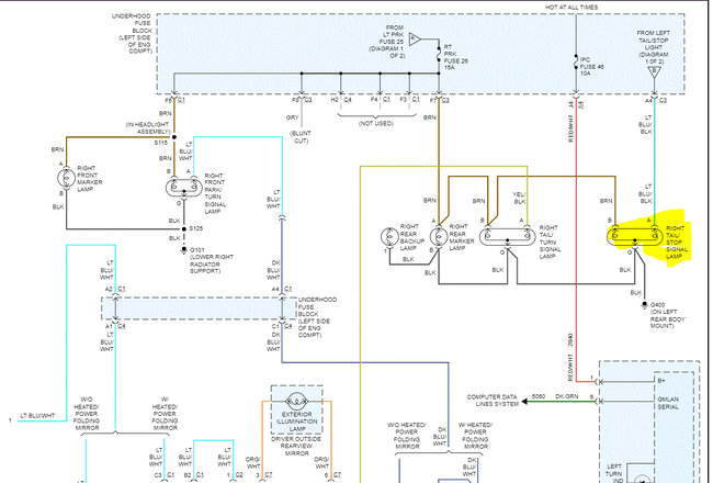

Most times it is the socket itself. Remove bulbs and inspect for corrosion or pushed in connection points.

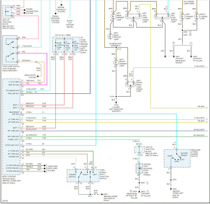

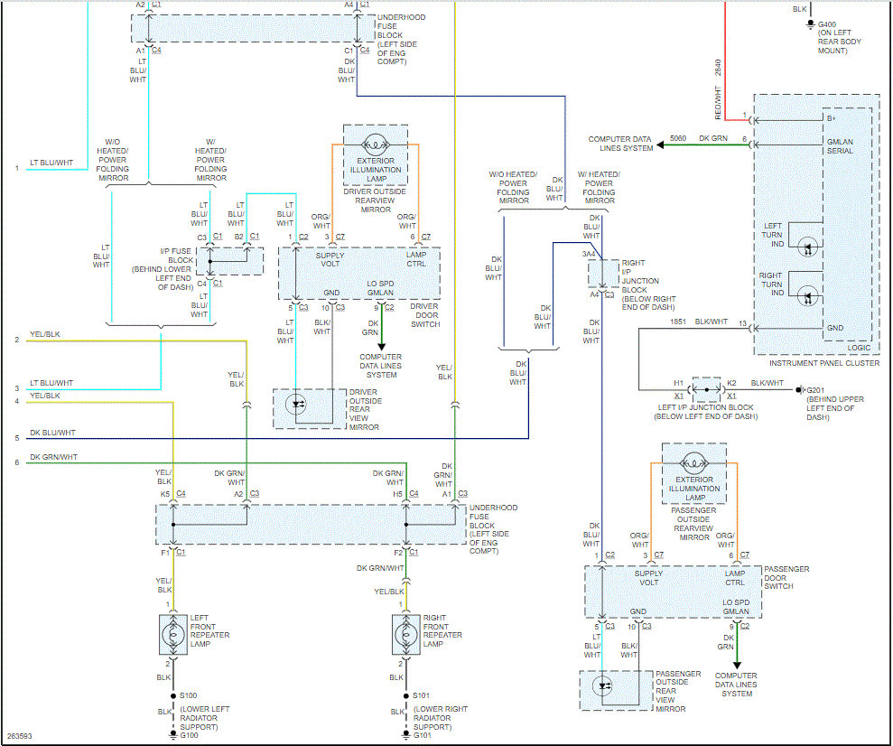

As far as the wiring schematic, I attached the entire exterior lighting schematic below. I had to cut the pics in half to make them readable. In pic 3, I highlighted the brake light on the right side.
Also, check the ground for that light. It could be corroded or loose. See pic 3 for location.
