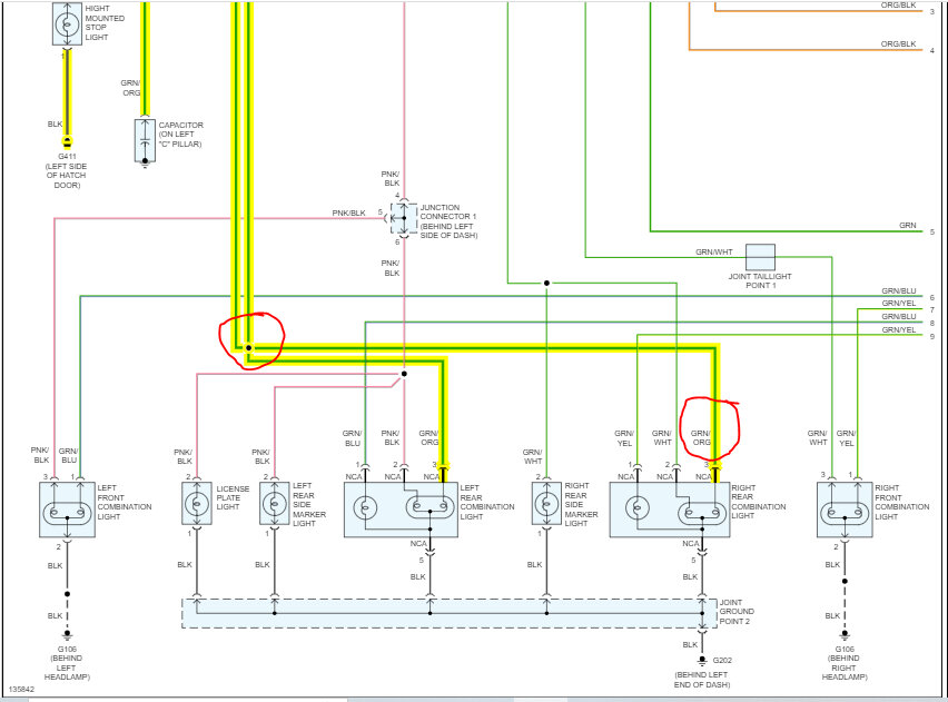

I have what seems to likely be a wiring related issue. My right brake light and parking light (same bulb) don't work at all. The right blinker light does work. I replaced the right brake light with a brand-new bulb and still got nothing. I also found out that the left brake light only comes on when the parking lights are turned on.
I haven't checked the fuses yet but it's likely not a blown "stop light" fuse because that would mean both lights wouldn't work. Also, there are a whole other slew of components tied to that fuse, and they wouldn't be working either.
I also think this rules out the brake pedal sensor for the same reason, since that would cause both brake lights to not work.
I bought a new brake light socket harness to replace the right side. I haven't tried this yet.
Nov 3, 2023 at 1:20 PM
  • 110,244 POSTS

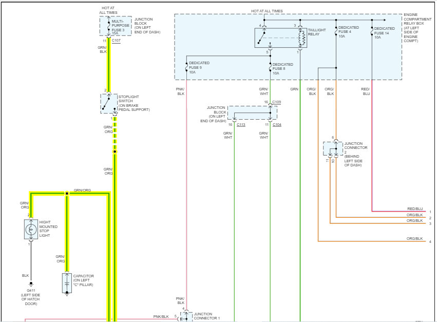

You are correct about the brake light switch. Also, the fuse has to be good as well. So, that leaves one of two possible causes. Either we have a weak ground or the wire to the right rear brake light is open.
There is a splice in the wiring, so the first thing I need you to check is if there is power to the green wire with an orange tracer when the brake lights are on. I attached the wiring schematic below so that you have a reference. I highlighted and circled areas of interest.
Let me know what you find.
joe
