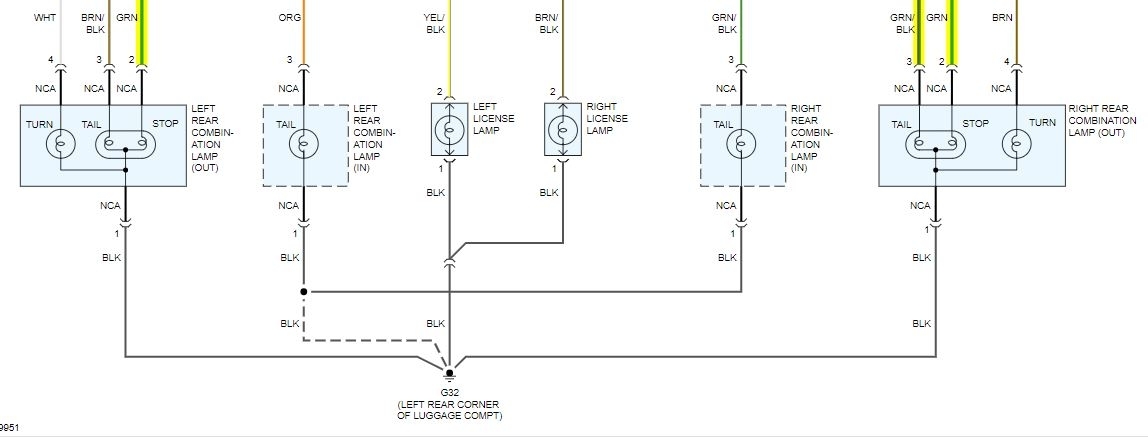

Right brake light doesn't work and right parking light goes out when brake pedal is pushed. All bulbs are good, even swapped left and right bulbs. P/N 2357 (2357LL)

My first suspect is a bad ground. What I need you to do is check the ground for the tail lights. It is located in the left rear corner of the trunk. Make sure there is nothing loose, no corrosion, and all wires are in good condition (not rusted or corroded).
See Picture 1.
