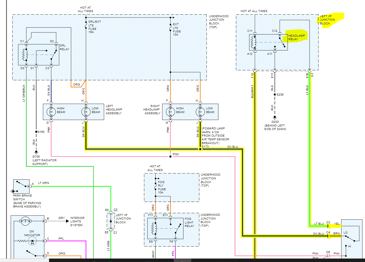

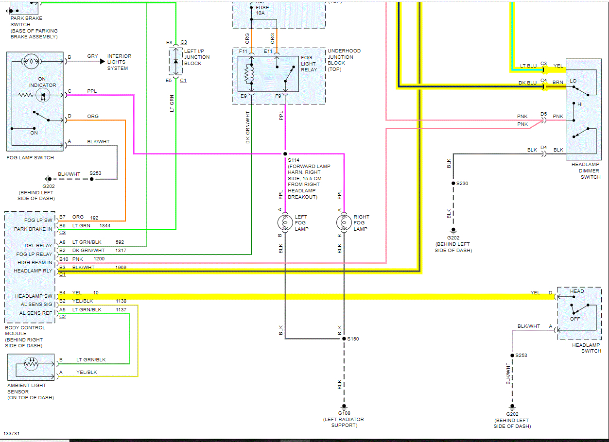

Is it only the right signals that don't work? If so, then at this time, I feel it is two different issues. I attached the wiring schematic below for the headlamps and highlighted everything related to the low beams.

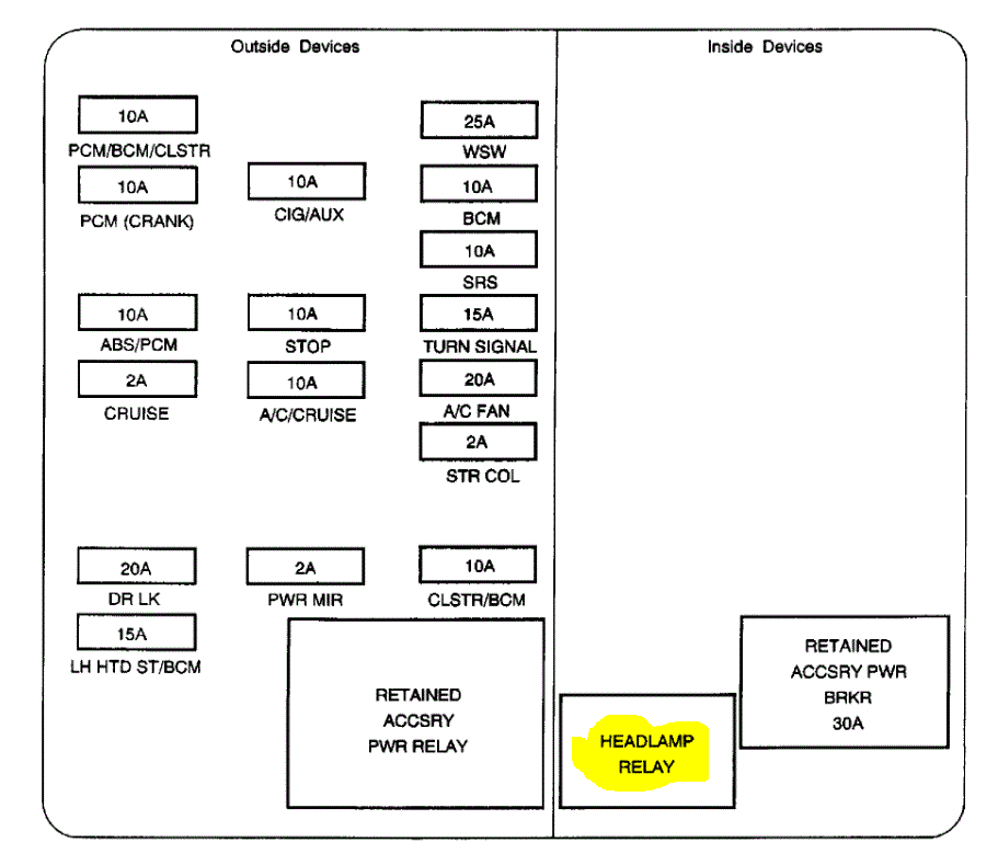

Check the fuses and the relay in the instrument panel fuse/relay box. As far as the headlamps, I don't see how it could be a fuse because the high beam is powered from the same fuse.
Let me know if there is a change when the relay is tested. Also, if you haven't purchased a new relay yet, here is a link explaining how to test one.
Pic 3 shows the relay location in the left instrument panel fuse/relay box.

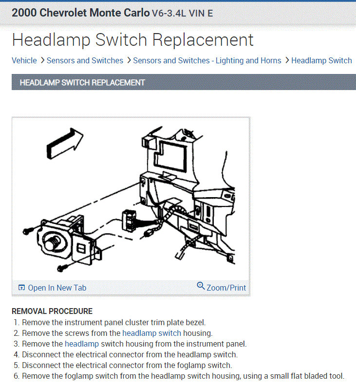

If the fuses I mentioned are good and the relay as well, chances are the switch itself is bad.
At this point, you can check for power at the switch, or try replacing it. However, make sure the fuses and relay are good.

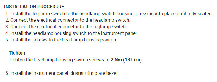

I attached the directions for switch replacement below.
Let me know if that takes care of the problem or if you have other questions.
