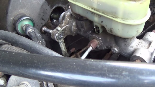

Thanks. But i can repair it. The only thing i found weird and i have never seen this in any cars. It looks like the master cylinder has been separated with spacers. How do I fix that?
Dec 31, 2021 at 1:49 PM
  • 110,248 POSTS
Is it possible for you to take a pic of it and upload it for me to see? The 318 isn't offered in the US, so I don't have the specifics. However, I've never seen a 3 series with spacers from the factory. I know people who have modified the brake systems have used spacers to adjust the pushrod clearance between the brake pedal and MC, but I'm not sure why your vehicle has them. If the brakes are working properly, you may want to leave it alone unless you feel it is causing a problem.

Yes, here it is.
Dec 31, 2021 at 6:11 PM
ANDY TOWSEND
  • 13 POSTS
That's the picture.
Jan 1, 2022 at 1:18 AM

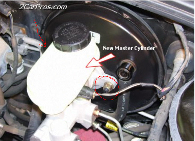

  • 110,248 POSTS
There is no spacer there. The nuts that hold the master cylinder onto the booster are missing. If the brakes work at all, I would be surprised. Don't drive it like that.
If you look at pic 1 below, I circled the nut that I'm referring to. I also placed an arrow in the pic that is pointing in the direction of the second one that needs to be installed and how tight they should be.
Here is a link that explains how to replace a master cylinder. I'm not saying yours is bad, but the link explains how to install/tighten one.
https://www.2carpros.com/articles/how-to-replace-a-brake-master-cylinder
Again, if this is how the vehicle is being driven, I am surprised it stops at all.
Let me know what I can do to help.
See pic below.
Jan 1, 2022 at 1:08 PM

  • 110,248 POSTS
Yes, that is the cause. You need to get two nuts and secure the Master Cylinder to the booster. Otherwise, she is likely going to have an accident. I can't believe the brakes do anything.
