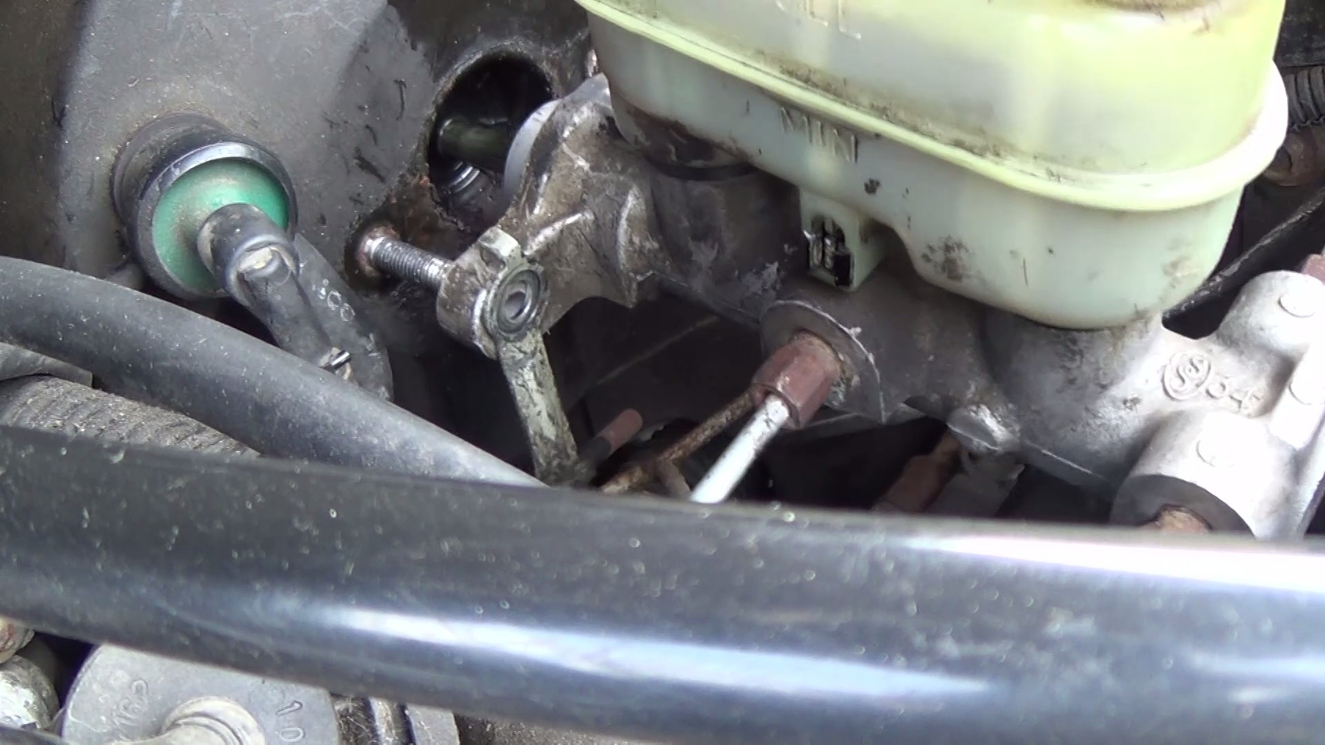

Thanks. But I can repair it. The only thing I found weird and I have never seen this in any cars. It looks like the master cylinder has been separated with spacers. How do I fix that?
Friday, December 31st, 2021 AT 9:49 PM
  • 109,885 POSTS
Is it possible for you to take a pic of it and upload it for me to see? The 318 isn't offered in the US, so I don't have the specifics. However, I've never seen a 3 series with spacers from the factory. I know people who have modified the brake systems have used spacers to adjust the pushrod clearance between the brake pedal and MC, but I'm not sure why your vehicle has them. If the brakes are working properly, you may want to leave it alone unless you feel it is causing a problem.

Yes, here it is.
Saturday, January 1st, 2022 AT 2:11 AM
ANDY TOWSEND
  • 13 POSTS
That's the picture.
Saturday, January 1st, 2022 AT 9:18 AM
  • 109,885 POSTS

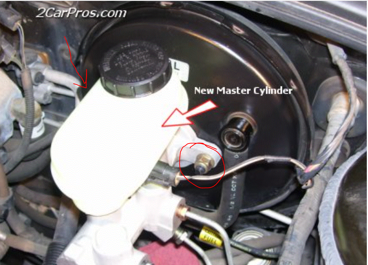

There is no spacer there. The nuts that hold the master cylinder onto the booster are missing. If the brakes work at all, I would be surprised. Don't drive it like that.
If you look at pic 1 below, I circled the nut that I'm referring to. I also placed an arrow in the pic that is pointing in the direction of the second one that needs to be installed and how tight they should be.
Here is a link that explains how to replace a master cylinder. I'm not saying yours is bad, but the link explains how to install/tighten one.
https://www.2carpros.com/articles/how-to-replace-a-brake-master-cylinder
Again, if this is how the vehicle is being driven, I am surprised it stops at all.
Let me know what I can do to help.
See pic below.

It is being driven yes. And that's what is creating the brake pedal to the floor and my wife thinks it's normal. Even though I told her it's not.
Sunday, January 2nd, 2022 AT 12:28 PM
  • 109,885 POSTS
Yes, that is the cause. You need to get two nuts and secure the Master Cylinder to the booster. Otherwise, she is likely going to have an accident. I can't believe the brakes do anything.
