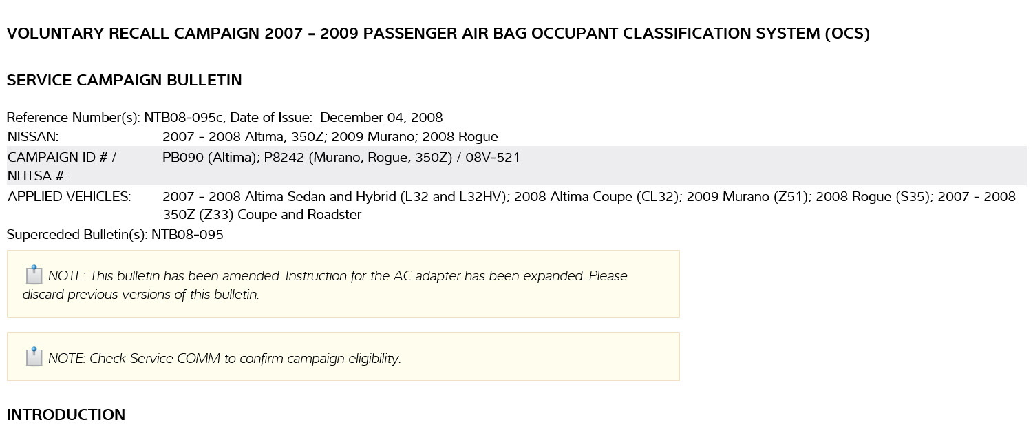

Rider side airbag light
2008 NISSAN ALTIMA
100,000 MILES • 6 CYL • 2WD • AUTOMATIC
ROBERT BARTH
Light does not work, Nissan said it would be around $2,400.00 to fix it. They said the sensor was made in to the seat. any way around this?
Jul 15, 2016 at 4:13 PM
HMAC300
  • 48,601 POSTS
there is a campaign on this very thing I have included in picture. have dealer check this . it should be of no cost to you. Your vehicle may not qualify due to VIN number, but I would call Nissan on 800 number before allowing dealer to charge for this.
