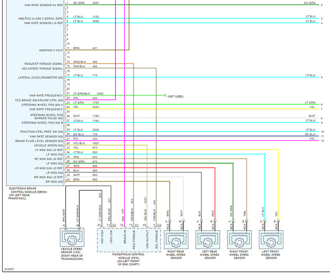

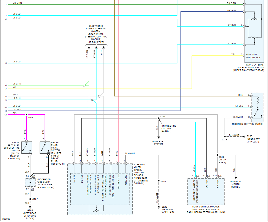

I had a mouse get to one of the wiring connectors that, I believe, helps control the stabilitrak system. It is a 10 pin connector, and one small section that doesn't have the wire loom coverage. It is located in the engine compartment, right below the BCM and fuse box, on the inner fender well. I'm looking to try to either directly wire the section, or get a new connector/repin. I need the diagrams to do this. 2006 Chevy Tahoe LT 4x4 Part of my concern on this, is that there are 3 light blue wires going through this connector. Without the diagram(s), I fear that a rewiring job may turn into further issues.

I see what you are saying about the lt/blu wires, make sure to match up the wires to the terminal number on the connector, (very small).
Here is a guide to help you test the connections:

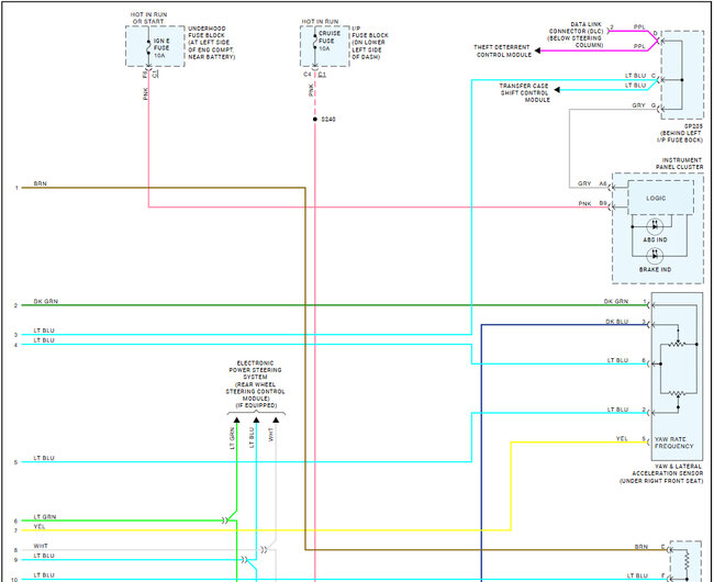

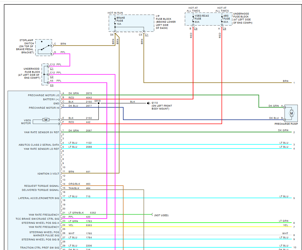

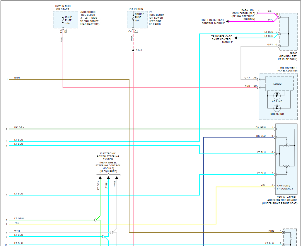

Here are the traction control wiring diagrams as requested. Check out the images (below). Let us know if you need anything else.

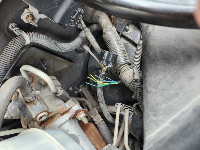

Thanks! The diagrams seem more helpful than what I had, but I thought I'd put this in here to see if it sparks anything.

I have never seen a mouse eat through the copper part of the wiring or did you cut them? Also, where is the other side of the wires?

The wire is a very small gage, so they got through it. The other part of the wires, the connector was cut off, to start looking at repinning. If I sent the right picture, there should be an indication of the harness.

Can I ask where the connector plugs into? I don't see a 10 pin connector in the traction control system.
