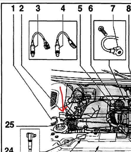

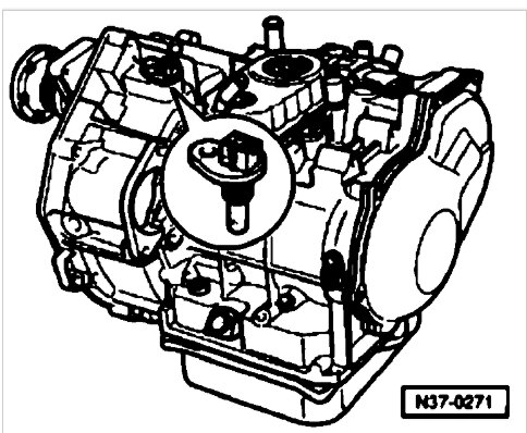

So two of the codes can make the engine stall, but the first code you will notices a jerking like a standard transmission car coming to a stop without putting the clutch in, so to me it sounds like the P0725 code is the issue.
P0740 - Torque Converter Clutch (TCC) Circuit Malfunction
P0725 - Engine Speed Input Circuit
P0441 - EVAP Incorrect Purge Flow
I would replace the engine speed sensor (crankshaft position sensor). Here is the location, the P0441 code could have been because the gas cap was off. I would clear the codes once the repairs have been made. Check out the images (below). Let us know how it goes.

Thanks for the quick reply, Ken! I appreciate your additional insights and pointing out the engine speed sensor issue.
Thank you for sending the illustration as well. Hopefully, I will be able to locate it on the engine without too much difficulty.

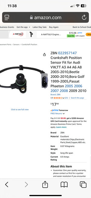

Thanks for that info! When checking online the OEM part is extremely expensive.
I did a search on Amazon and came up with this. It seems to be the right part number, but it doesn’t mention my euro van in the description.
Is this still the correct part?
Aug 20, 2025 at 1:38 AM
  • 55,691 POSTS
It looks correct, I would get it and give it a try to see if it works, 17 bucks cant go wrong.

Yes, unplug the MAF sensor when the engine stalls to see if it wills tart back up again, if so replace the sensor. I marked where the sensor is, check out the images (below). Let us know how it goes
