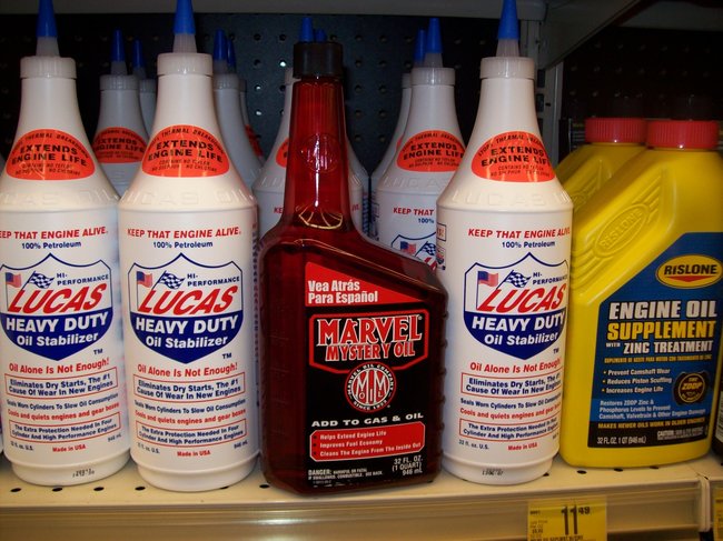

CJ MEDEVAC
  • 11,004 POSTS
FOR WHAT IT'S WORTH (SOME PEOPLE DON'T SUGGEST ADDITIVES- I'M DIFFERENT!)
NEXT OIL CHANGE SUBSTITUTE 1 QT OF MARVEL MYSTERY OIL, FOR A NORMAL QT OF OIL YOU WOULD NORMALLY PUT IN (NOT ADD A QT, AND BE OVERFILLED BY A QT!). WHILE YOU ARE DRIVING, "MMO", MAY CLEAN IT UP, "MMO" CAN BE LEFT IN, UNTIL NEXT CHANGE...OR YOU CAN RUN A NEW BATCH....READ THE BOTTLE!
IF YOU GET IT TO QUIET DOWN, YOU MIGHT DO WHAT I DO, I USE OIL STABILIZER EVERY OIL CHANGE IN MY 1977 JEEP CJ 5. I DRIVE IT ALMOST EVERY DAY, AND I REBUILT THE ENGINE IN '96, IT IS STILL GOING STRONG. (I DID NOT USE THE STABILIZER UNTIL MY 4TH OIL CHANGE, I WANTED TO INSURE MY CYLINDERS WERE BROKE IN WELL AT ABOUT 12,000 MILES).....I HAVE NOT HAD ANY TAPPET ISSUES WITH THIS ENGINE, BUT I HAVE USED THE "MMO" ON PREVIOUS CJs I HAD
I HAVEN'T HAD TO USE MARVEL MYSTERY OIL IN MY PRESENT CJ 5....I HAVE HAD 5 OTHER CJ 5s PRIOR TO THIS ONE, THE MMO, HELPED WITH SEVERAL OF THEM. I HAD ONE THAT WOULD NOT STOP, I USED A LITTLE MORE DRASTIC MEASURE WITH IT, BY INSTALLING A PUSH ROD A FEW THOUSANDTHS LONGER THAN THE ONE THAT WAS PUSHING ON THE ONE THAT WAS DOING THE "TAPPING". THAT SORTA JUST RE-POSITIONED THE PLUNGER INSIDE THE TAPPET AND IT BEGAN "SEALING" AS IT SHOULD, AND THE TAPPING CEASED.
IT ONLY TAKES A LITTLE STUCK ON BURNT LOOKING OIL ON THE THIN STEEL DISCS INSIDE A TAPPET TO KEEP A TAPPET FROM SEALING.....I'D TRY THE MARVEL MYSTERY OIL 1ST, BEFORE GOING ANY DEEPER. DO OT OVERFILL YOUR OIL, DRAIN OUT A QUART, THEN INSTALL A QUART OF MARVEL MYSTERY OIL
THIS STUFF HAS BEEN AROUND SINCE WWII, YOU CAN FIND ENDORSEMENTS ON YOU TUBE, BEATS TEARING INTO ONE!

I've used the mmo, sea foam, had a bg flush done. I thing what's happening is I've got some lite piston staple when it's cold. The Knock sensoris picking it up and is to correct it by changing the advance. This is causing an ignition ping which gets louder the more it try to get rid of the knock caused by the piston slap. Till it gets to a point where it then resets it's self to start the hole process over to try to get rid of the piston slap. As the piston slap goes away as it worms up the knock senor doesn't pick it up anymore and every thing is fine.
