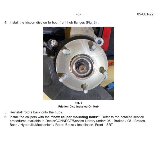

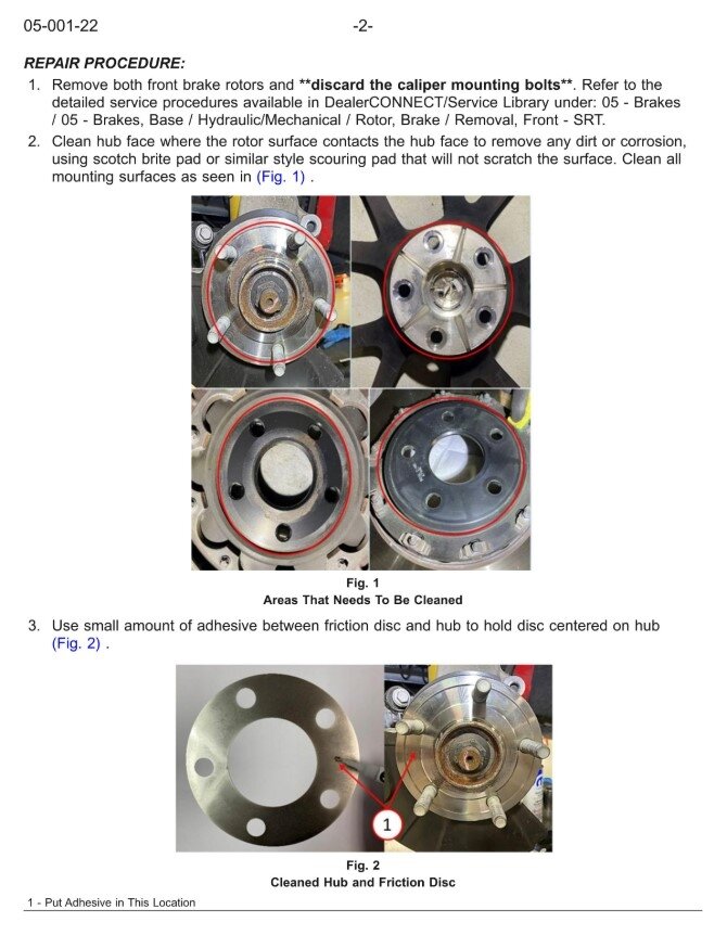

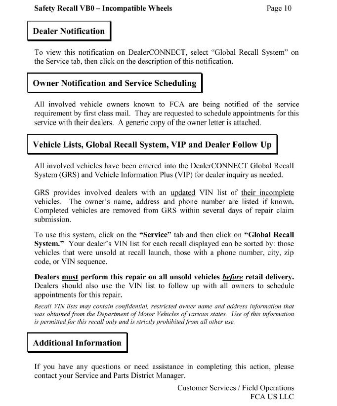

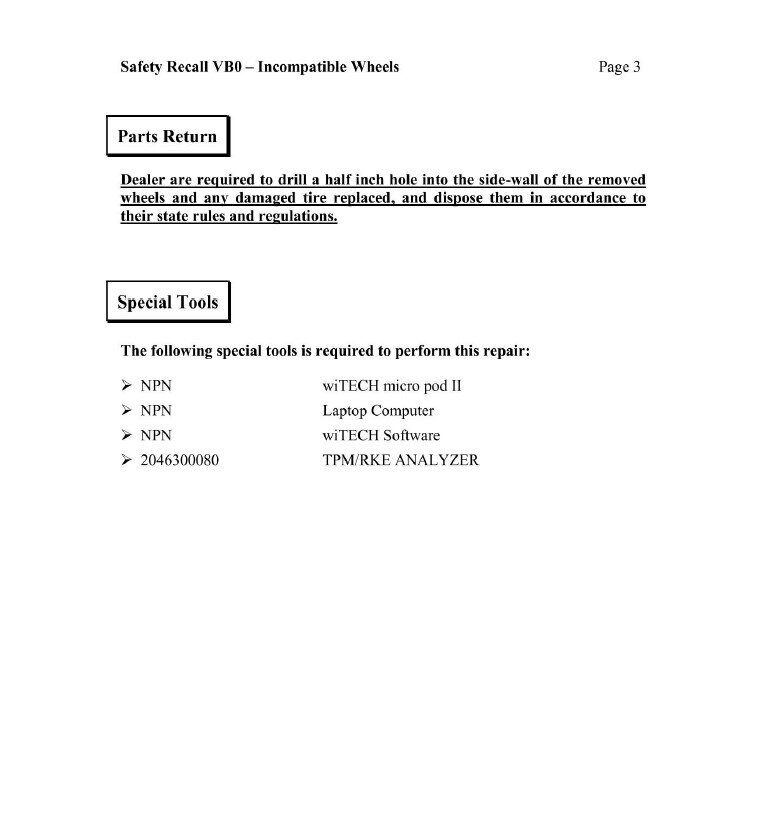

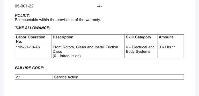

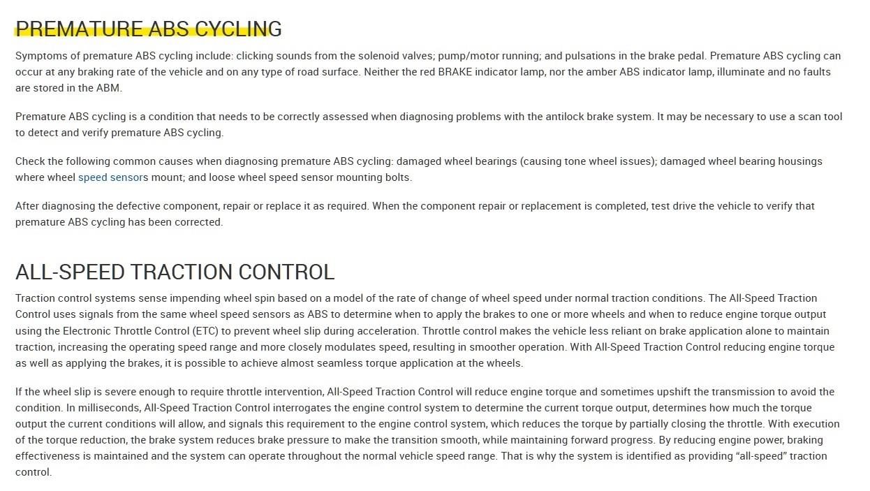

So I did come across a technical service bulletin (TSB) about the dealership adding an additional "Friction Disc" to the wheel hub due to a noise (diagrams 1-4), and then a Recall about a limited amount of vehicles being built with an incompatible wheel and brake/suspension package, but this only looks to apply to 173 vehicles, so very unlikely this has anything to do with your vehicle, but just wanted to put the information up. The TSB though might be worth looking into if there are no ABS or traction control codes stored, and no issues found. A scan tool should be able to show under live ABS data if the ABS module is applying one or more of the hydraulic solenoids. Possibly also showing if the module is receiving data to do so from a bad sensor or if something else is going on with a sensor such as something effecting the sensor.
I'm going to post some other additional information next that will be helpful.
Apr 18, 2025 at 4:15 AM
AL514
  • 5,610 POSTS

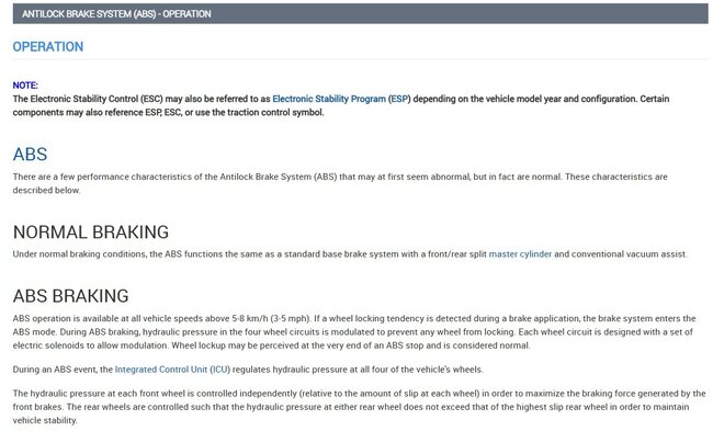

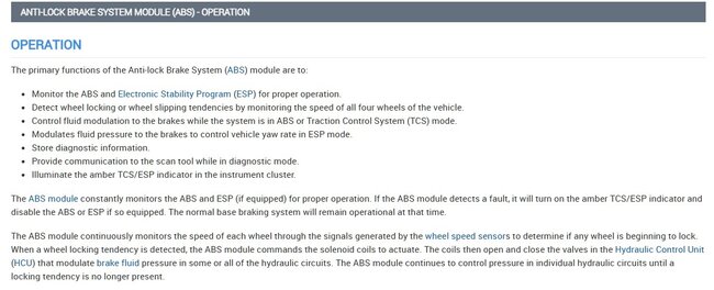

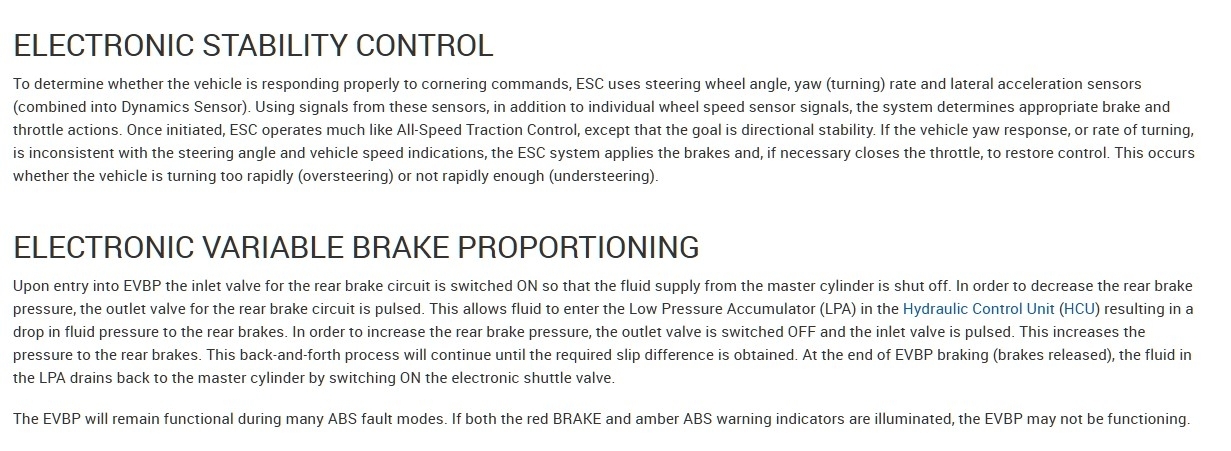

This the ABS and ABS module operations, check out diagram 4, it explains Premature ABS cycling/application with what can cause it to happen, which is what it sounds like you're dealing with. Let us know what you find and what the repair ends up being, it will help others who run into this issue. Thanks, and I hope this service info helps.

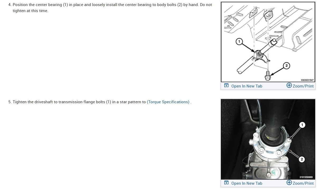

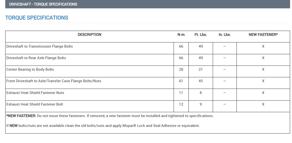

AL514
  • 5,610 POSTS

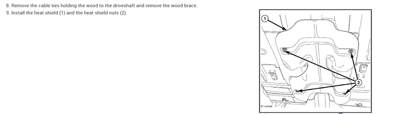

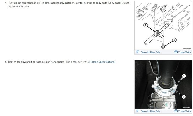

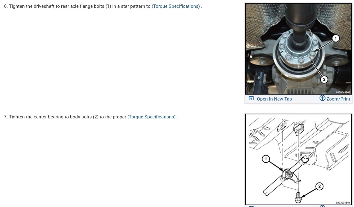

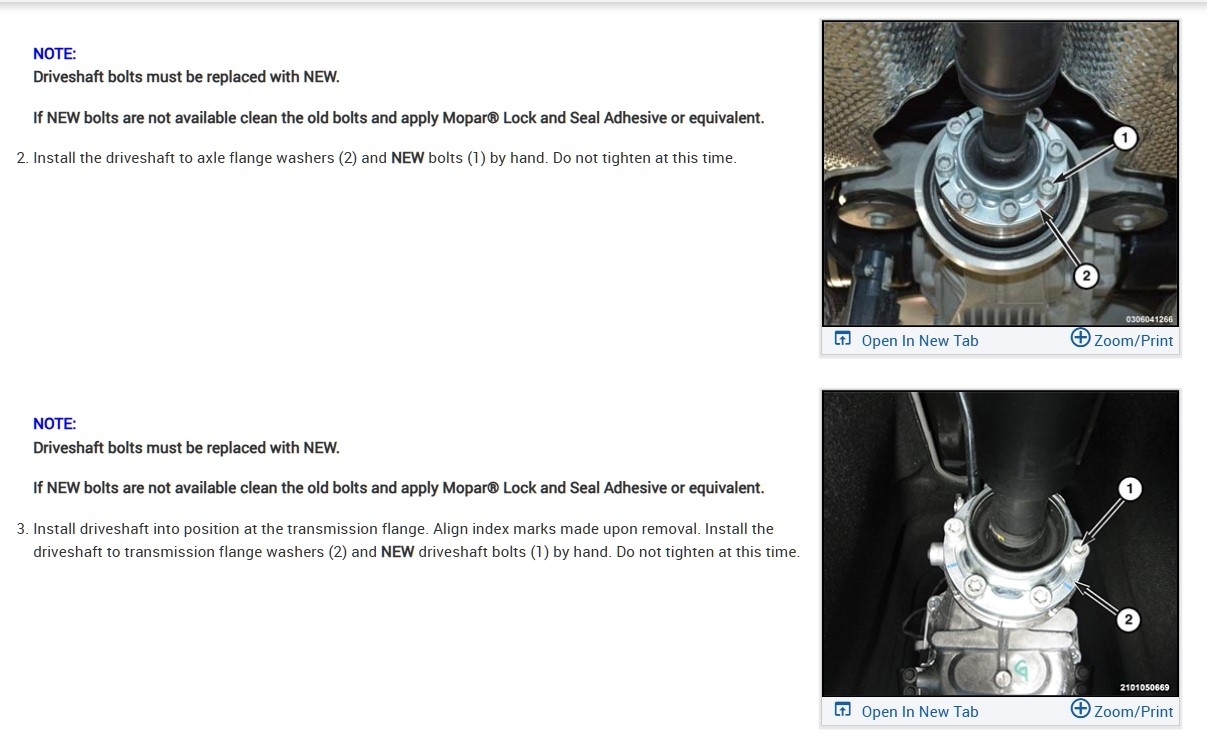

Interesting, there was enough play in it to move, looks like it's a high failure point, hopefully that will take care of everything, there is some service information on replacement, do you have this type of bolt on driveshaft setup? This is just the installation info for a driveshaft that bolts onto a flange at each end.
