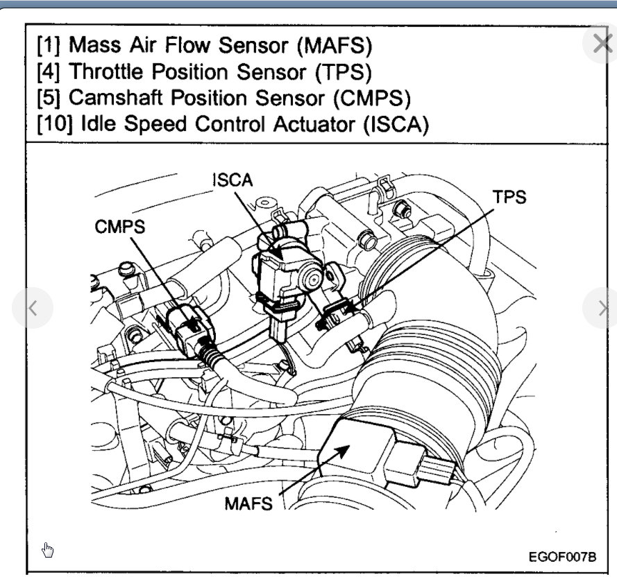

The last most likely cause is the idle control has failed.
https://www.2carpros.com/articles/how-to-replace-an-idle-speed-control-motor-iac
Below you will find the detail about your idle control. If nothing else, I would replace this and retest the issue.

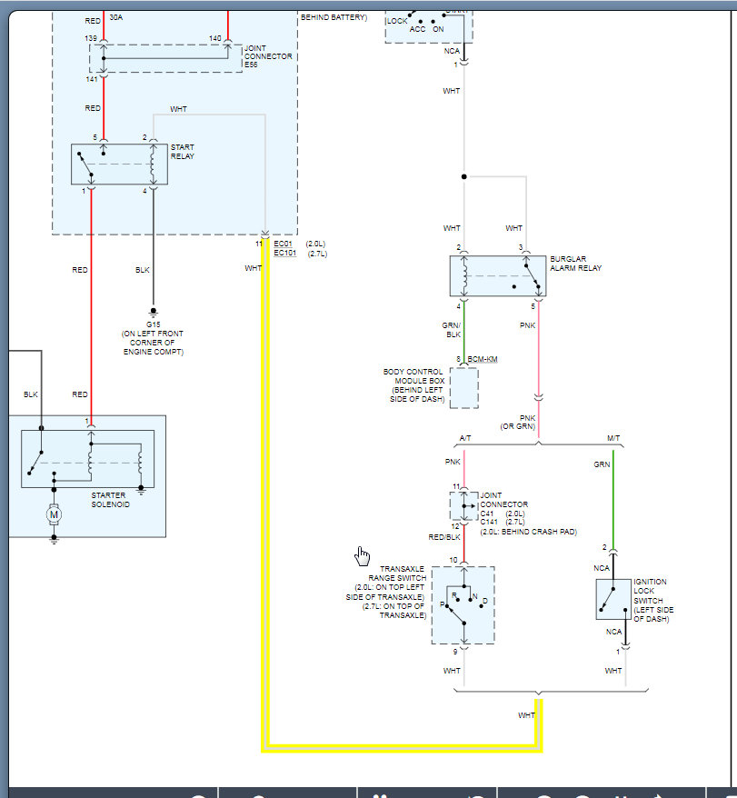

I am touching the starter relay the one next to the main relay the copper inside of the relay itself.
Feb 25, 2021 at 12:57 AM
DANI ZATELLI
And I'm touching it with my finger i take the cover off of the relay itself and then just touch it. Starts every time like that . I'm going to take a pic of it here in a few minutes.
Feb 25, 2021 at 12:58 AM

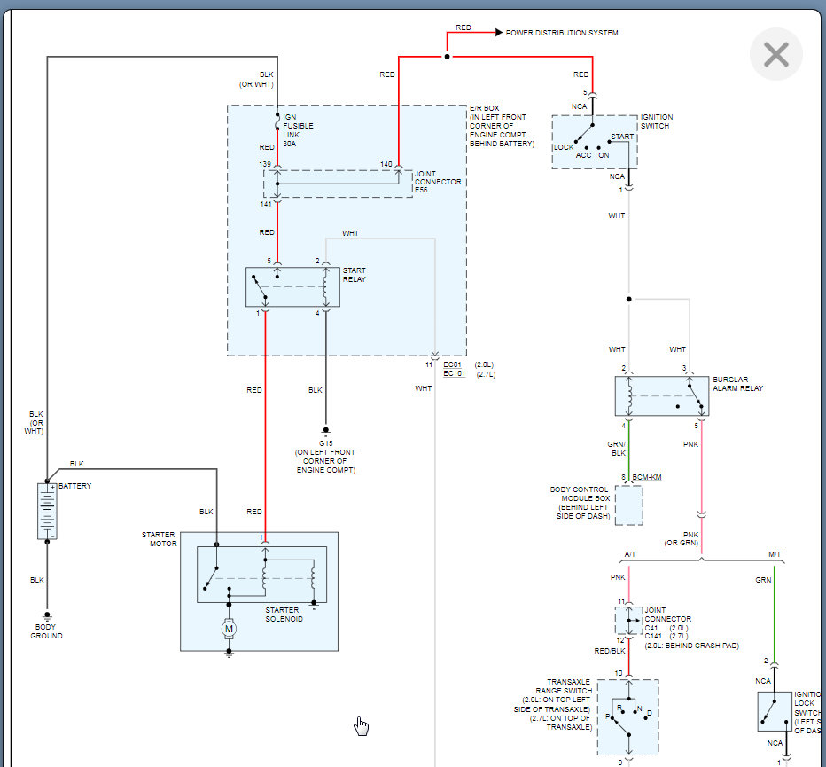

That is great info. So what you are doing is closing the relay yourself rather then the coil side of the relay where it energizes when power is applied to it and it pulls the contact closed.
This means that highlighted wire is not supplying voltage. So either the alarm relay has failed or the ignition lock switch (on manual transmissions) has failed or the BCM is not grounding the alarm relay.
Let's go to the ignition switch and test for voltage coming in. If you have it coming in on the green wire then you can just the switch and the engine should start. This proves the switch is the issue.
