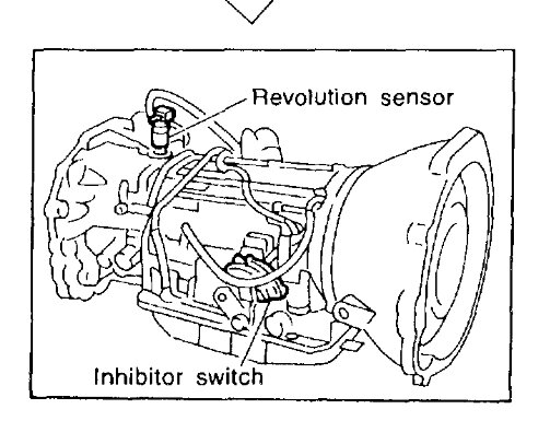

Where is the Revolution Speed Sensor located?
1998 INFINITI QX4
120,000 MILES • 6.1L • 6 CYL • 4WD • AUTOMATIC
KENNETH BANKSTON

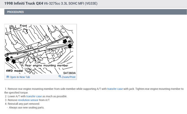

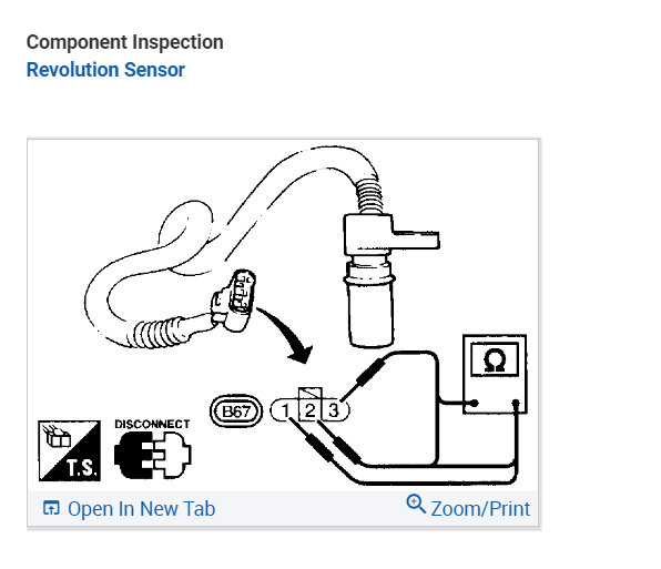

Output Revolution Speed Sensor replacement location.
Dec 29, 2022 at 9:10 AM
  • 55,395 POSTS
The exact location is on top of the transmission toward the rear, the wires to the sensor are black/white. I have included what the sensor looks like and location below. Check out the images (below). Please let us know if you need anything else to get the problem fixed.
