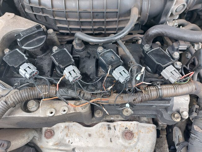

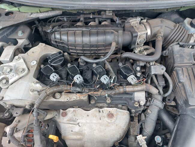

Had my ignition coil harness rewired and now I'm getting reversed polarity when I try to jump the car. Doesn't start. If possible, please share an ignition system harness diagram.

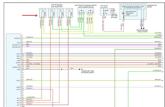

Yep, if you get the wiring wrong it will shut down the injector driver inside the PCM. Here is how the coil are supposed to be wired. Check out the images (below). Let us know if you need anything else.
