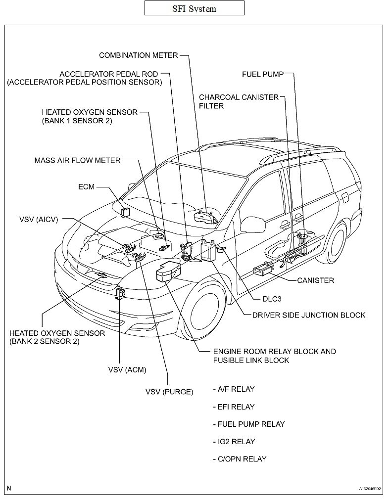

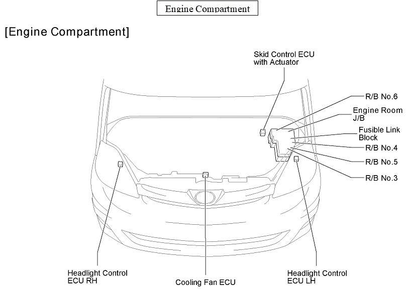

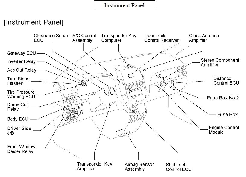

These three drawings show the locations of the multiple fuse boxes. They also point out "fuse links". Those could be rather large fuses, both electrically and physically, or they might be "fuse link wires". Fuse link wires are used in circuits with a very high start-up current, like for motors, where a regular fuse would blow too easily. Fuse link wires are slow-blow fuses that need some time to burn open. I wouldn't bother with testing those for now as they are likely to be okay. They also usually protect a number of circuits, so only suspect a fuse link wire if a lot of circuits are dead. You tug gently on them to test them. If they're good, they'll act like a wire. If one is burned open, it will act like a rubber band.
