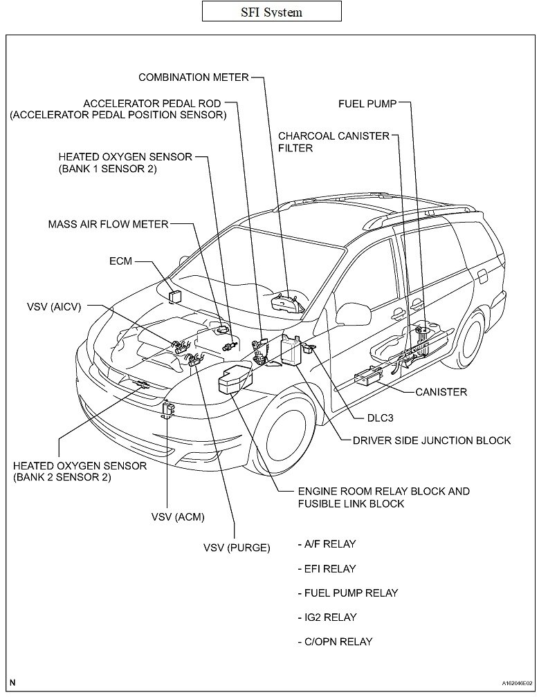

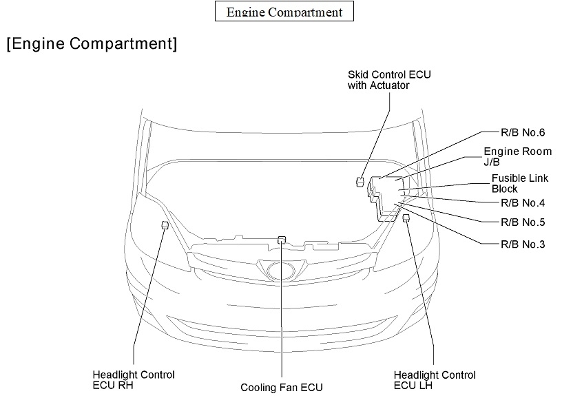

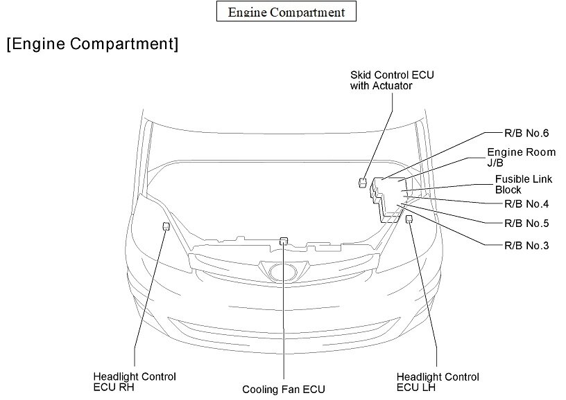

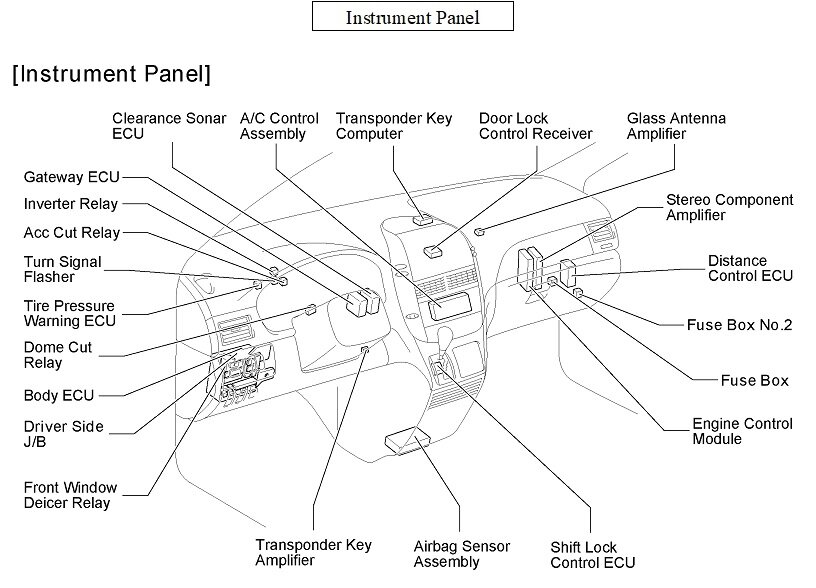

These three drawings show the locations of the multiple fuse boxes. They also point out "fuse links". Those could be rather large fuses, both electrically and physically, or they might be "fuse link wires". Fuse link wires are used in circuits with a very high start-up current, like for motors, where a regular fuse would blow too easily. Fuse link wires are slow-blow fuses that need some time to burn open. I wouldn't bother with testing those for now as they are likely to be okay. They also usually protect a number of circuits, so only suspect a fuse link wire if a lot of circuits are dead. You tug gently on them to test them. If they're good, they'll act like a wire. If one is burned open, it will act like a rubber band.

Point of interest. Just about all computers have a minimum of two 12-volt power feeds. Engine Computers commonly have four. ABS and Air Bag Computers in particular will always have two 12-volt power wires so one of them can run the circuitry to run the dash warning light when the other one has a blown fuse. That's done for safety. If there was only one fused 12-volt circuit, and that fuse blew, you'd never see a warning light or know that system was inoperative.
My cousin has a 2003 Sienna. I was surprised to see so many fuse box locations for a 2007 model. One under the hood and one inside is typical. Let me know if you're trying to solve this on your own. I'll look for the fuse box locations for a 2003 if you need them.
