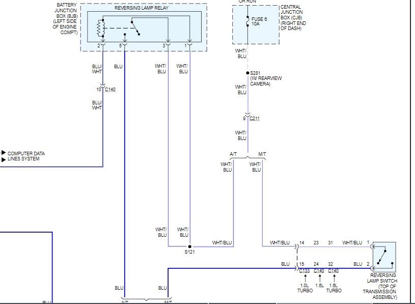

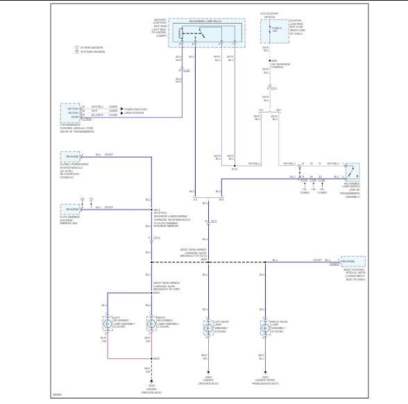

Got it.
I attached a diagram for you of the back up lights. The switch is on top of the transmission. There is a fuse for it. Make sure it has power on both sides with the key on.
