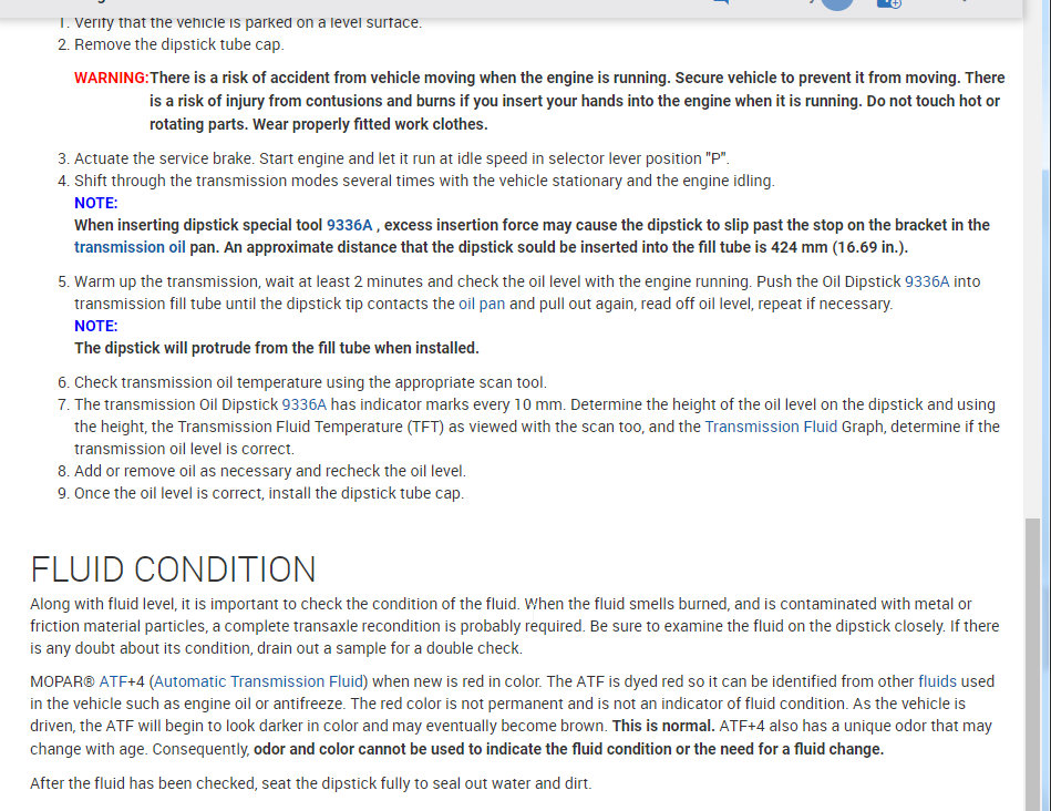

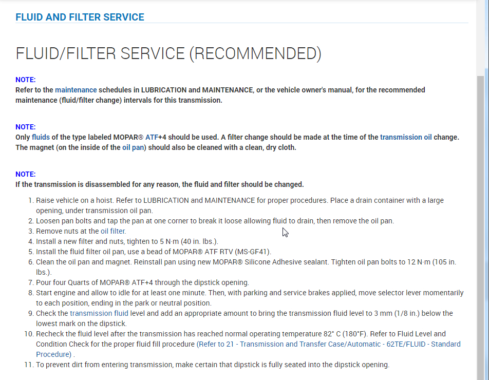

We just bought a brand new van SXT Premium Plus. It only has seventy seven kms on it. We had it for one night everything was great until we reversed into our driveway. When we reverse the van struggles and shutters while trying to reverse pressing the gas as well as having to really press down on the gas to make it move but it shoots back really fast like we are on a hill. They told me a service would fix it so I need to do the job.
Dec 28, 2016 at 12:36 PM
This does sound like a fluid issue or possibly the pump is at fault.
Here is a guide on how to service the transmission:
I would suggest changing the fluid and go from there.
I attached the info below on this for your review. Please run through this and let us know if you have questions. Thanks
