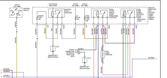

give me a number of the fuse in the fuse panel an dwhere it's located. dash/underhood then you will need a circuit breaker to install wher effuse is then you dvm you can probe one of the wires, but also get a compass and run it across harness if you see it go screwy look there. but this will be very hard to find. is this a stick or automatic because it could be something in trans.

that's the fuel pump circuit and on the diagram i'm sending it should have a 20 amp fuse not a 15 so try that first/ even on my chart it says 22 should be a 20 amp the if it still blows then check your relays first then you'll see a resistor there. see if that is shorting out. then see if the ground on left rear wheelwell is connected and not loose or dirty. do the easy stuff first. you can replace the relay with a like relay to test it. the red white wire off the second relay goes to the pump but it may only be the wrong fuse in there.

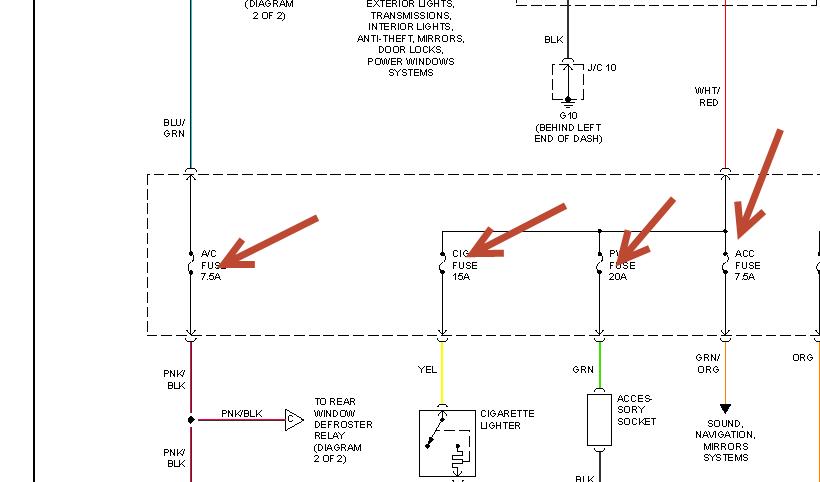

ok pull these fuses one at atime to further see what circuit it is. the #20 fuse goes to igniton switch. after you pull these fuses things won't work like radio etc. if it still does it with the fuses then it's either the wire going to ignitionswitch, the switch itself or there is a relay that the switch turns on to send power to the fuses shown. once you find out what circuit it is then we can go from there. Also if your cigaretter lighter is pushed in or look for coins in it as that can cause this as well.

Ok I test the fuses the lights of the interior works that's it put key in at acc or on position and no power because the that ignition fuse is blown. Once I put a new 15a fuse in the #20 put key in and it turns it on working normally. But still as soon as I go try to go in reverse the same fuse which is #20 keeps blowing.

I forgot to send the pic of what fuses to pull one at atime sorry. that will break down which circuit is giving you problems if it's not the ignition switch. re read my last reply as well. ok now check these fuse by pulling them out one at atime and driving in reverse. if the car continues to run that is the circuit that is causing the problem
