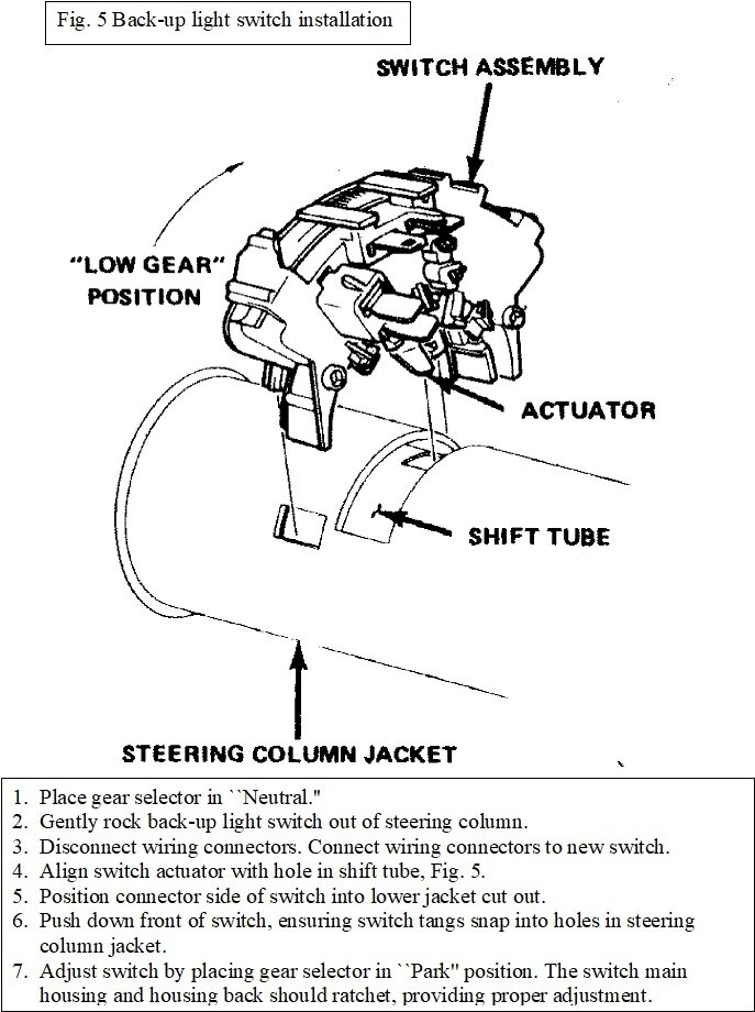

Reverse light's not working
1985 OLDSMOBILE CUTLASS
6,000 MILES • 3.8L • V6 • 2WD • AUTOMATIC
JADEN0408
Where is the reverse switch located
Aug 13, 2025 at 6:43 AM
CARADIODOC
  • 34,381 POSTS

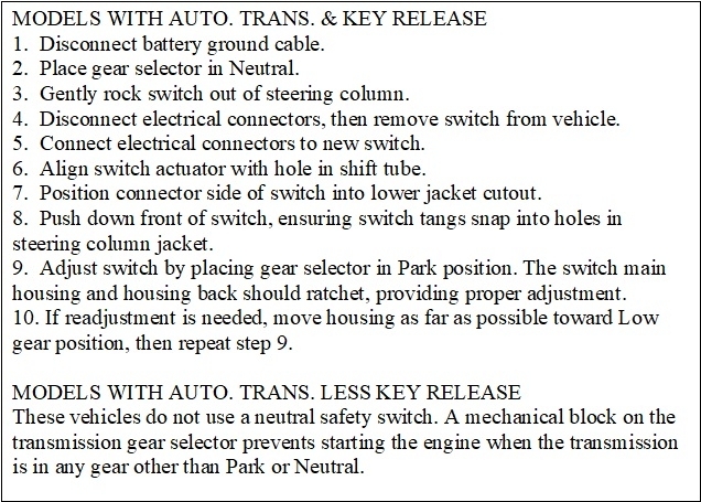

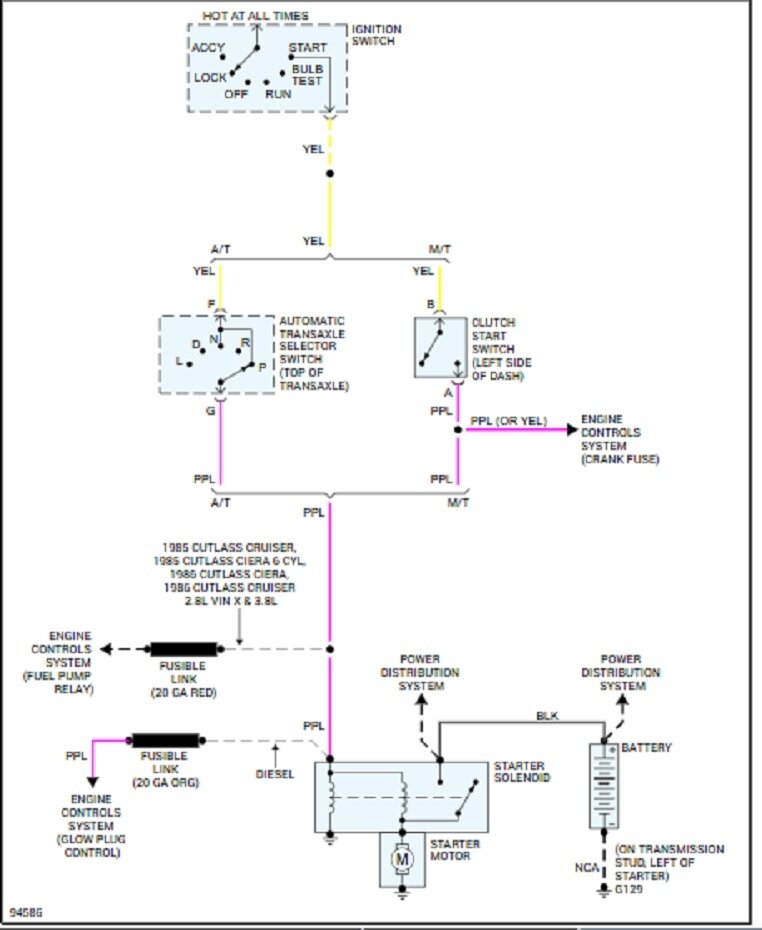

There's four different models of Cutlass. None of the service literature does a good job showing the switch locations. This first image is for the Ciera. The second one is the circuit diagram and is the same for the Ciera and the Ciera Cruiser. The third one is for the Cutlass Supreme. There's also the Salon model, but there was no information for that one.
Notice in the second diagram, they list the switch as, "top of the transaxle", and at the bottom of the first one, it says some models don't use a neutral safety switch. Does that help? If not, let me know which model you have.
