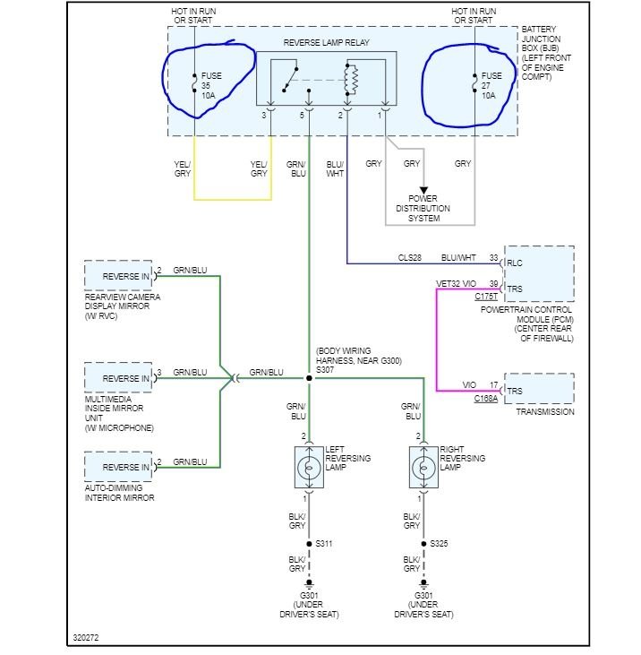

Replaced all rear bulbs but still have no back up lights.

Good morning,
I attached a wiring diagram for you. Check the fuses I circled for power on both sides with the key on. Let us verify power to the relay.
