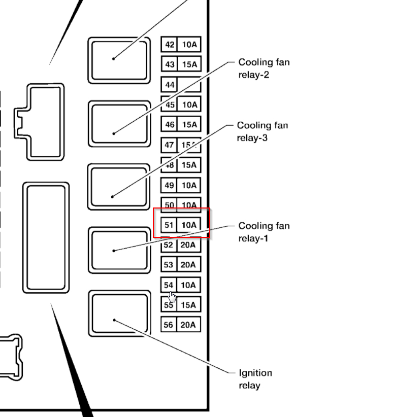

Checked the rear sockets with a test light did not light rest of sockets are okay. replaced the park neutral switch. could find a fuse up front had a fuse box had a place for reverse light fuse but was empty. thank you
Mar 21, 2021 at 12:00 AM

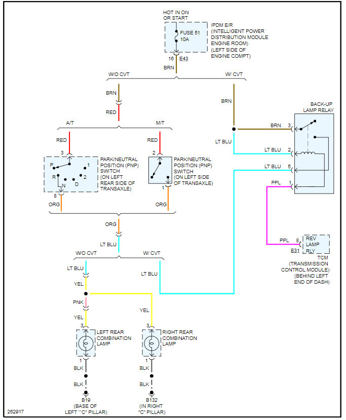

So if you have no reverse lights then we need to go to the relay and test the relay first assuming you have a CVT. Here is a guide that will help with this:

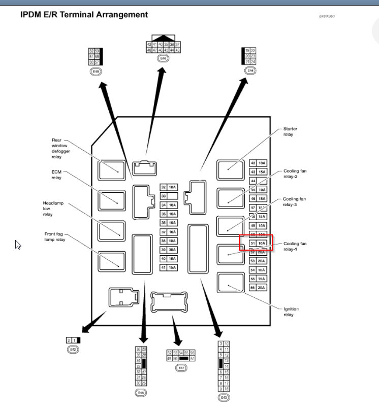

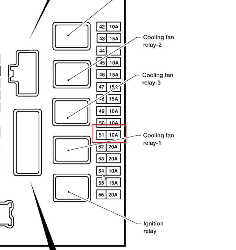

If it is not CVT then we need to locate the fuse in the fuse box in the left side of the engine compartment.
It is fuse 51 and I circled it in the below attachments.
Let's start with this and go from there.
