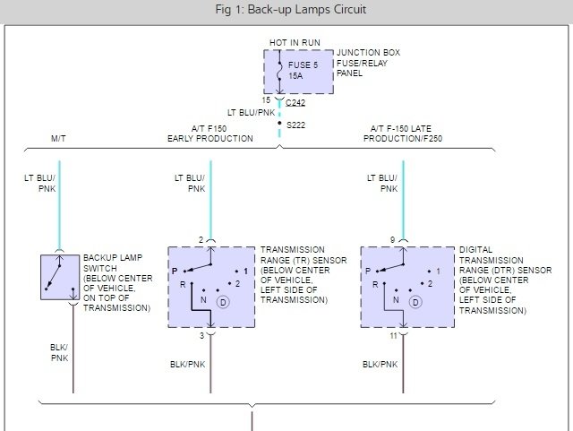

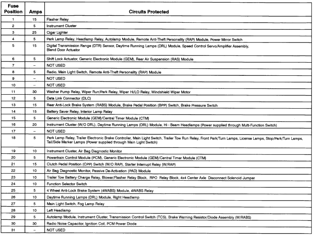

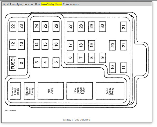

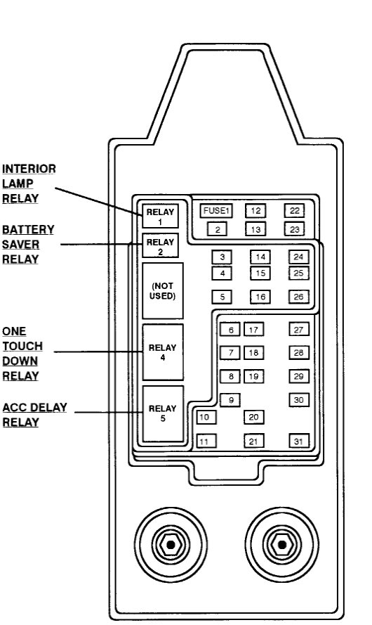

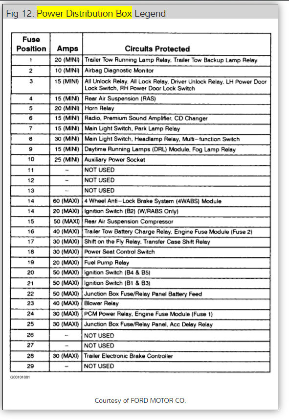

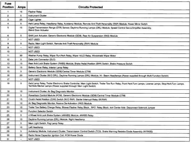

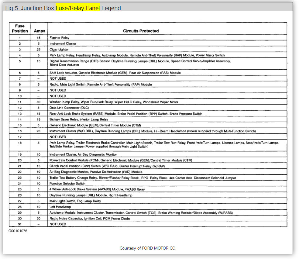

Lets check for power at fuse # 5 here is a guide to help you and the reverse light wiring diagrams so you can see how the system works and the fuse locations as well.
Check out the diagrams (Below). Please let us know what you find.

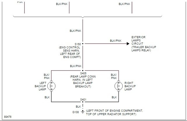

The rest of the diagram?
Such as the grounds (locations given)
Power at the fuse location?
Problem with the trailer back-up relay?
Connectors needing dielectric grease?
Connectors with melted plastic/ pins not making contact?
Unplugging the lights (in various places along the way and introducing power using long jumper wires to verify the housing/ lights do work?
Gotta be in here!
