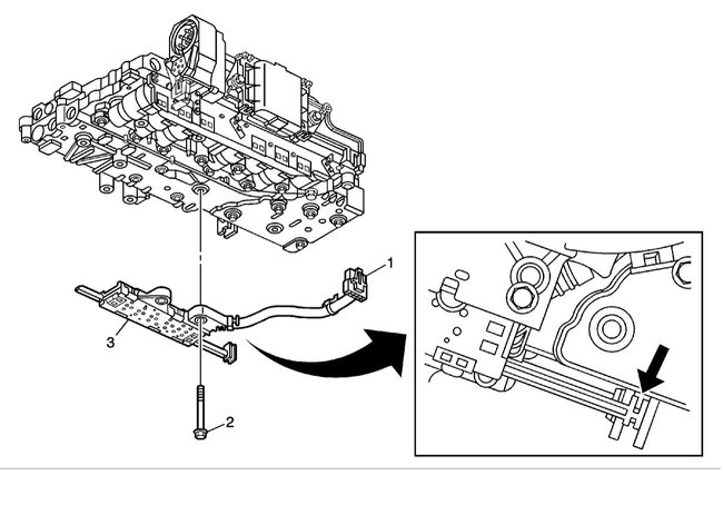

The reverse lights stay on while driving. The rear camera also quit working but I am not sure if both problems occurred at the same time. What should I check? Thank you.

It sounds like you have a problem with the transmission selector switch which would affect the rear camera as well.
Here is a diagram for the location of the switch which is inside the pan near the valve body.
Best, Ken

Back up lights remain on while driving. Back up camera stopped working a few weeks back. however, I do not know if both problems occurred at the same time. Just became aware of light problem yesterday.
