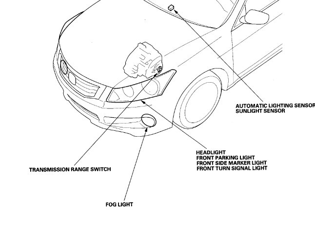

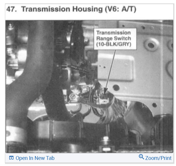

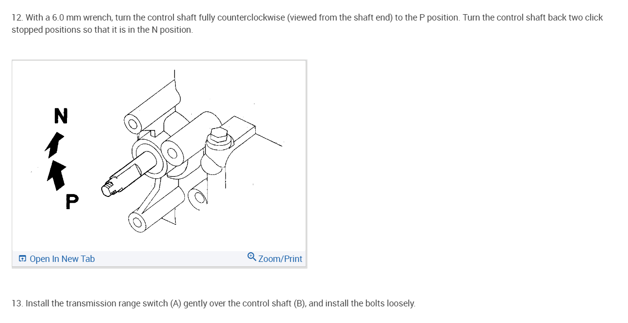

Where is the reverse light switch located?
2008 HONDA ACCORD
123,000 MILES • 3.5L • 6 CYL • 2WD • AUTOMATIC
DLG4339

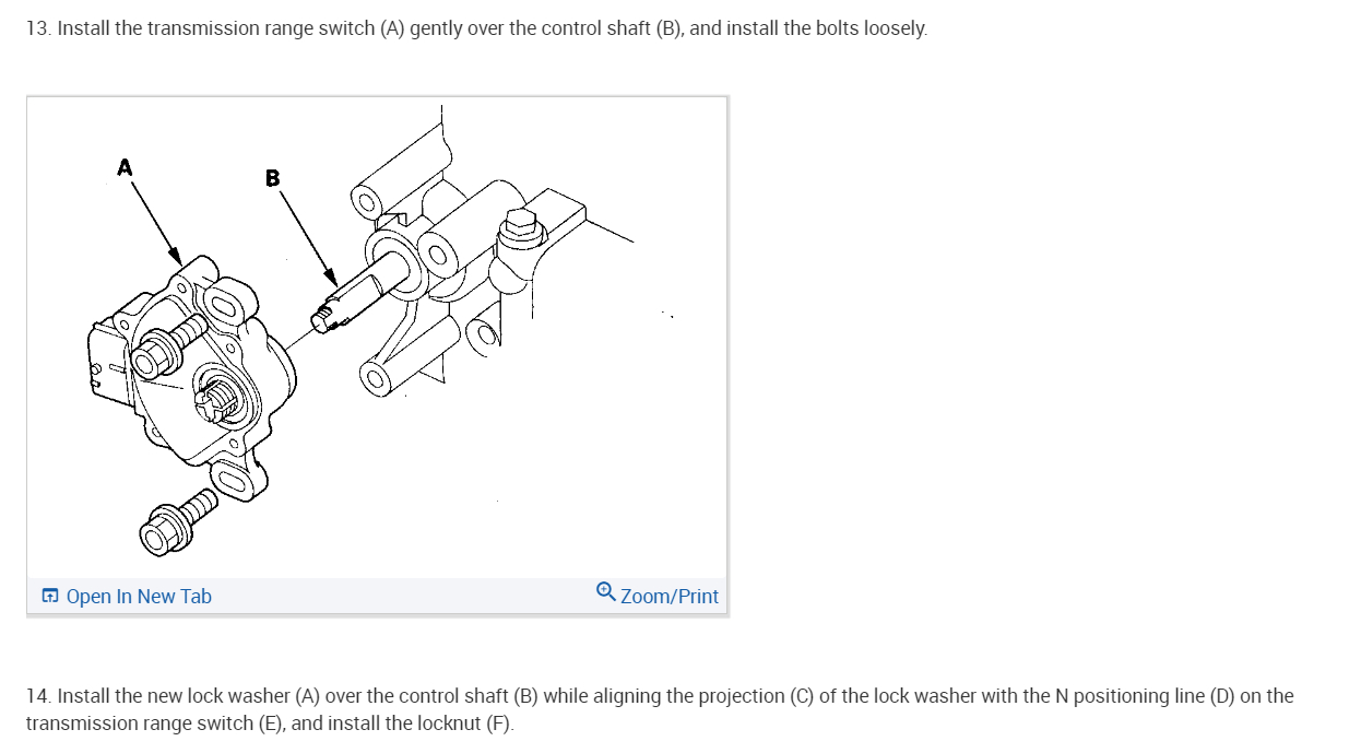

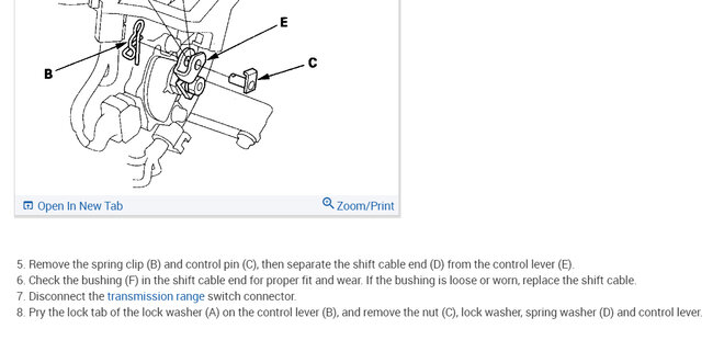

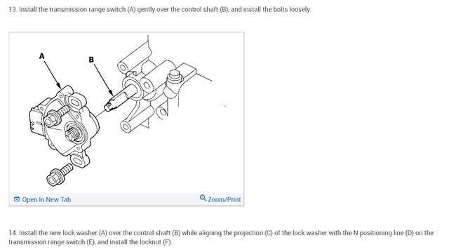

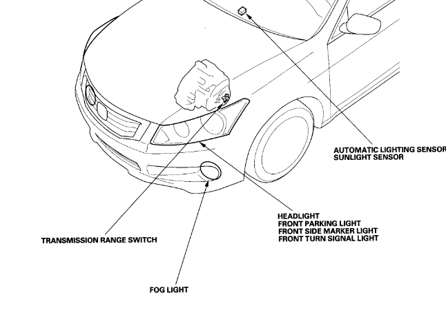

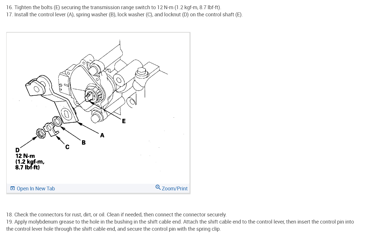

Reverse light switch location.
Jun 16, 2023 at 4:16 AM
  • 55,433 POSTS

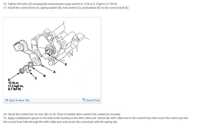

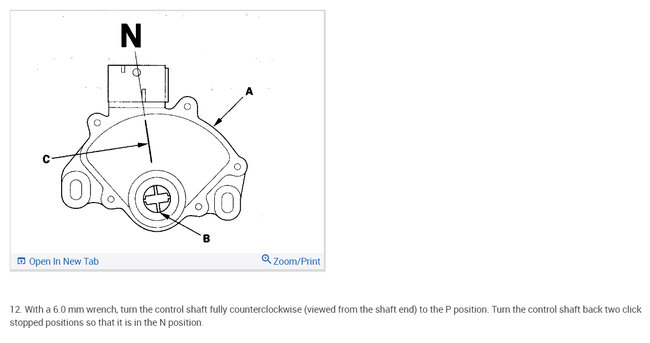

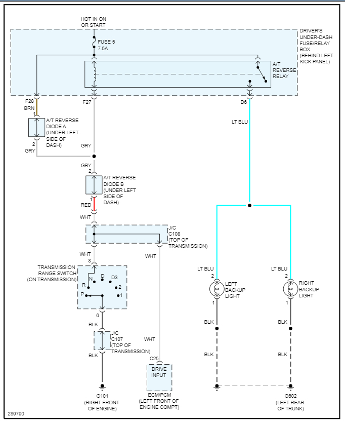

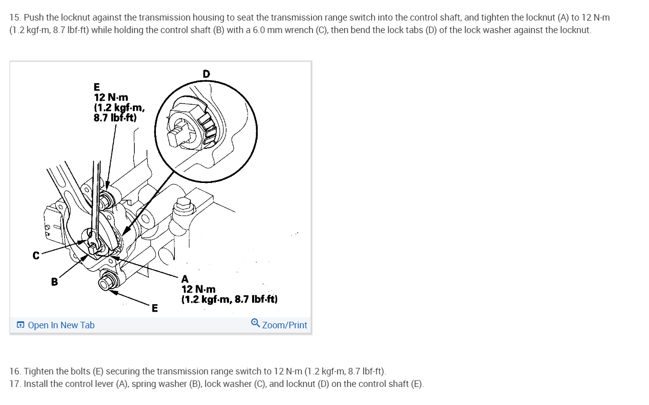

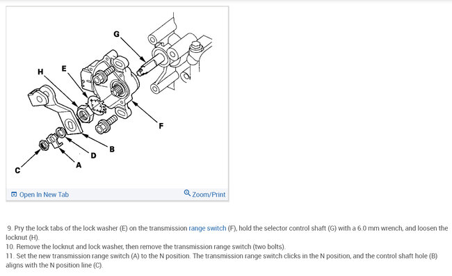

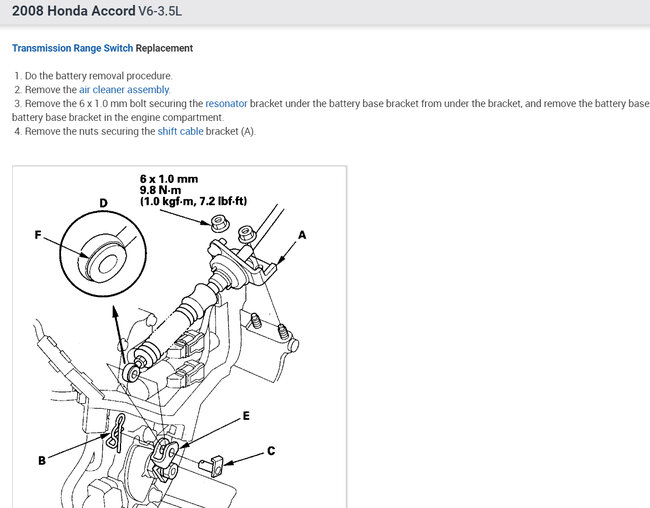

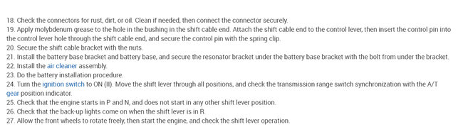

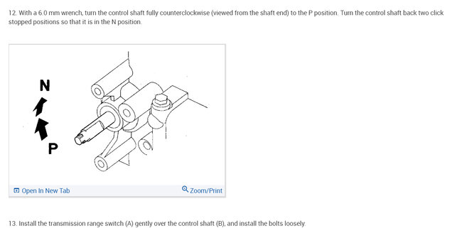

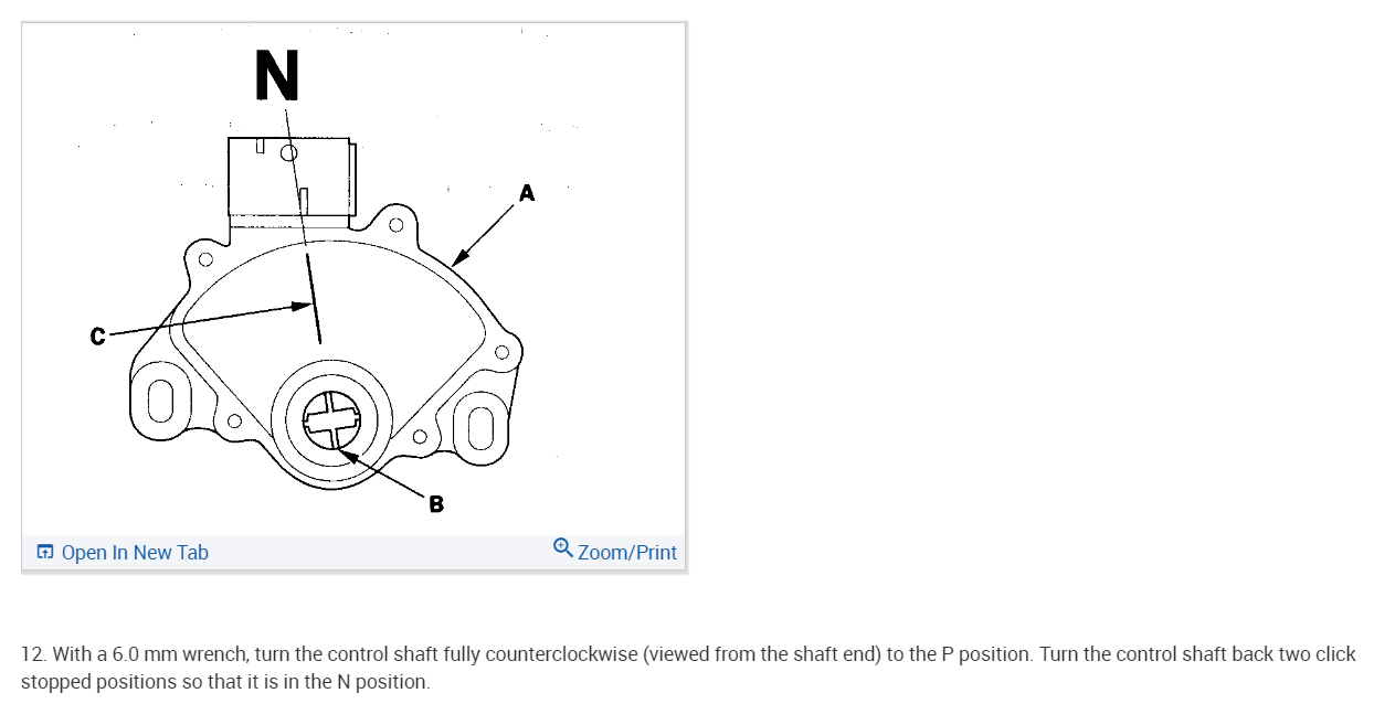

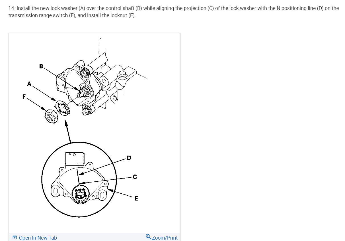

The reverse light switch is located on the transmission as part of the gear range sensor/switch. Here are the wiring diagrams for the system and the sensor/switch location in the images below. Please let us know if you need anything else to get the problem fixed.
