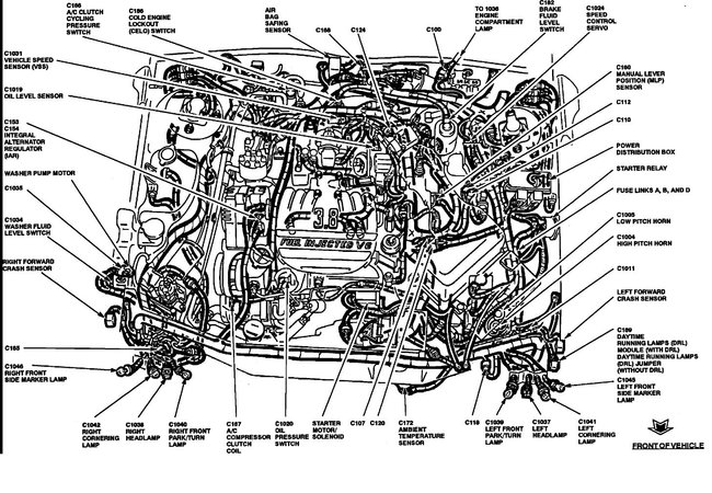

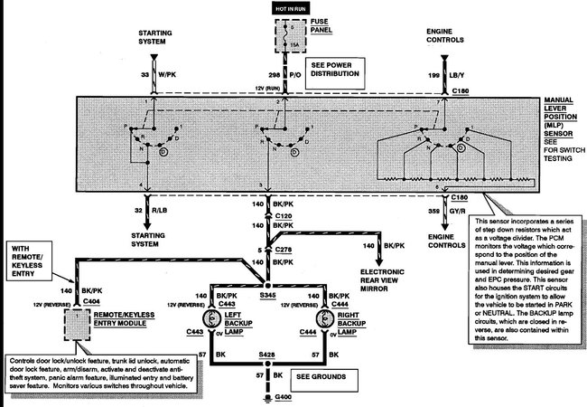

Where is the reverse lights switch located? Reverse lights are not working and I cannot find the switch. Wiring diagram will help showing the location and the wiring needed.

It is listed as "on the left side of the transmission". Check out the diagrams (Below). Please let us know if you need anything else to get the problem fixed.
