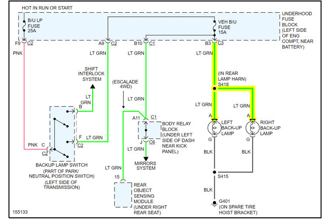

I replaced my reverse lights and the one passenger side reverse light still doesn't work. Could it be the junction box or something else?
Aug 17, 2021 at 12:05 AM
Good morning,

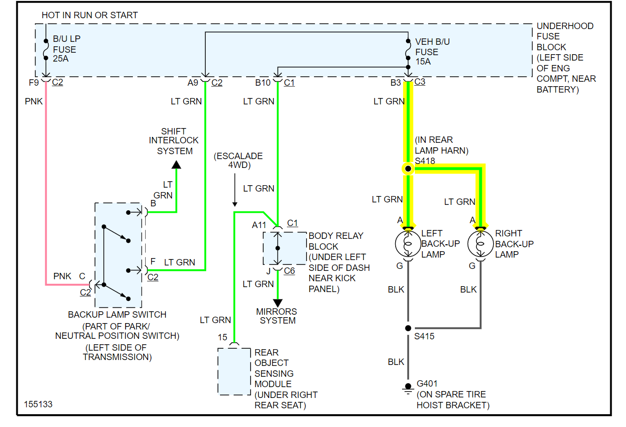

You need to test the light green wire for power with the lights activated. If you have power on one side, let us verify power to the other side as well first.
