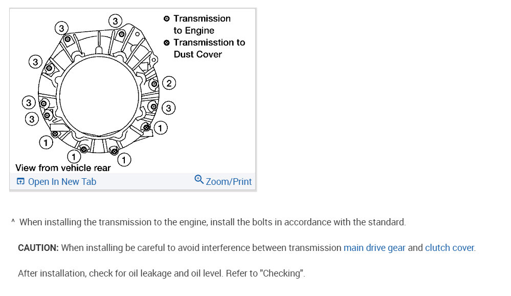

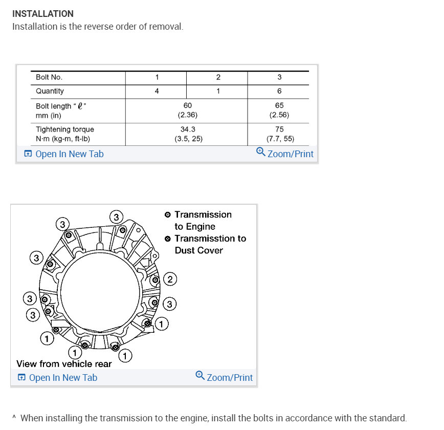

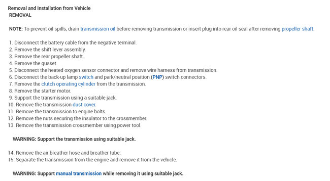

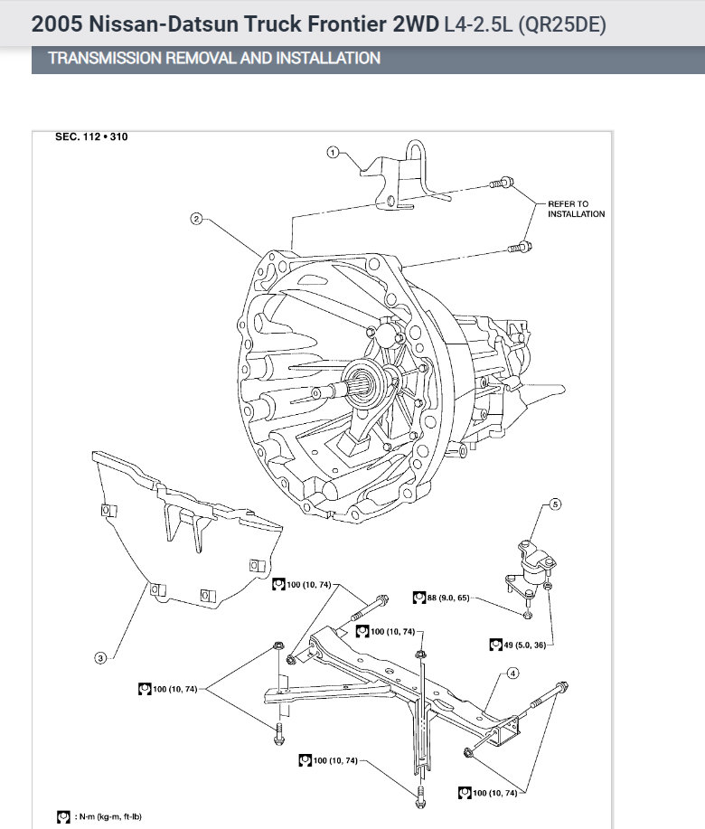

The transmission has a bearing that is out which allows the gears to be misaligned which causes the reverse gear to pop out. The transmission will need to be removed and rebuilt. Here are the instructions in the diagrams below allow with a generic guide to help you see what you are in for when removing the transmission. You should install a new clutch once you have the transmission out.
https://www.2carpros.com/articles/transmission-replacement-removal-manual
and
https://www.2carpros.com/articles/how-to-replace-a-clutch
