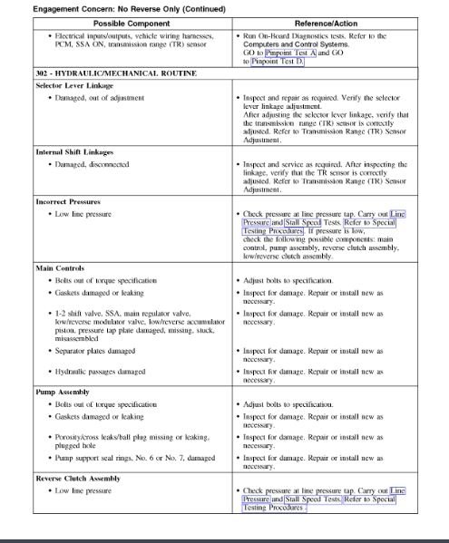

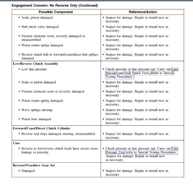

Won’t go into reverse revs like it’s in neutral?
May 26, 2020 at 8:59 AM
Experienced Mechanic
52,796 POSTS
Good morning,
This sounds like an internal issue in the transmission as the reverse is totally mechanical and no electronics are involved.
I attached the flow chart for you but all indications are pointing at an internal failure. This will require removal of the transmission and either rebuilding or replacing.
